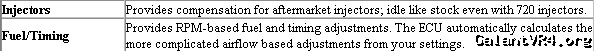

seems like dsmlink is just a program for logging parameters, not an actual engine management system that replaces the ecu, just works with it.
This right here tells you it does more than just log.

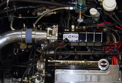

As sad as this picture is for Harry, I am sure that it brings joy to #3's new owner. I could not help but think this picture is a "changing of the guards".
