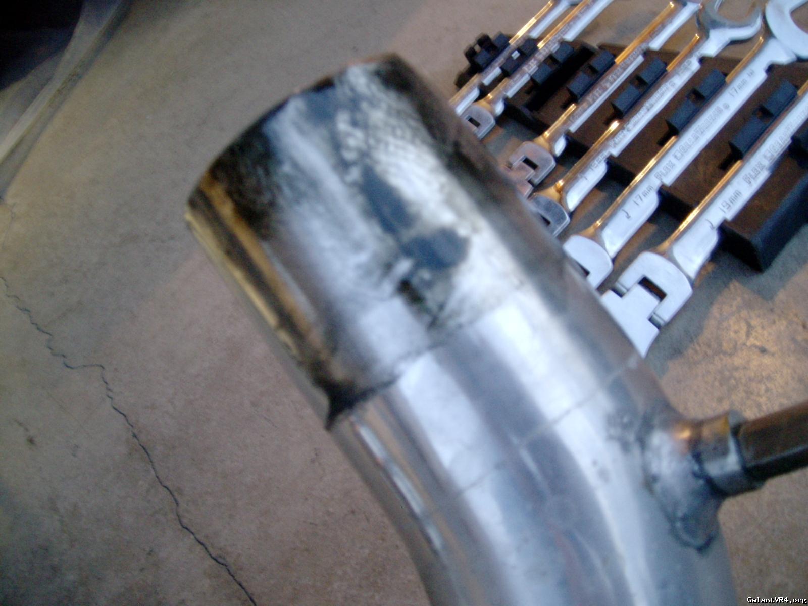

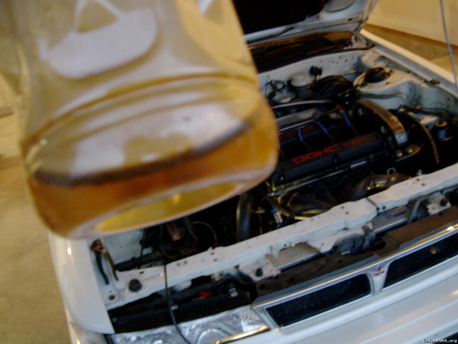

While removing my IC piping today and catch can to test fit the new setup, i found some disturbing things. My IC piping is filled with oil, a little puddle poured out when i took it off by the intercooler and goes all the way up to the Throttle Body. Next while i removed my catch can and heard that it had a liquid in it and when i drained it out, it was all coolant and a tad of oil at the end /ubbthreads/images/graemlins/banghead.gif Im thinking that my headgasket is going around the coolant passages as i still have great compression?

Are you 100% positive the fluid that cam out of the catch can is coolant?

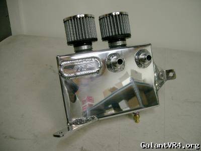

what kind of catch can are you running? Does it have any baffling and/or anything to help the oil vapors condense and drop into the can, instead of going stright back out the outlet? (I'm assuming it's not vented, but recirc'ed back to the intake like stock)
If catch can isn't recirced and/or is a quality can I'd suspect turbo oil seals leaking.

If there isn't a doubt about coolant in the catch can then yeah, sounds like HG to me. Coolant does have a pretty distinctive look and smell.

Quoting Muskrat:
Its a custom can built by JMF. It does have baffling inside. here is a picture
