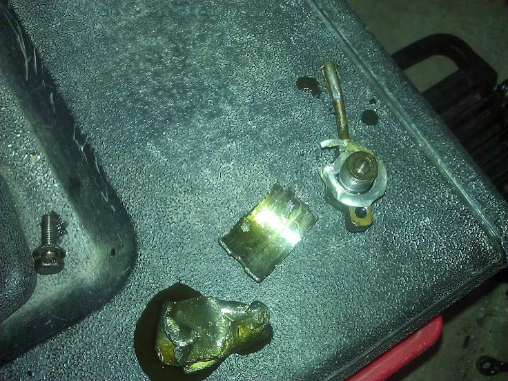

My parts from Rockauto got here today, so I started throwing the car back together. As I was installing the front balance shaft belt, something just didn't feel right. I grabbed the gear, and the whole shaft just felt loose. I decided to pull the pan, and see what was going on.
And the hits just keep on coming...
w0ZjIhjDdEXA5UOBuYXRUxGSZWrq_L8UaRk5MoU4vr0=w736-h552-no

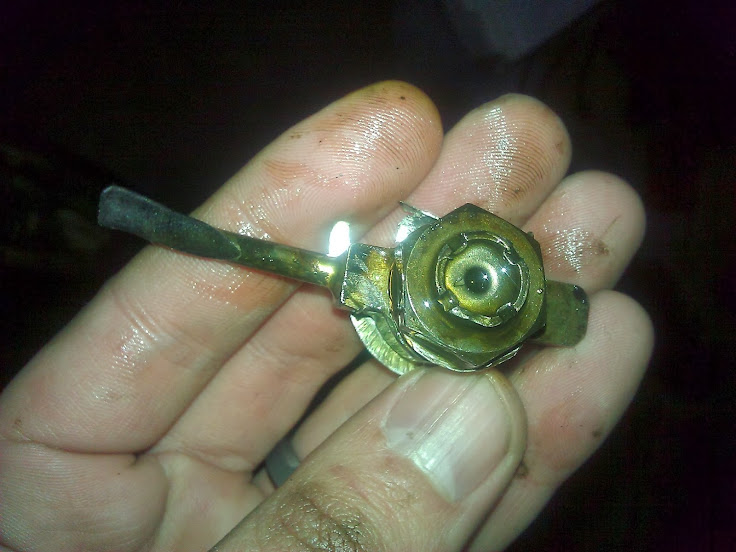

The passenger side balance shaft bearing spun, and was laying in the pan. The balance shaft itself still spun freely. Somehow, the balance shaft bearing took out the oil squirter on cylinder #3. It was still in place in the condition shown in the photo. It looks like the bearing dropped out, and the crank throw smashed it into the oil squirter. The crank and throw look fine though. It's hard to believe the car was running absolutely prefect with all this sh*t wrong.
I'm at a loss. Just don't know what to do. I have no idea how long the car has been like this, or the extent of the damage all the metal caused. So guys, got any advice? Do a BSE and just hope for the best? Junk the motor?

That sucks. Considering the engine has been running like that for a long time, I'd BSE it and see how far she makes it. Normally I leave the front shaft in place, but with that bearing gone, oil pressure is probably low, so a new bearing will need to be installed 180 out to block the oil hole. You're also going to need to get that squirter back in place. I'm not sure if that's possible with the motor still in the car and all together though? What a pain in the ass...
When I did the BSE to my car in '03, I found balance shaft bearing shavings in the pan as well. I luckily caught mine before anything bad happened like your issues though. But whatever metal shavings made it through my engine (if any) have yet to show any issues after years of abuse, if that makes you feel any better.
It's a damn good thing you didn't just install the belt and take the car out for a spin. Who knows what would happen. /ubbthreads/images/graemlins/uhh.gif

Thanks for the advice, Mark. That actually does make me feel a little better. My main concern is the damage the metal did. Aside form doing a complete tear down, I'll never know the full extent.
My next issue is what to do about the front BS. To my knowledge, I can't remove it with the motor in the car, and I definitely can't leave it as is. I don't understand how the motor didn't fry with the loss of oil pressure due to the missing BS bearing. Hard to believe I got that lucky.
At this point, I don't think I have a choice but to pull the motor, and deal with the front BS. If someone has another idea, hit me, because I really don't want to pull the motor right now. Otherwise, I think that's my only course of action.

If you pull the engine. pull the rod and mains check the bearings. I would also pull the cam caps and make sure no contaminants are on the cam and ground into the caps. i would also try to back flush the turbo and all oil ports. any alan plugs you can remove and clean out the better. then before you put the timing belt on run the pump and prime the engine. perfect world i would recomend taking the entire engine down and full deep clean.

i have pulled them in the car, take all the cross members and motor mounts but the pass tranny mount out and lower the motor on a jack. it should just clear the frame rail with a little bit of work. its a real pain in the ass but you dont have to yank the motor. hardest mount to get is the rear.
