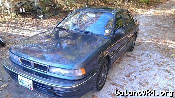

I just got my 91 GVR4 on the road not too long ago. And i am wondering what are some things i can do to it to get me started? I already have a TDO5 16g turbo. New header, and down pipe. So what else should i do?
