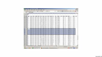

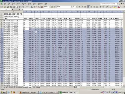

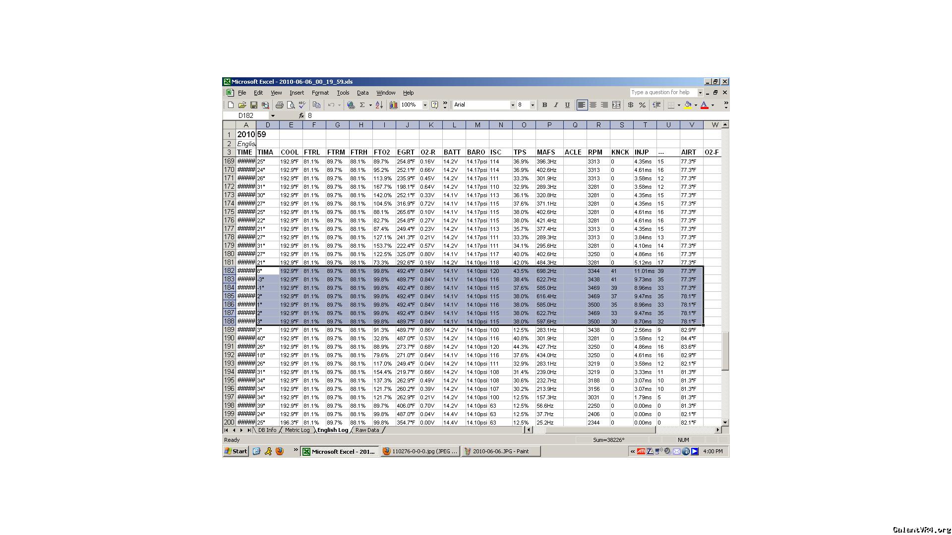

One thing I'm not understanding is, I wired my WB to my ecu so I can log it. It shows up on my logger but its not showing up on the excel speed sheet.
That looks like Phantom Knock. But, your chip has the PK Code, so I'm not sure why you are seeing that. What was the vacuum/boost reading when that happened?
Also, what is with those fueltrims? You are way too rich. Is your base fuel pressure at the stock 37psi? Are you tuning with an AFC?

The boost psi was around 10. Yeah my fuel pressure is set to 37psi. Its hard to see with the gauge being so small but its got to be close. I know those fuel trims are super rich. I just don't know how to get them where they are supposed to be. And no I don't have a SAFC. I really have no way to tune. I have your eprom chip Jeff, and a FPR but thats really about it.
You need to keep dropping the base fuel pressure until the trims stay closer to 100.
At 10psi the PK code is not active. Is this just a random thing, or can you make it knock every time?

Have you tried logging while doing 35mph in 4th, particularly the O2 voltage, to see if it stops cycling? I'm thinking what you are actually feeling in the PK, and the timing being pulled.
Very strange, everything looks good except the O2 volts drop to zero. /ubbthreads/images/graemlins/dunno.gif
You aren't getting any CEL codes? It would seem to indicate an injector/fuel issue, as you said. The PW and Hz look great, but the O2 sensor isn't indicating that there is enough fuel. Do you have any way to watch the fuel pressure while driving? Do you have an AFC?
