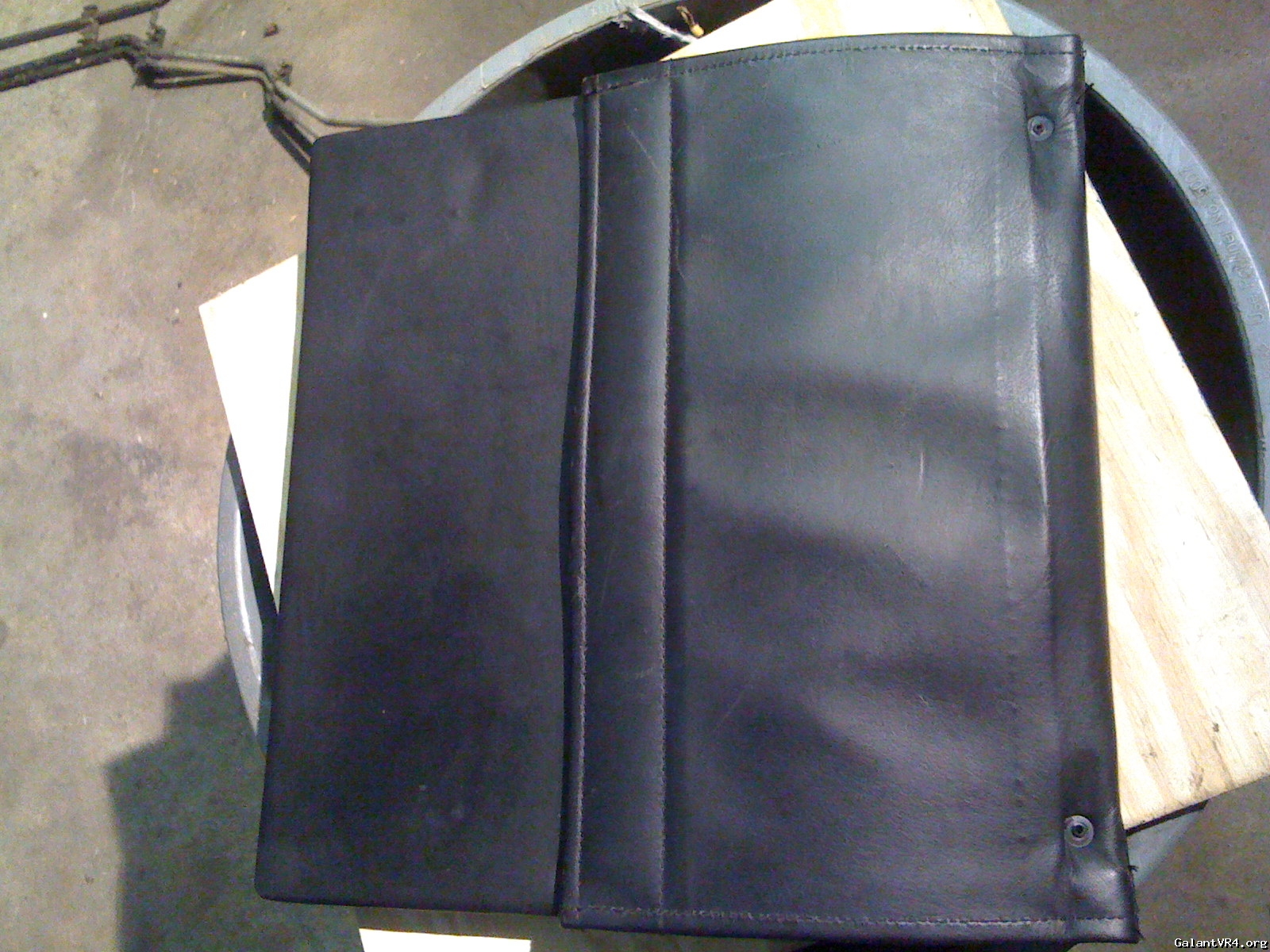

Taking apart these seats, I figured maybe somebody could use a little info.
Mine are all good, but maybe someone else has some that kids like to hang their feet on. Should also be the same on non-vr4's /ubbthreads/images/graemlins/dunno.gif

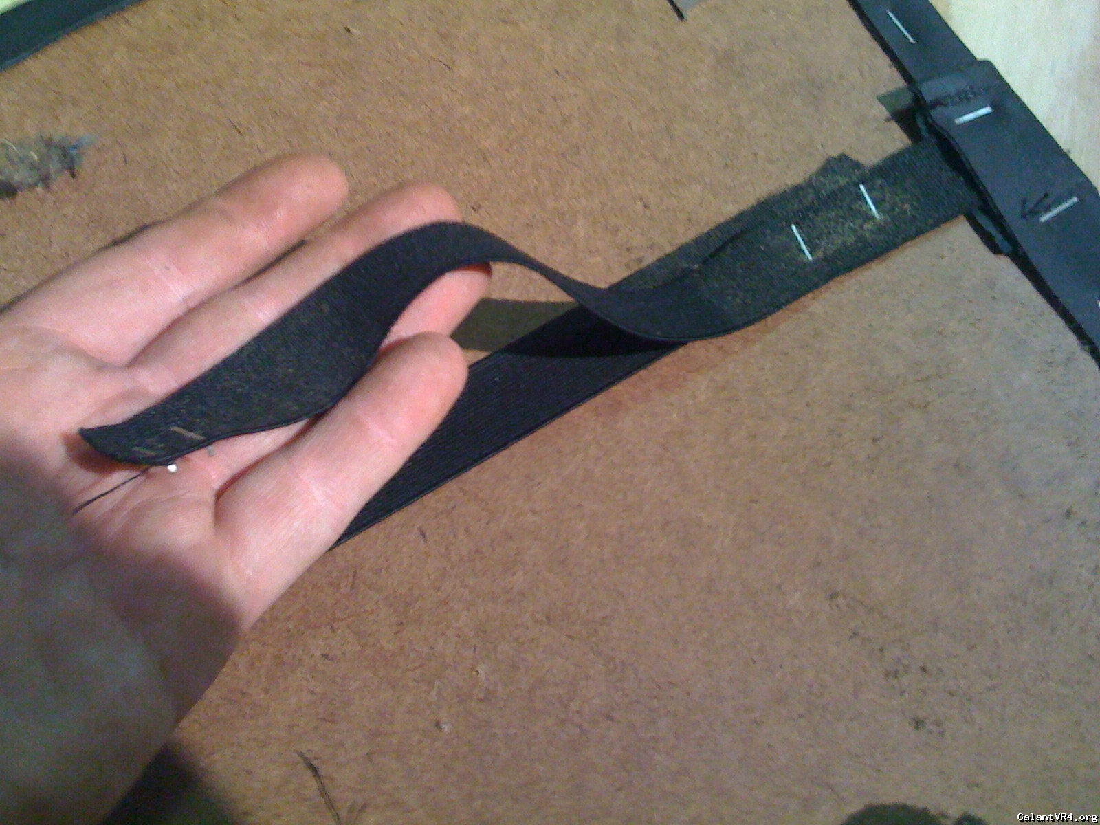

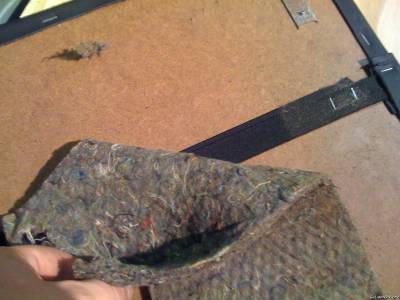

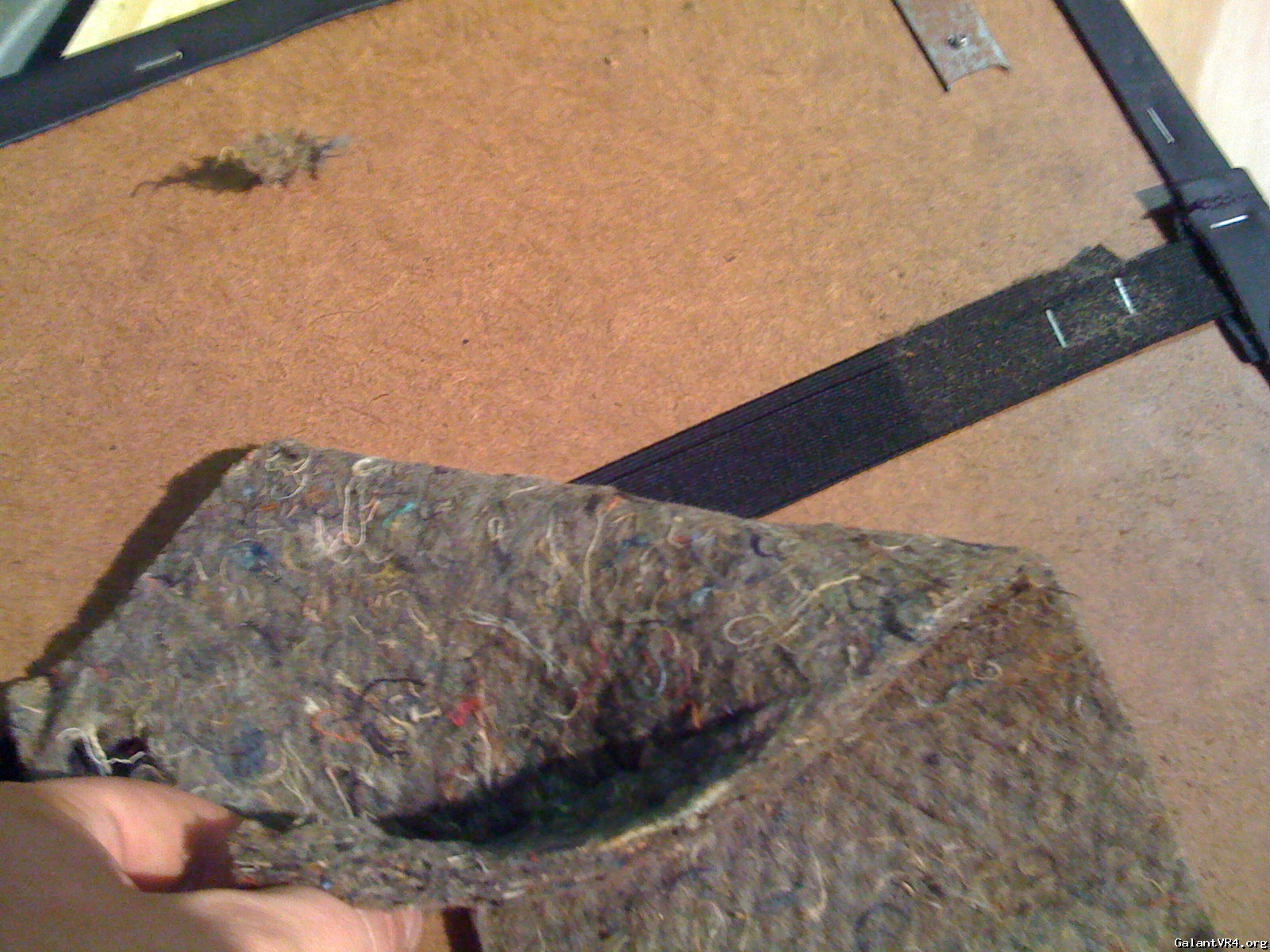

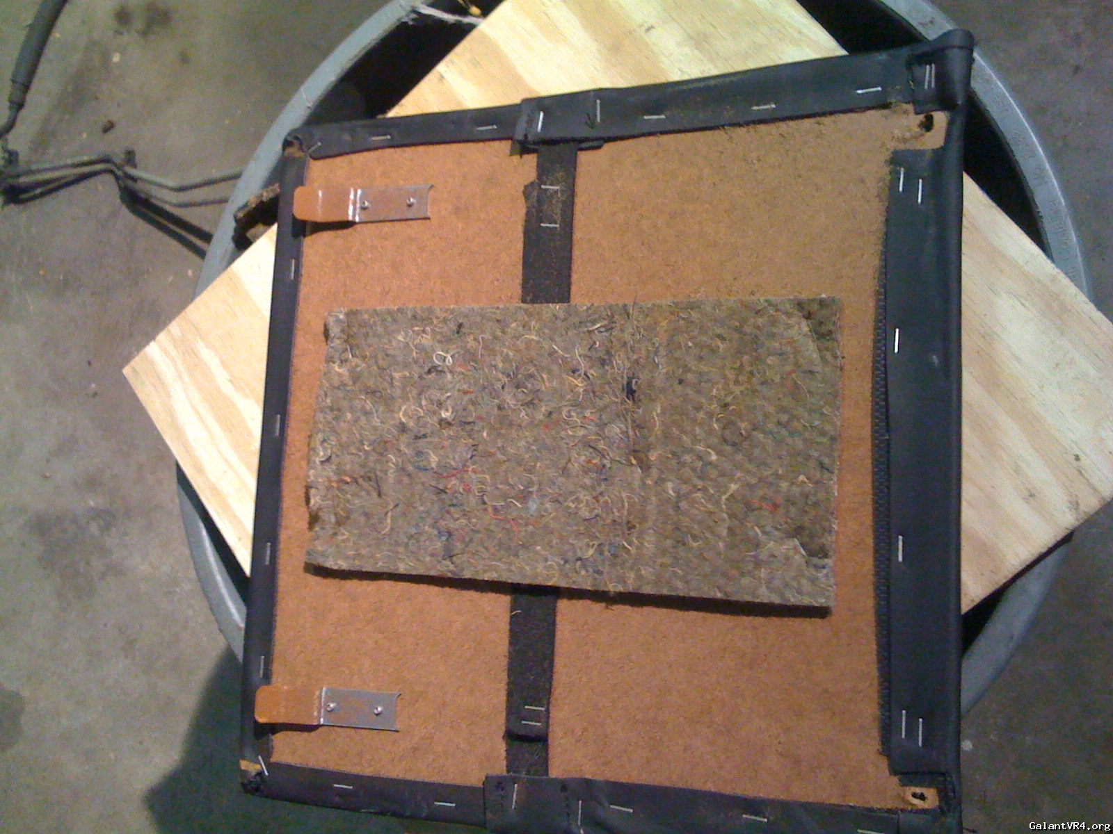

The back panel with the pocket has two screws at the bottom, pull those then the whole panel can come out. Flip it over, and the elastic band is held down with staples. Pull the staples, pull the band tighter and restaple. That ought to tighten up some loose pockets. You could probably even replace the band pretty easily too if it's too far gone.
/ubbthreads/images/graemlins/grin.gif cant tell you how much i appreciate that. I am re-doing my interior (kinda) and both my seats are in good condition except for the pockets. And i wouldn't have thought to take it apart like that. Thanks again!
