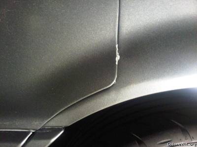

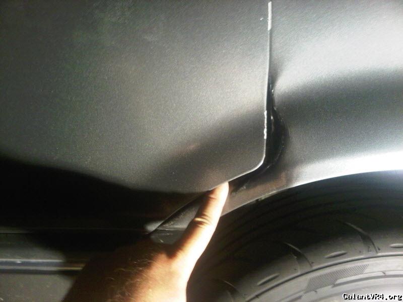

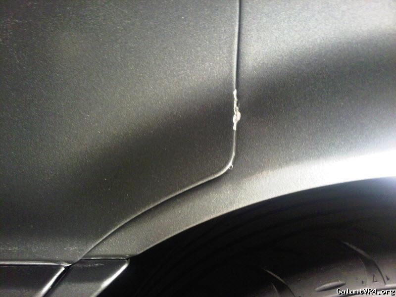

Here's something painful to look at. Since the Level III inspection checks to make sure all the doors open/close without interference, and I ran into some interference due to the way the rear quarter panel was shoved into the rear door on the driver's side, I had no choice but to clearance things last night.
A picture is worth a thousand words. Most of them "f***."
Before: Rear quarter contact with rear door, driver side. Opened or closed just right and the driver front door would be stuck. This would not pass the Level III inspection.
The right way to fix this would be to strip the shell down, bolt it to a rack, and let professionals burn through about $1500 or more of labor pulling the unibody back into alignment. This might straighten things out, but it leaves pre-stressed material of questionable integrity for the long term, and the car would STILL have to be sold as a restored SALVAGE vehicle. On paper, this Galant is garbage.

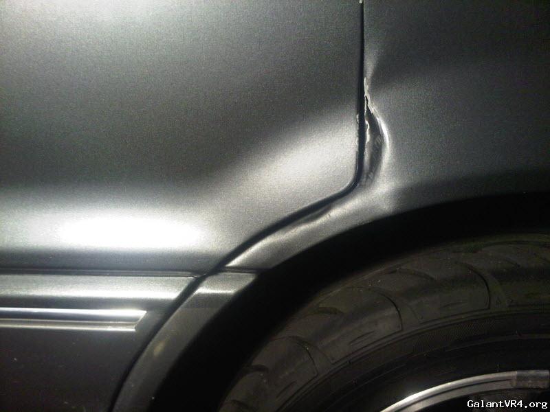

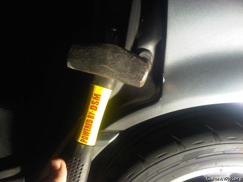

Much like it is with the Sawzall, if a little hammer works okay, more hammer works better.
Now all four doors open and close cleanly and without snag or catch or any other drama.
Oh yeah. It was all I could do to keep from throwing up as I was doing this. I mean, all the complex curves in that location? I pretty much irrevocably fucked the quarter panel doing this. Makes me sick. :shudder
Oh well. Gotta do whatcha gotta do. My dreams of one day restoring 464 to better than new condition just went out the window. She's spare parts for the rally car now. Spare parts that I daily drive.
