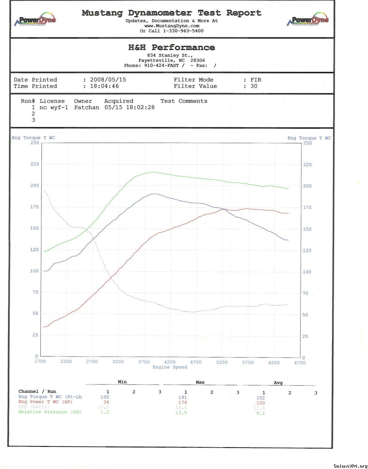

My Dyno sheet may give you a baseline as 183 has no modifications less the BCS restrictor removed. Full weight with 88K on the clock. I pulled:
174 (WHP)
191 (Ft lb)
14.4 (AFR)
13.5 (Boost)
*The Dyno operator was an idiot so ignore the "MIN" and "AVG."
