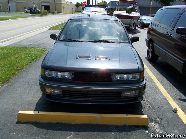

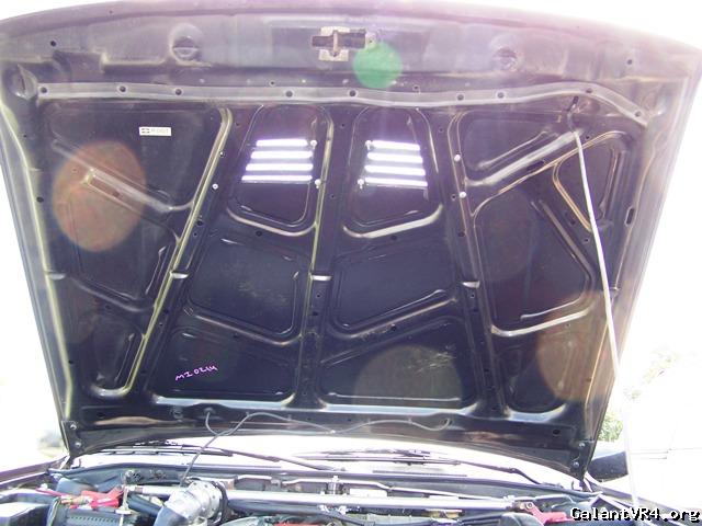

Goal was 400 @ the wheels. The turbo can make ~550 but my goal was way less than that. I finally turned up the boost from the sissy 10psi I've been running for 2 years now to 20psi. I also installed a pair of hood vents. I should have kept one of those jdm vented hoods I sold over the years /ubbthreads/images/graemlins/crazy.gif

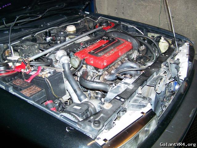

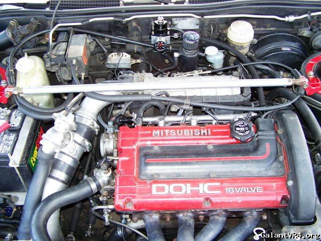

Mod list:
Completely stock jdm long block ~80k miles on it
Stock intake manifold
SAFC
Evo 8 MAS
DSMCHIPS.com stage 3 chipped for E85 with more aggressive timing **What a difference**
E85
25g turbo T3 flange with a huge back housing. It's been so long I forgot. Old school turbo but rock solid.
880cc Injectors which we switch out for 1000cc
Walbro 255 pump intank
Upgraded -6AN fuel line from the filter to the rail & then to the return line
ETS fmic with custom piping 2.5" in & 3" out
Oooold school HKS ssq bov works great
40mm Wastegate
Tubilar Exhasut Manifold
3" Exhaust
ACT 2600 w/sprung street disc
Civic Radiator
20psi

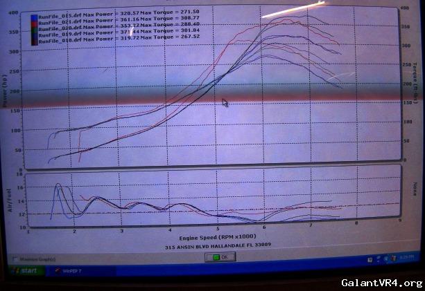

Final #s 361hp & 308tq @ 20psi. We got as high as 371 hp @ 22psi but was running out of injectors in the higher RPM's so we turned the boost back down. It obviously has more in it as the turbo isn't anywhere near maxed out. Just need bigger injectors. I think I'm going to switch back to 93 octane as I could have made 400 with more boost & still have room for more fuel. This is my daily driver & over the last week since switching to E85, I've filled up 3 times compared to 2 times on 93 octane. I don't think it's worth it unless you're shooting for more than 450 whp.
