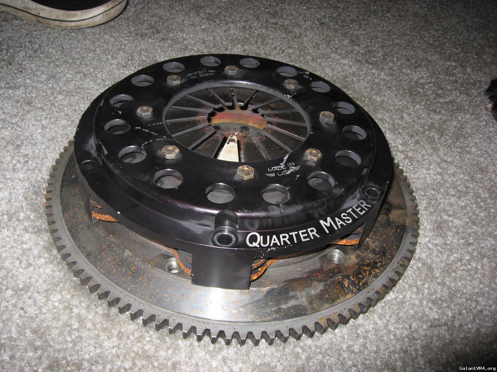

Just got my QuarterMaster Twin Disk.
The people at MA Perfomance hooked it up. They got it shipped out me fast as hell.
Here are the pics.

Check check and recheck everything before you install. If the engine isn't fresh drop the crank and install a new thrust. I didn't and it cost me two new disks and the car being down forever. With the trans removed all you lack is the oil pan rear seal and main caps.....you don't have to completely remove the crank to change the bearings.
Ways to tell if the thrust is worn
-to many years of act2600's etc
-you get a clunk cluck when you touch the gas and let off
-physically inspect by having some one push on the clutch and taking a piece of wood against the front crank pulley and the front frame and pushing on it to check movement.
Use the Isuzu slave cylinder and inspect the release movements and make sure the fork isn't touching the pressure plate top bolts.
Also inspect and check the pedal assembly for any play.
Than after install inspect once a week and make sure you don't have any play in the system.
As for driving call autozone and make sure they have both front axles in stock (lifetime warranty /ubbthreads/images/graemlins/grin.gif)and start looking for a 4 bolt rear. I broke the drivers front axle when the clutch had 16 miles on it and then a rear drivers and diff at about 100 miles. These things don't play if your engine is putting out 300 ft lbs of torque 300 is hitting the ground violently. /ubbthreads/images/graemlins/devil.gif

A mate has recently put one of these in his R32 GTR - did yours come with the bolts to hold the whole shebang together? his didn't.
It's um, interesting to drive with (much to the amusement of the local McDonalds drive-thru staff)
Using that slave on a QM is causing some engagement poblems. You can just stick with a stock one. Thats what I have been using for two years now.
As for driving call autozone and make sure they have both front axles in stock (lifetime warranty )and start looking for a 4 bolt rear. I broke the drivers front axle when the clutch had 16 miles on it and then a rear drivers and diff at about 100 miles. These things don't play if your engine is putting out 300 ft lbs of torque 300 is hitting the ground violently.
There is somthing else going on if you are taking out that many things. Only thing I have broken with my QM and welded CD is ujoints and one rear axle from wheel hop.
So once the teeth finally get stripped off the trans I will get that built
You would be better to build it now before it brakes. I stripped all the teeth off my 1st gear 3 years ago. It then took out the intermediate shaft. I got lucky because most of the time the teeth will get tossed into the CD and then shot out the bottom of the case.
Mine came with all the hardware, however it looks like it was not part of the QM Pressure Plate and Disks. It looks like all QM provides is just the PP and Disks, the Flywheel appears to be a Fidanza one, not a MAPerformance specific one, it appears to just be branded as there custom one. The hardware is just some off the shelf grade 8 hardware.
11,993
I haven't broken anything with mine yet, but I also have yet to launch it at the track. /ubbthreads/images/graemlins/hsugh.gif
Don't forget you'll need to grind the fork to clear the bolt heads on the clutch cover.

Quoting TheBoz:
The flywheel from Quartermaster is actually the flywheel made by Steve at PTT, He was the head engineer there before he went out on his own and now sells the flywheel to them.
His may be a newer on with the recessed bolts so you don't have to grind the clutch fork
11,993
Those bolt heads don't look recessed to me, Brian. /ubbthreads/images/graemlins/smile.gif
Its hard to tell from in that pic if they are or not. The new onces are not recessed that much.
