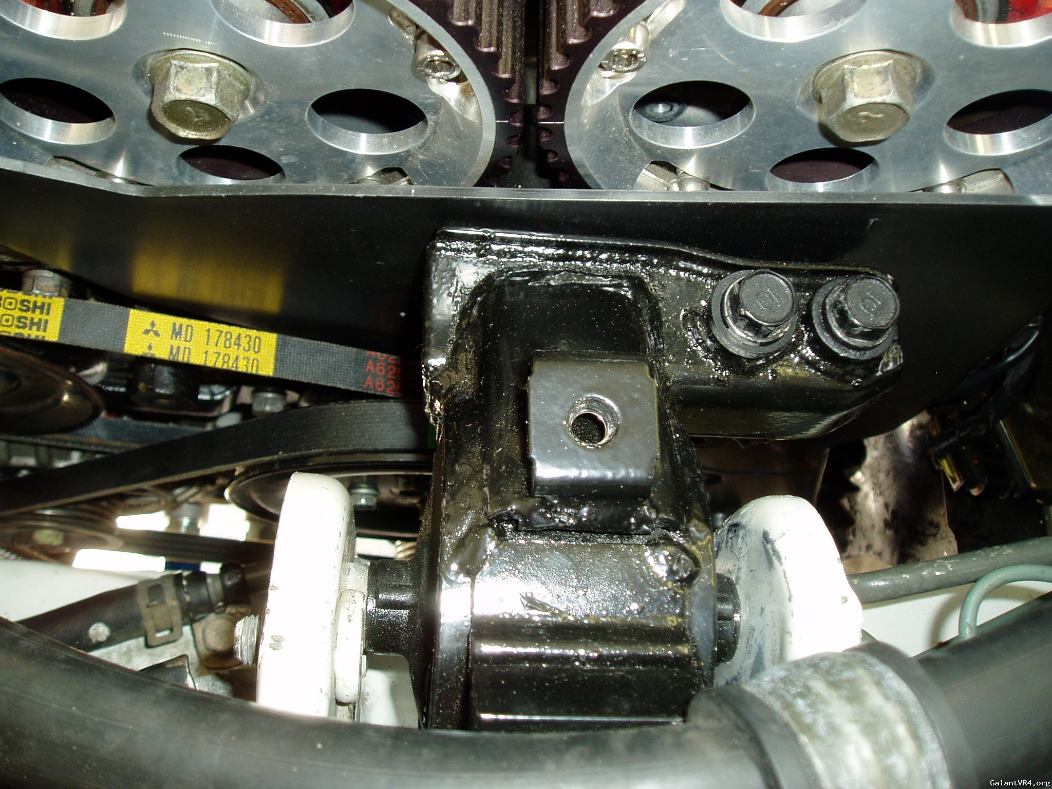

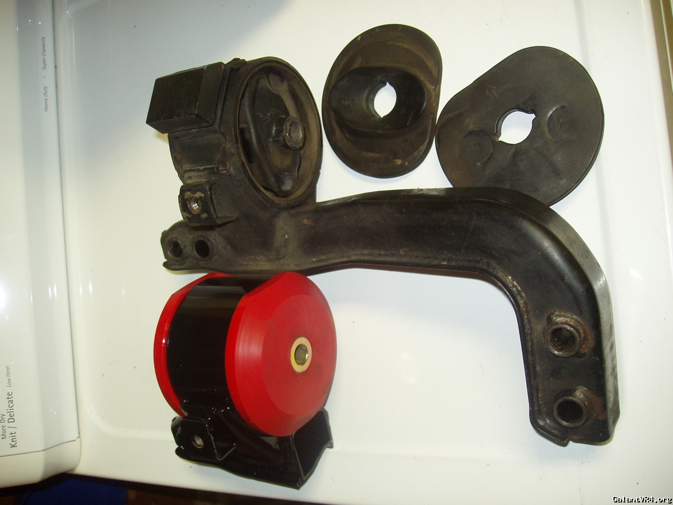

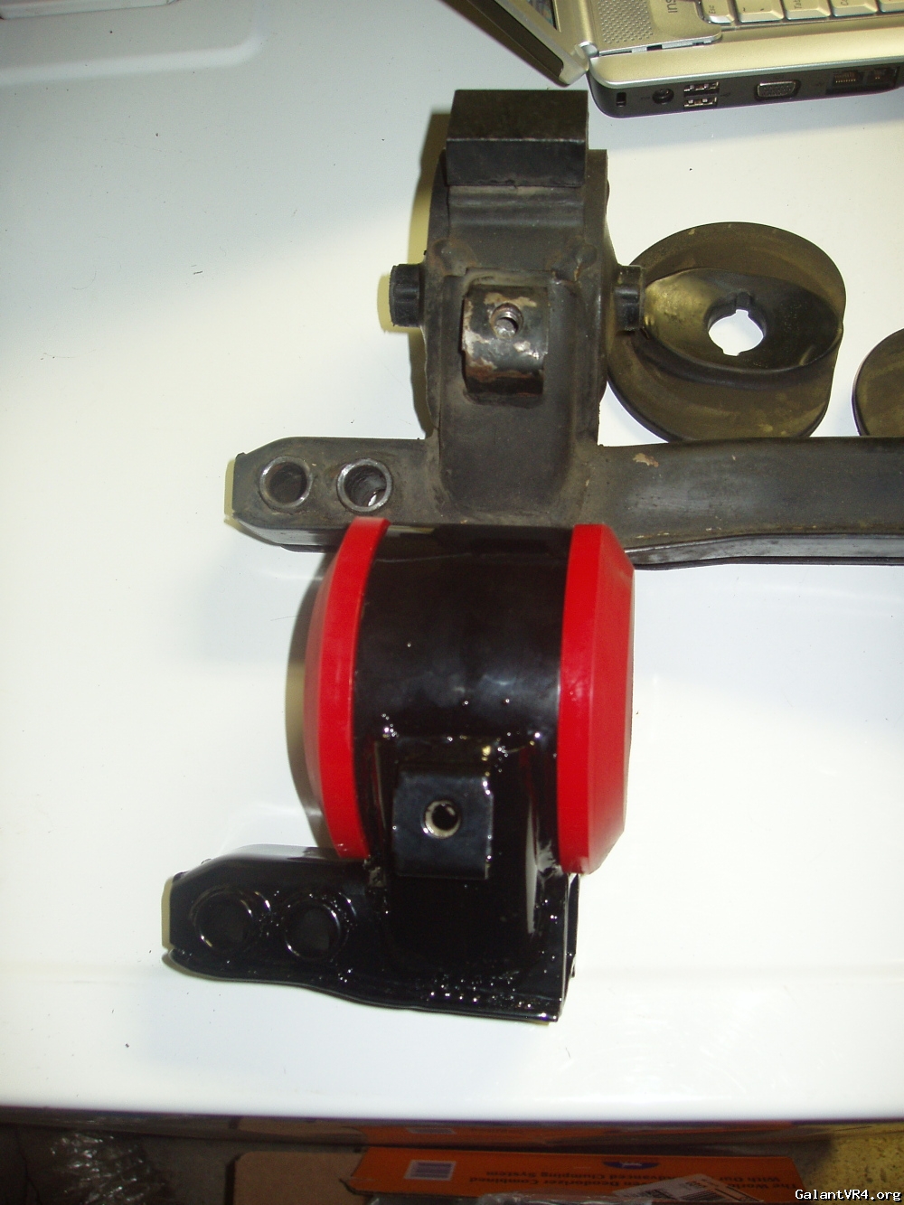

Okay, I just got the drivers side motor mount from JNZ with a new bushing, and its different than stock. And maybe this is intentional, I dont know. the stock mount has the arm that extends to the front of the engine bay and attaches with 2 studs, then at the back with 2 bolts. The one they sent has the front attach point cut off at the bushing. I figure they do this because the extra isnt needed with the Prothane bushing, but I figure I should ask. Will just the 2 bolts be enough to support the motor?

Both the DSM and Galant mount are 'L' shaped from the factory. They cut that part off to save a bit of weight, clean up the engine bay, and because it's really not necessary. Lots of people "modify" the mount like that. Mine is like that and it's just fine. I would just install it the way they have it. I also cut off the portion with the 2 studs just above where the power steering mounts up. It'll save you about 2lbs and give you better traction for the hole shot.

I cut mine the same as Jesse did. The part for the 1G mount probably superceded to the 2G mount as it's my understanding 2G's came stock with the shorter mount.
Chopping off the part where that arm bolts to in the front of the engine also makes exhaust manifold removal easier.

Im running solid bushings as most of us are too so the extra bracket really isnt needed...
