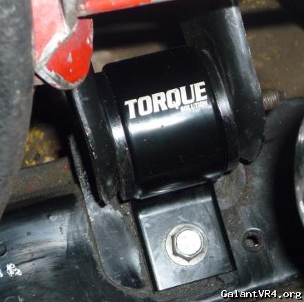

This will help minimize engine movement. This is really crucial especially the guys running an upgraded turbo where the real estate in the front is almost non-existent. This picture is not of my car. I forgot to take a picture of the mount before I installed it. Once it was installed I couldn't see it anymore due my intercooler piping.
EDIT: I forgot to mention that I had to use a longer bolt on the front of the crossmember. The Torque Solution's mount is significantly beefier than the oem unit.
