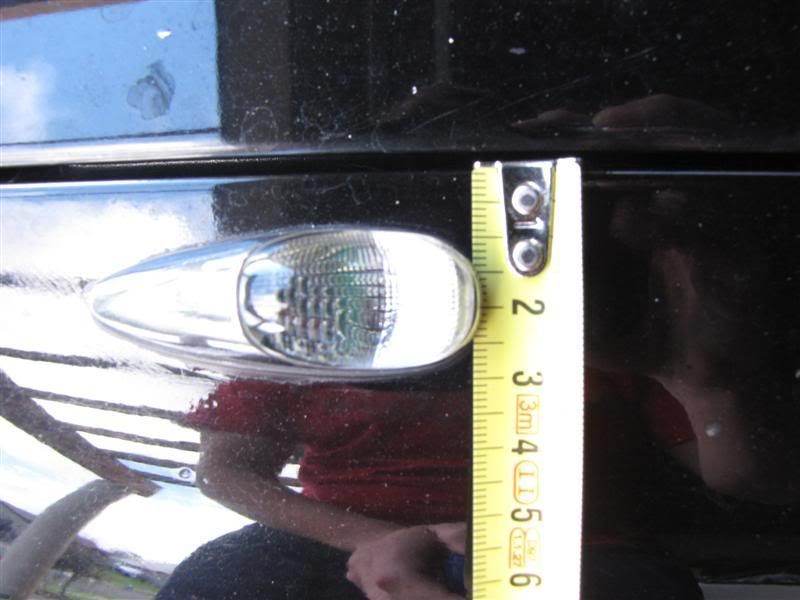

Anyone has a template on the hole in the fender to install jdm light? Or can measure distance from tip of fender to hole & hole to fender edge?

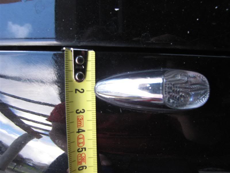

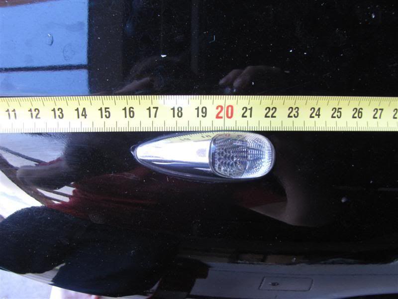

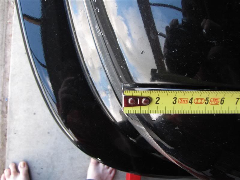

I couldn't figure out a real accurate way to measure how far in from the front of the fender so I just eyed up the beginning of the tape measure to the corner of the fender where it meets the hood like so:
and it gave this measurement:
enjoy the reflecto-porn
