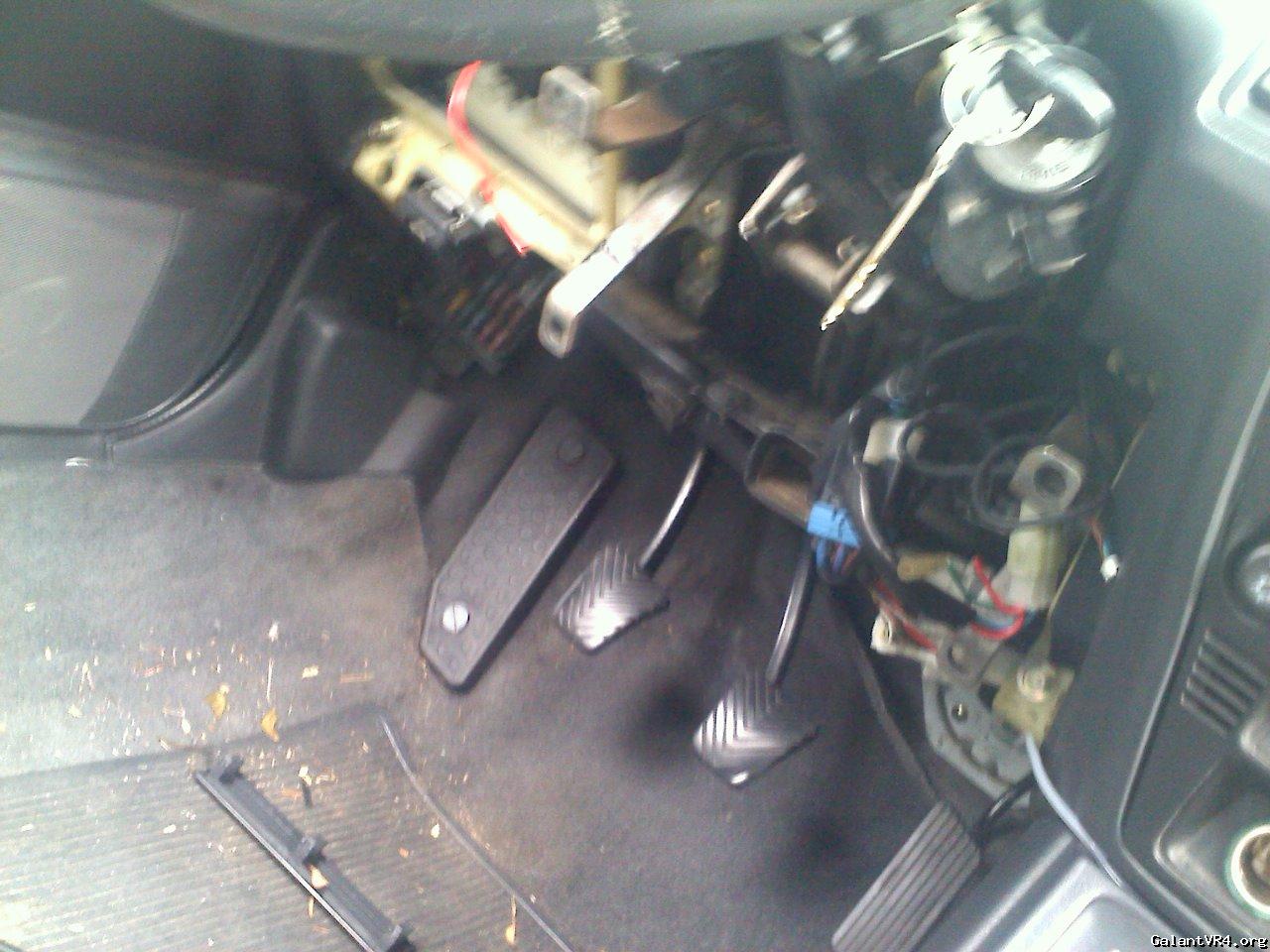

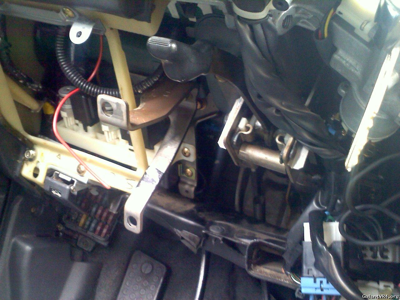

I'd take your car to a shop, it sounds like you are probing around live wires without really knowing where to start honestly. What are you probing with? It sounds like you're using a multimeter since you came up with actual voltage readings. The ignition would be where you would want to tap into, which is the blue plug in your pic. However, as was mentioned above, you're better off getting a turbo timer harness as they are super cheap and you won't hack up the factory wiring. Any wiring diagram for our cars will show which wire is hot when. If you have an aftermarket radio, the yellow wire is constant 12v I believe, and red is switched.
