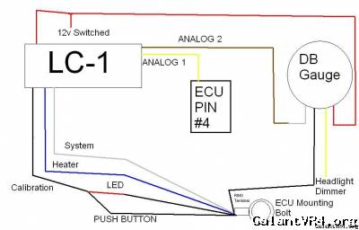

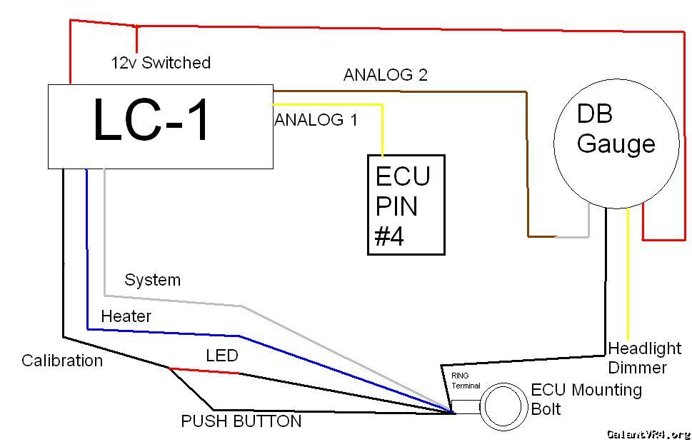

It's easy. Grab a multimeter or testlight to find a 12v switched source. What gauge do you have?
a. Red 12V supply (Ignition harness?)
b. Blue Heater Ground (Solder to a ring terminal and put it on the ecu case mounting bolt)
c. White System Ground (Solder to a ring terminal and put it on the ecu case mounting bolt)
d. Yellow Analog out 1 (Cut wire coming from Pin #4 and solder to it)
e. Brown Analog out 2 (Connect to Gauge analog input)
f. Black Calibration wire (Solder to a ring terminal and put it on the ecu case mounting bolt)

"Connect the RED wire to a switched 12V source in your car. A switched 12V source
goes on as soon as the ignition on the car is on. Make sure the connection is fused with a
minimum fuse size of 5A."
how do i know its fused with a fuse size of 5a?
THATS CONFUSING ME.
also where does the sitch and the led come into play?
and do i follow all connections on the gauges wiring harness to the lc1s wiring harness.
and you made it A LOT easier then this manual does i really appreciate it.
AND i have the blue gauge

It's telling you to put your own inline fuse in. When I did mine I didn't bother with it. It's for extra precaution so you don't fry your sh*t. The switch and LED is for free air calibration. Basically you take a wire from the push button and the red wire from the led and connect them to the black wire of the lc-1. Then take the two remaining wires and solder them to that ring terminal. And yea I would connect the gauge 12v switched to the same source as the lc-1 as well as the gauge ground to the lc-1 ground. Then there should be a blue wire that you connect to the brown wire on the lc-1.

I totally forgot to mention...if you're tuning with v3 I *think* you have to reprogram the analog 2 output to what ecmlink will read using lmprogrammer and then enable narrowband simulation inside of v3.
