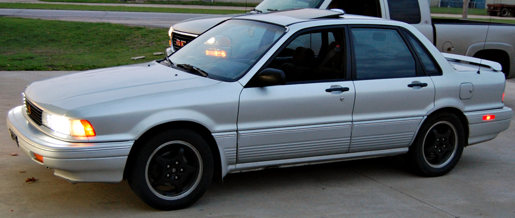

I have 8k hids on my 92 headlights. I would prefer 93 headlights but the are definitely not eye blinding or an annoyance. I've driven behind police cars and never got a warning/ticket, and so far I haven't had anyone flash their highs at me.

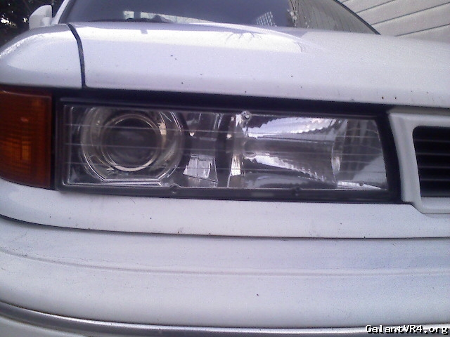

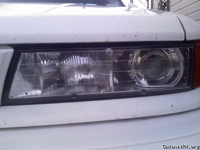

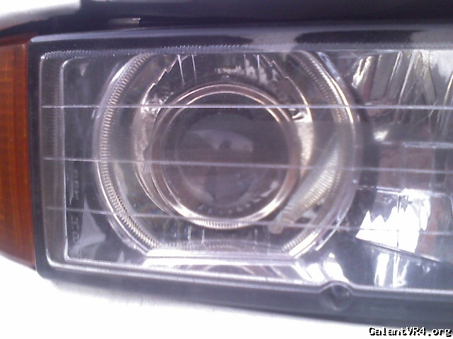

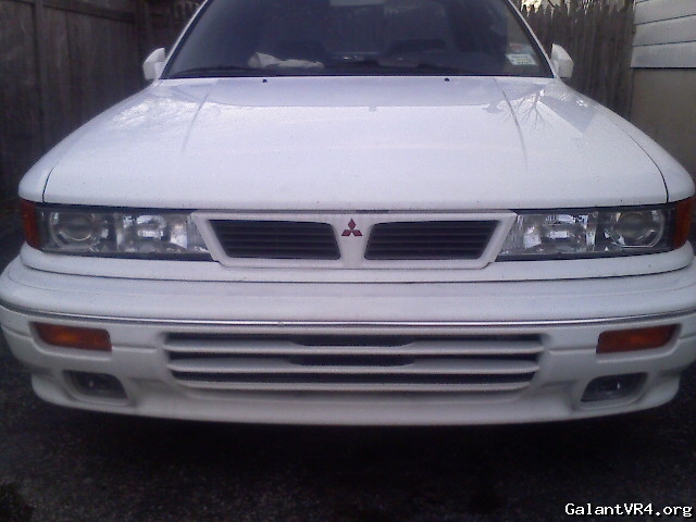

These are the ones that I got from Jeremy (JSchleim18), He basically put together a whole kit - retrofitted TSX projectors (5300k bulbs) in 93' headlights, used with a custom wiring harness made for the Galant and uses Phillips ballists. Supposedly the driver side is a little cock eyed but hopefully I can fix that after I install them. I may take them apart and re-do them to get the angles right but we will see how bad it is when they are installed.
On a side note, we worked out a trade and I don't think he will want to make any future "kits," but I'm sure he can chime in on the details.
