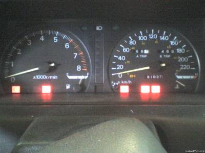

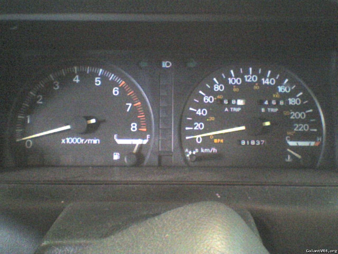

and you said you wanted pics of the instrument panel?
here they are.

I think I just figured out why your tach isn't working. I think the connection is working just fine. If the Check Engine light didn't come on and stay on, that means the ECU is getting a satisfactory tach signal (the ECU uses it (pulses) to determine if a cylinder doesn't fire).
Your new DOHC Ignition Power Transistor outputs GROUND (LOW) pulses for the tach signal. I believe your SOHC tach is looking for a HIGH signal. I'm basing this off of a post I read on here, and on the diagrams.
I saw that you posted a want ad for a 9000RPM tach/guage panel. Make sure it's from a newer model. If it's not too expensive, I suggest going with that. Adapting the tach signal (it can be done) to work with a tach that doesn't display an accurate reading might be more trouble than it's worth.
Beside the fact that the 9000rpm guage would read accurately, the speedometer goes up to 145MPH (230KPH). So if you ever go that fast, you'll know it /ubbthreads/images/graemlins/grin.gif.

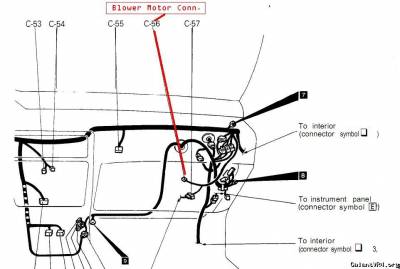

About that blower fan... Did it work before when you used to drive the car? Or is it a recent issue?
The blower relay on these cars goes bad after a while. If yours hasn't been replaced, it's time for it to
Here's a post on where it is: Blower Relay
One way to test it is to kick up in there with your foot (taking care not to break anything) /ubbthreads/images/graemlins/grin.gif. Sometimes that will jolt the relay enough make it turn on.

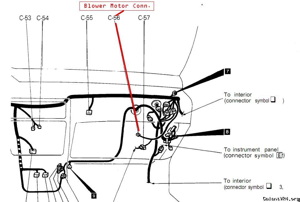

yes the blower did work before, this just hapened after the swap, and the new harness.
btw, are there any wires that are supposed to plug into the blower motor? i couldnt find any socket...

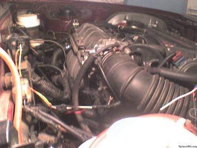

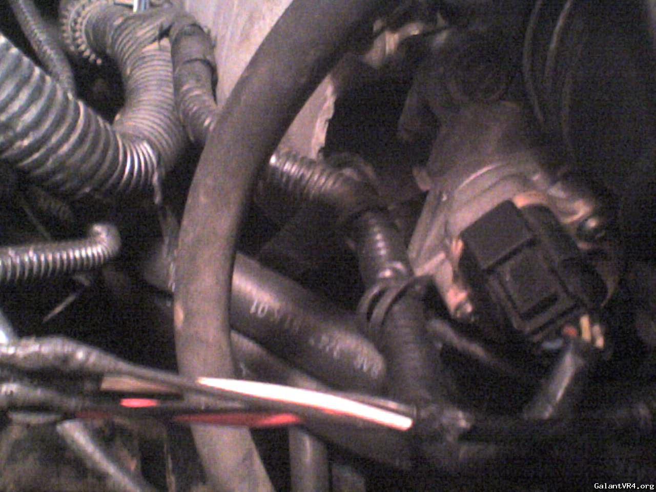

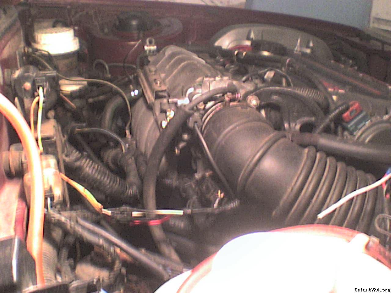

oh, and i just want to know if this is normal... this thing right the here makes loud clicking type noises when the key is in the 'on' position, i dont hear it when the engine is running tho.
it sounds more like... you know when you have air in your water hose, an the water is like making bubbles or something in the hose...or better comparison, it sounds like when you kink the garden hose, and it lets air bubbles thru every once in a while. thats kinda what it sounds like. what is it?
heres a picture that better shows where its located. its right under the intake tube.

That thing making the clicking noise is the ISC (Idle Speed Control) Stepper motor. It regulates airflow when the engine is idling. On that ECU you bought, did the owner say that the Caps had been replaced? If not, that ECU might be a ticking bomb. You might want to pull it out and check it for leaks. Here is a thread about this: Replace your Caps. or your car may EXPLODE.
About the blower motor, there should be a connector coming down in the same area as the others (see pic). Check your old harness for the connector, also.

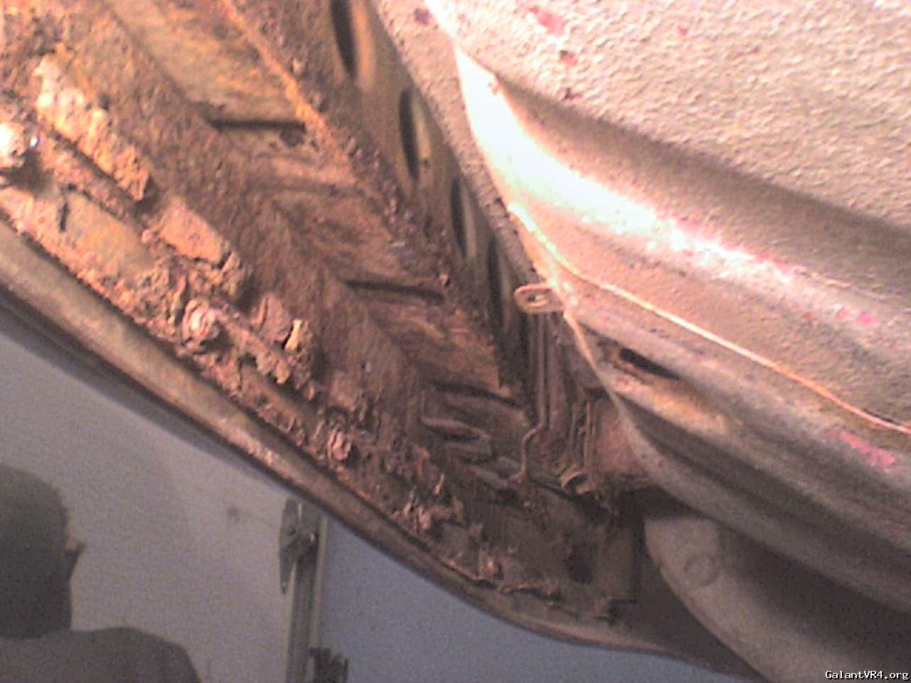

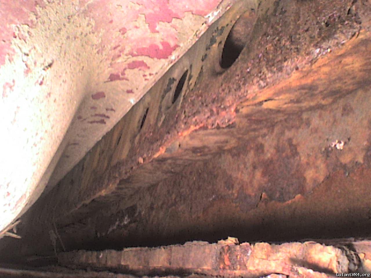

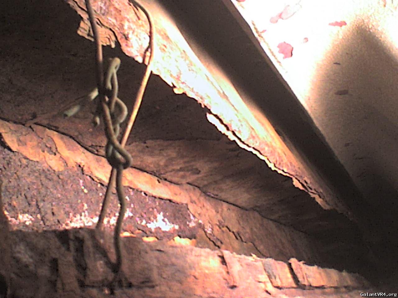

the bumper? yeah, its rotten alright. i had even forgotten about this, because at the time it didnt seem imprtant.
there is nothing holding the bottom of the bumper to the frame except for that wire.
its a whole lot worse than i had thought.
the entire back end of that bumper bar is simply gone.... eaten by the worst enemy known to metal. rust. /ubbthreads/images/graemlins/banghead.gif
i would have to sleeve that entire thing with new metal.
as for the front bumper, there was a spot that i missed, and didnt bother fixing, because i didnt think it was important.
but it is rusted thru.
as for the main body, it still seems fine. that undercoat that was applied 17 years ago realy did wonders.
