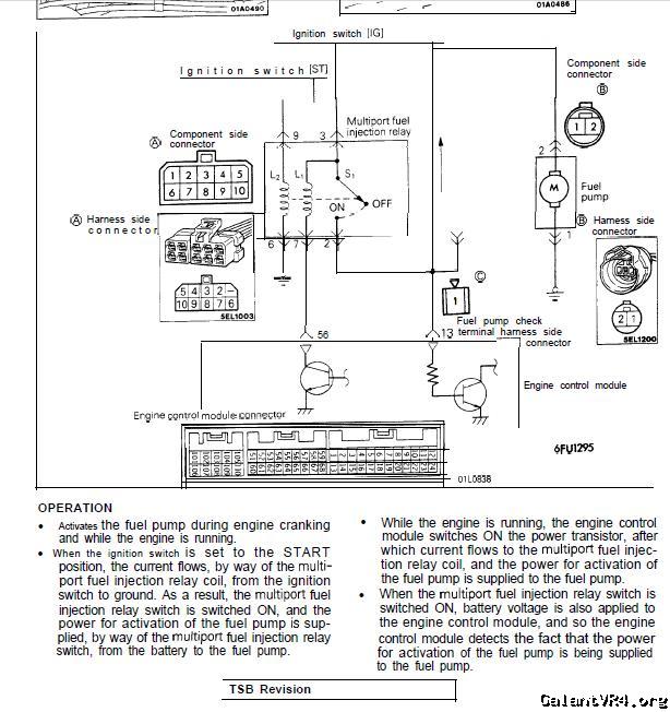

I just went out and turned my key on 1051 to the on position. Fuel pump never kicked on and my fuel pressure gauge didn't move at all. This is news to me if it's supposed to "prime" when you turn the key to the 'on' position. I think even Jeff O. has mentioned in the past that it's not supposed to do this. /ubbthreads/images/graemlins/dunno.gif
*edit* Even in that image from the service manual it says fuel pumps during engine cranking and when the engine is running. It doesn't say anything about priming when the key is switched to the 'on' position. I didn't bother to go over the diagram though, so maybe I'm wrong? /ubbthreads/images/graemlins/crazy.gif
*edit again* /ubbthreads/images/graemlins/hsugh.gif
Okay, so I reread your post and see that you're saying that fuel should pump when the key is set to the 'start' position. Well, if you turn the key to the start position, the cas is going to spin and the pump is going to pump. Why would anybody want to turn the key to the 'start' position without a starter installed anyway? There is still no priming of the system by just turning the key to the 'on' position, which is what I was originally trying to point out.

As has been previously covered, there's multiple coils inside the mfi relay, and two of them both control the same output (for the fuel pump)
It sounds like the ecu(s) are picking up the cas signal and turning the pump on when the engine is rotating. That's good news because it verifies a lot of current paths and control systems.
The other leg that controls the fuel pump is stone cold simple. 12 volts comes down from the key in the start position, flows thru the coil, and then straight to ground. This leg of the mfi relay does not even need the ecu in the car to function and turn on the fuel pump.
The two wires that would be the most interesting to check are both easily found at the mfi relay.
The black/yellow wire is the 12v start signal. Anytime the key is in the start position, there should be 12volts present on this wire. (terminal 9 of the mfi relay)
The black wire is the ground circuit for this coil. (terminal 6 of the mfi relay) It should read ground potential all the time. This should show very little resistance, (like .3 ohm or less,) when you put one lead on a good ground and back probe the black wire harness at the mfi relay.
If you find there isn't 12v present on the starter input (black/yellow) start working your way back towards the key.
If you find there is no ground present on the ground leg (black wire), check the grounds over on the passenger side b-pillar.
[edit] just looked on alldata, and it shows the factory ground for the mfi relay is out on the firewall in the engine compartment. (in the vicinity of the brake master cylinder reservoir) Huh, not logical, but there you go...they're piggy backing it on the other set of ecu grounds up there. Make sure those grounds are clean, dry and tight!
