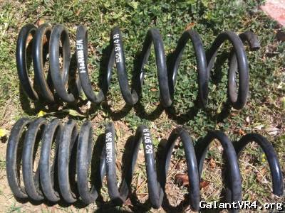

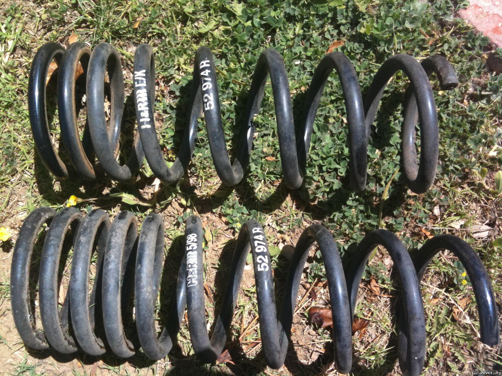

Unless H&R changed the rear springs? Can those of you with the uncut and cut springs post a part number if possible? I know the H&R's that are on 802 are cut per prev owner and the ones on 611 who knows but I remember there being a bit of difference in how many coils. I will have to check next time I work on my buddies now 611
Was working on the the VR-4's this weekend. Notice one says EK which are on 802

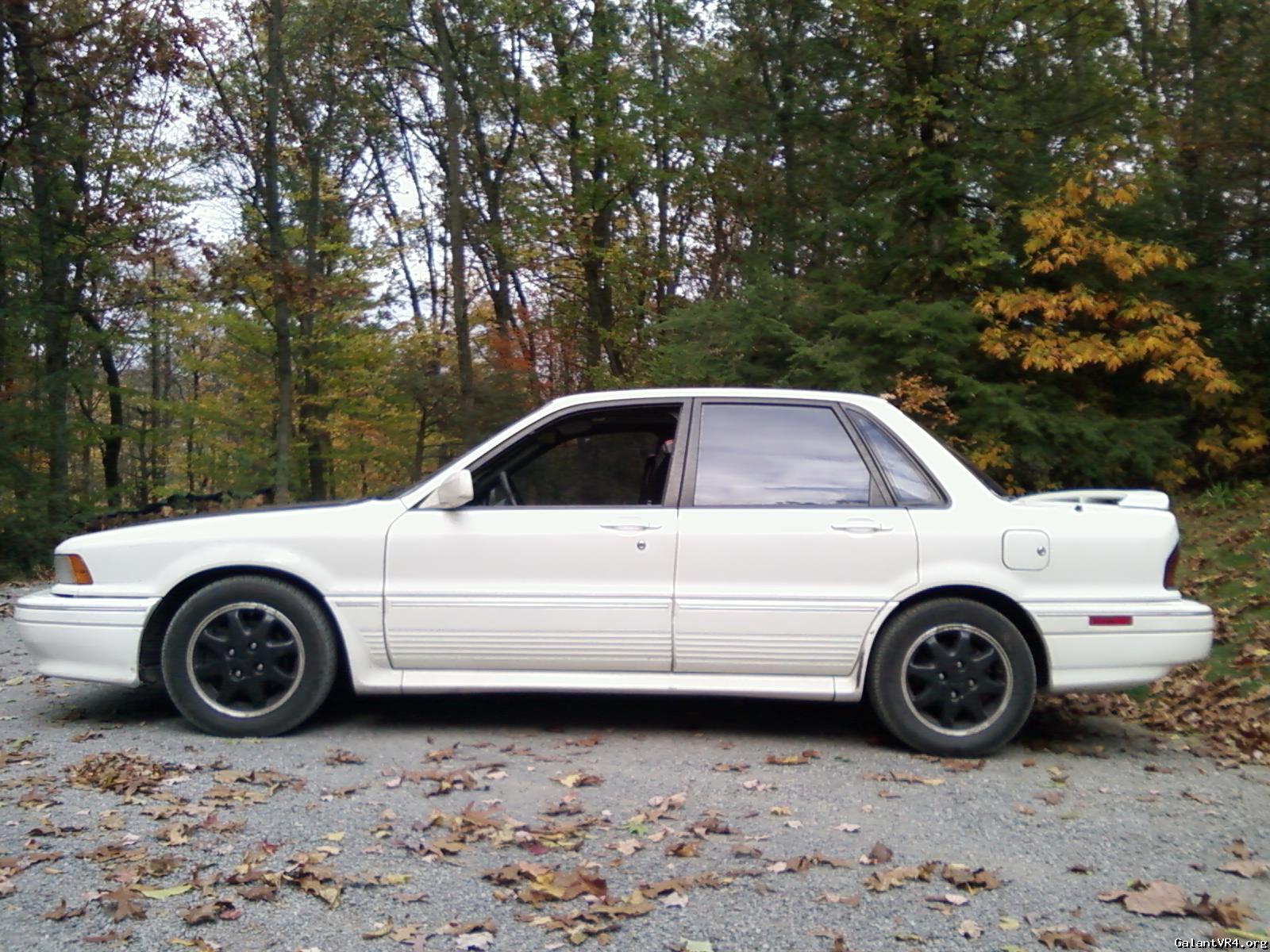

Here is a example I found with uncut springs. web page
The car has a rear rake stock. H&R clearly just kept it. Cutting springs changes the spring rate. While I don't have people in the back often, I'd hate to have the tank full, some stuff in the trunk, and a guest or two with cut springs. I'd be afraid of the back going too low with cut springs.
