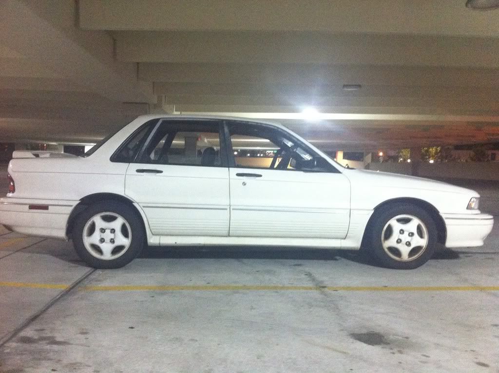

Here is a picture, it sits even now, dont know what was causing it to sit unevenly earlier. Still a tiny bit of rake I think
