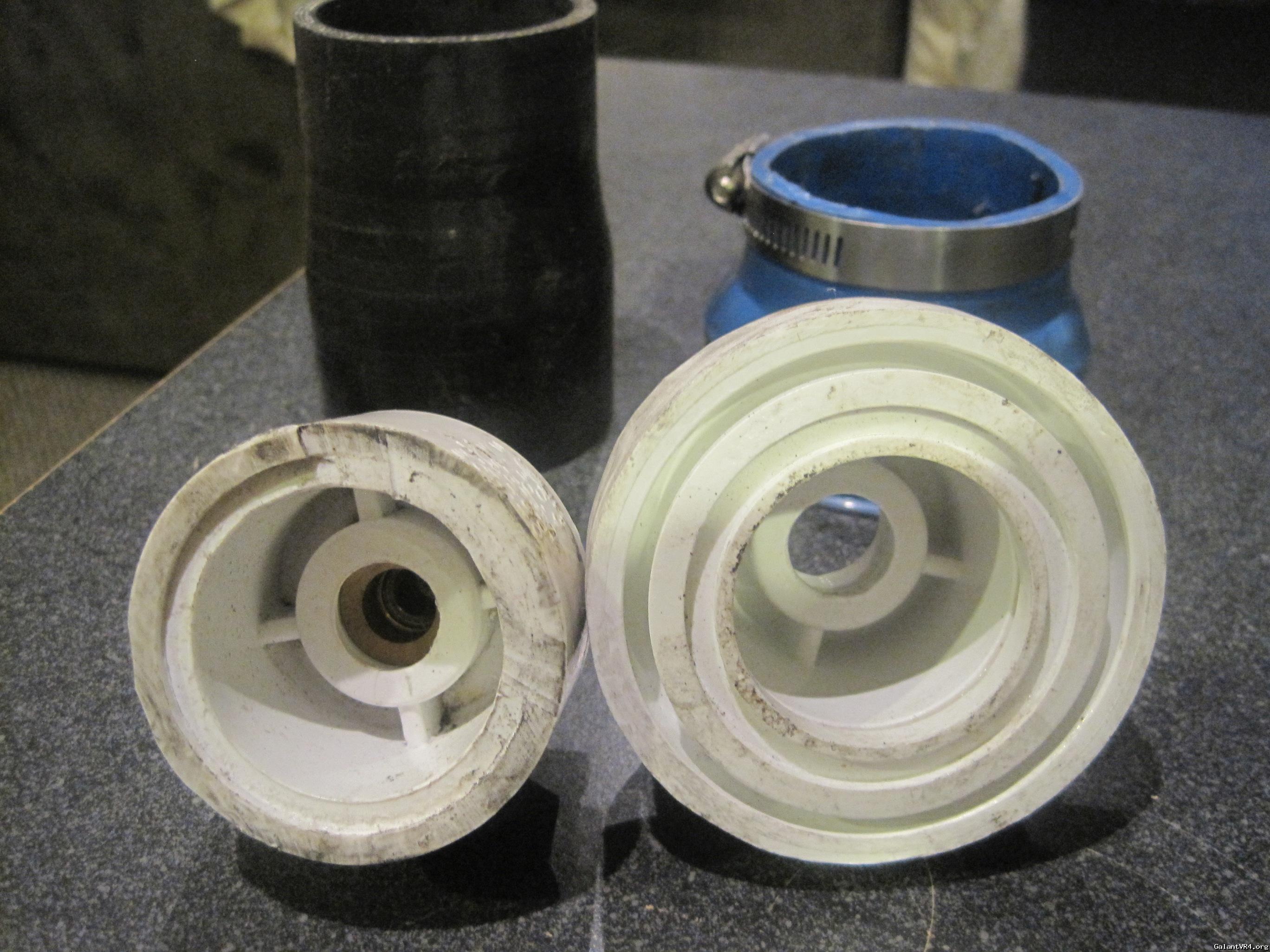

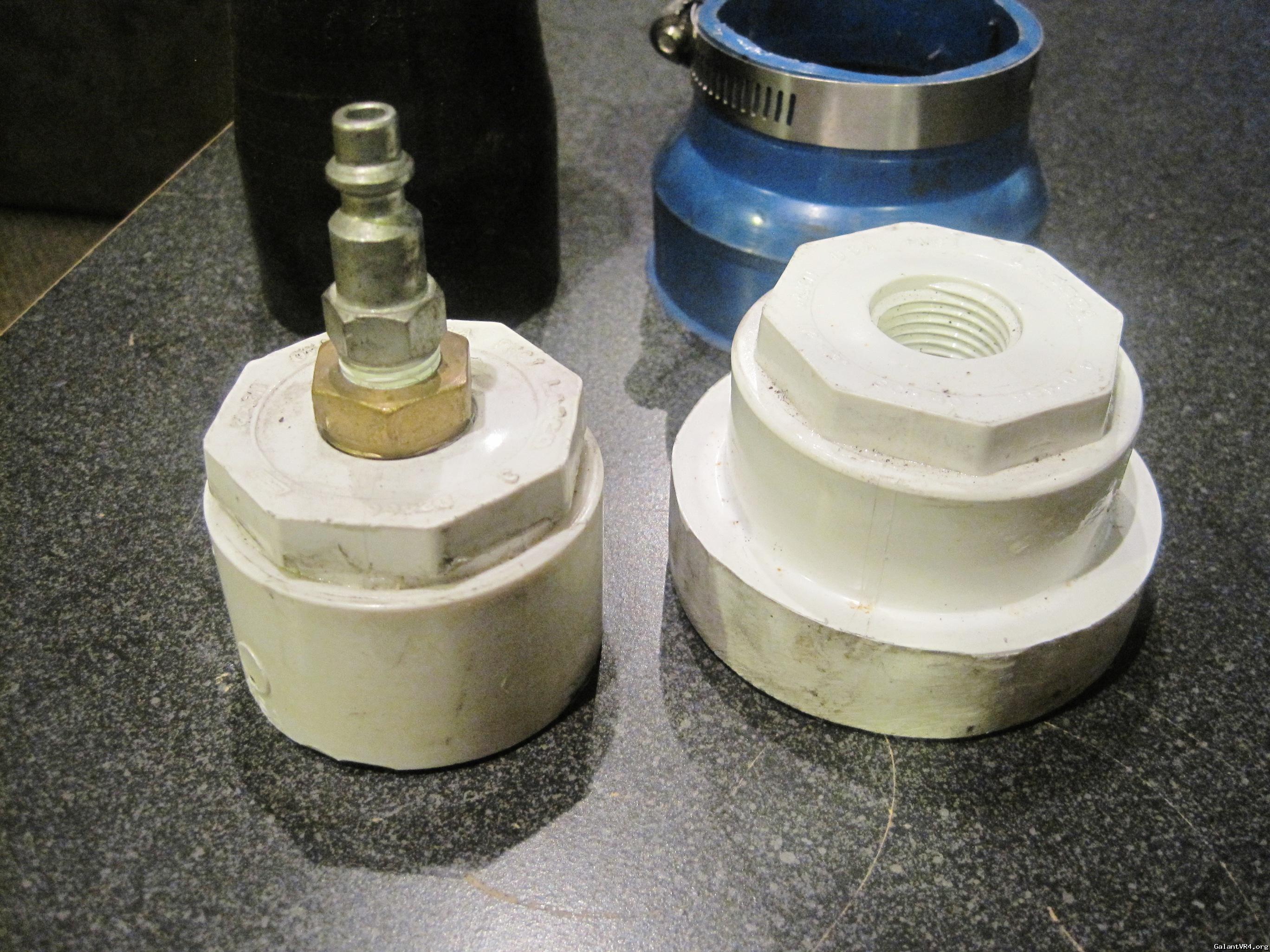

The easiest way to do a boost leak test that will test the whole system is to get a PVC coupler that has threads on one end. Thread a quick disconnect air chuck into the end and then use a silicon coupler that can clamp down on the turbo inlet.
Once you have the tester clamped to the inlet of the turbo, turn your air compressor regulator all the way down to zero and plug the hose on. Slowly raise the air pressure while watching your boost gauge. Once you get 5-10 psi into your system, start finding air leaks. It wont be hard. Make sure you open and close your throttle and listen for air leaking out the shaft seals also.
Here are some pics for reference. You just have to go to Home Depot, Lowe's, Menard's, or whatever you have around you and pick through the stock. Take an air chuck to match up the threads so you get the right thing. As you can see on my smaller one, I glued the threaded piece into a 2" pipe to get a little bit bigger outside diameter. On my bigger one, I bought a 2" clean-out coupler and filed off the threads to give me a 3" outside diameter tester.
As you can see, the main PVC part is the 1.5" x 1/2" Lasco sch 40 fitting. Lasco's PN is D2466. Then get a brass reducer that fits into the PVC and your air chuck will thread into. Then just build it up as needed or get to the size you can clamp onto a turbo or onto a pipe.
Pressure test the system. Sounds like the car is getting unmetered air, meaning air that enters the engine without going through the mas air flow meter first.
