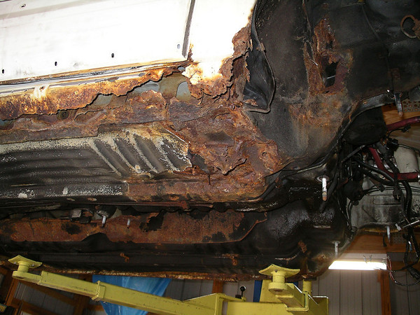

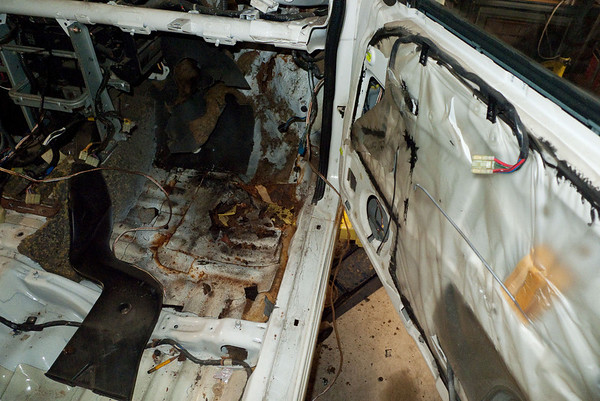

The rusty one from Rochester NY was #255/2000 a White 91. That one was utterly destroyed by rust. I don't have video of it getting squashed by the claw on 12/29/09, but I do have a few pics I took of the rust issue when it was in my shop.
I was pulling on the engine harness while still attached and was able to easily pull loose about 2 square feet of the firewall...big enough hole that I could kneel on the passenger side floor and put my head into the engine compartement through a giant rotted hole int he firewall. (I sat in pass floor and easily kicked my foot right through the firewall) Pass front fenderwell was also completely rotted. If I spend 15 minutes with a BFH, I could have knocked the whole shock tower away from the firewall and broke the front end completely off. That's pretty much what happened when the claw crunched into the pass front door: the front of the car broke off!
That white one was completely unsafe to drive on the street. It was one pothole away from a complete steering/suspension failure. sh*t, the floor was so rotted, I wouldn't be suprised if a heavy person sitting in pass seat broke through the floor if suspension bottomed out. /ubbthreads/images/graemlins/rofl.gif
NateCrisman
Nov 22, 2008
2,054
Blairstown, NJ
It seems the thing that killed that GVR4 was the windshield was replaced and it wasn't sealed up right, which allowed water to run down the inside of the A pillar. So the carpet on the pass side was perpetually wet and that held moisture against all the sheetmetal on the floor and firewall area. I had originally thought "oh, it's an upstate NY car, snow and salt did it"...which is what rotted the lower frame rails under the side skirts and all the undercarriage was nasty. But the real killer was the rotted frame/floor/firewall which isn't a salt issue...it was a windshield glass leak! This could have been a deep south car just as easily rotted the same way from a water leak.
