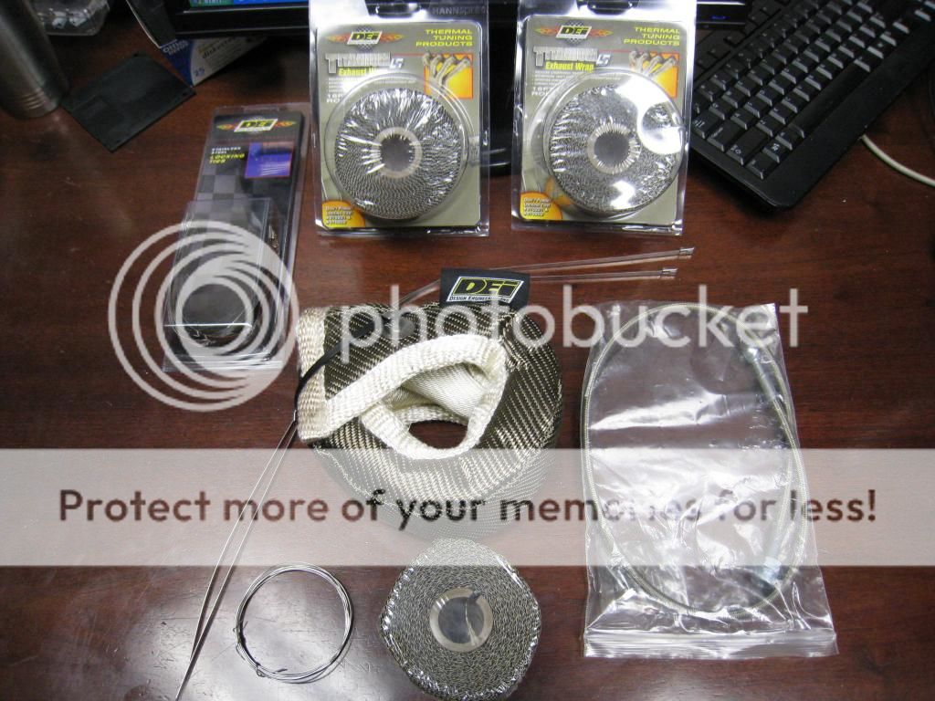

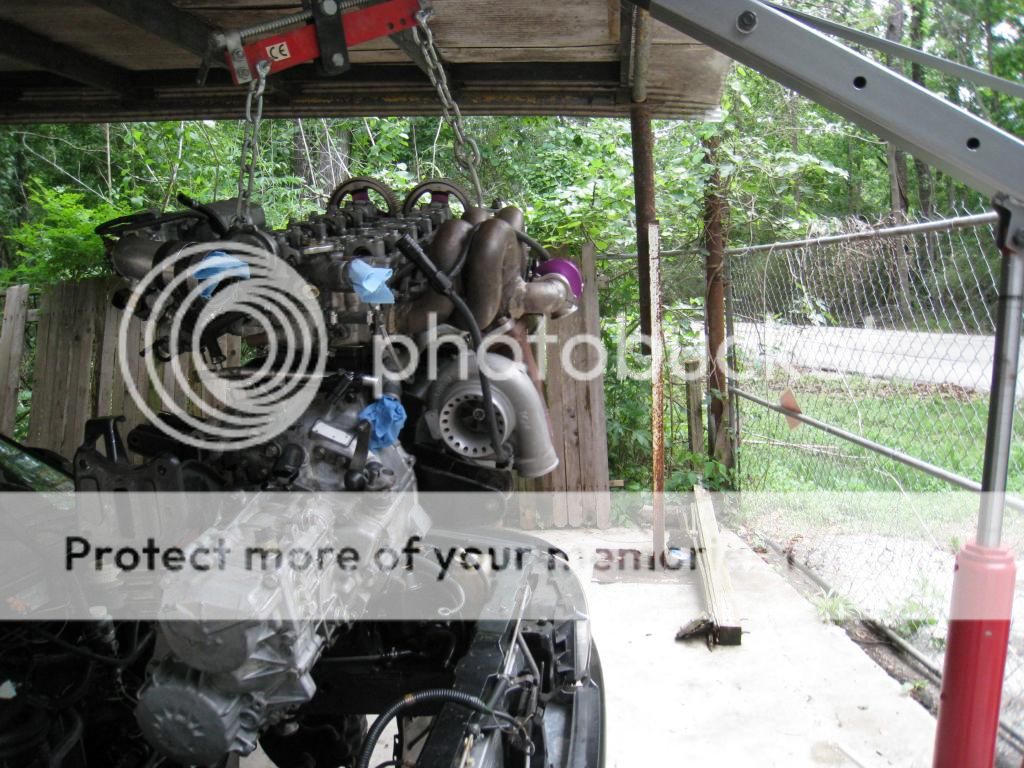

some more progress, getting closer to getting Samara back on the road again finally, bought a bunch of heat wrap for all the hot parts including a T3 DEI turbo blanket

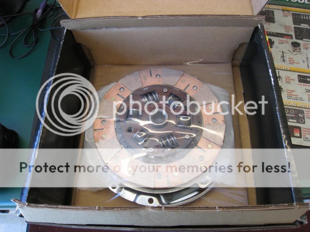

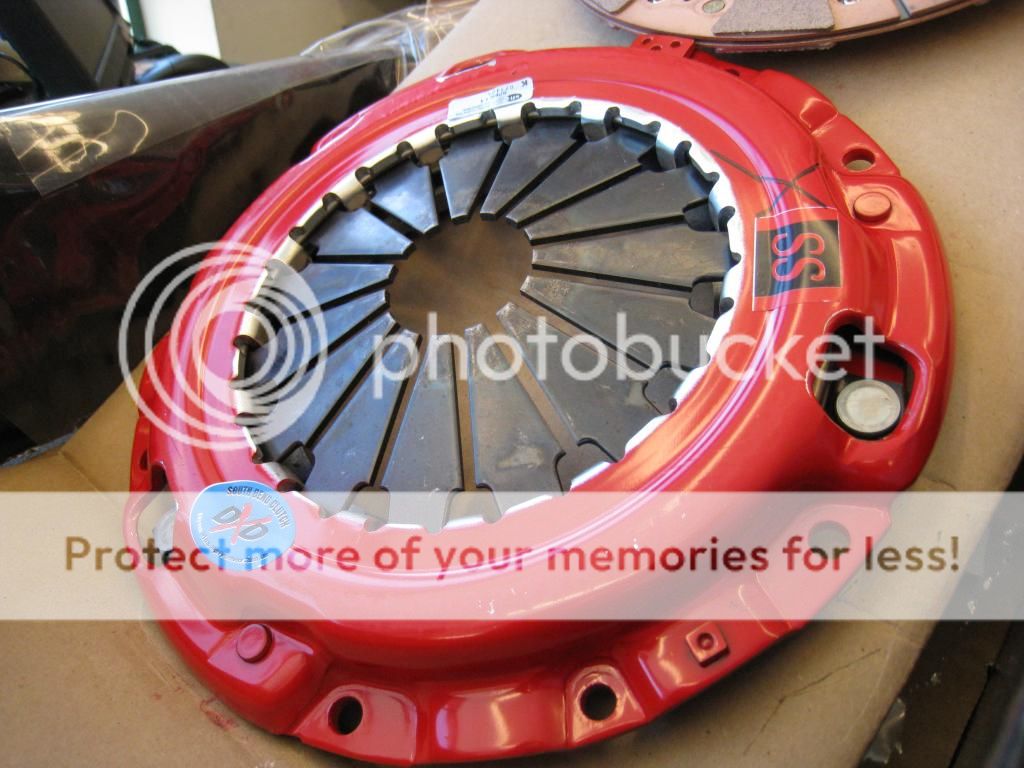

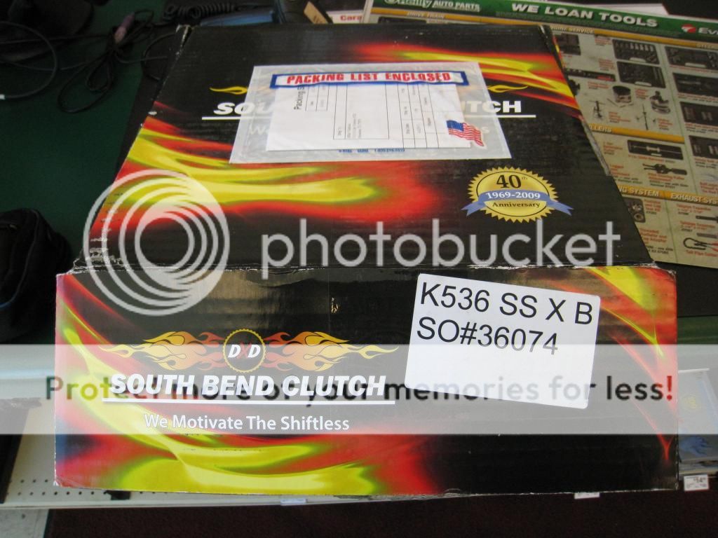

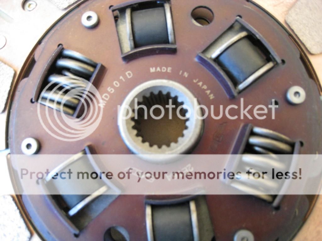

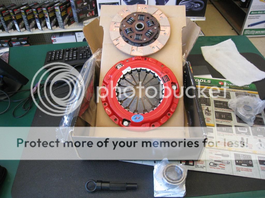

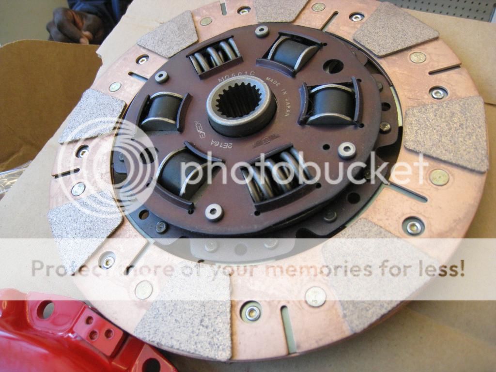

then went ahead and upgraded the clutch while im in there, because i know the old one wont hack it, spoke to Tim Zimmer and he told me this was the best of the best single disk clutch there is, is doesnt get any better then this for single disk's. supposed to handle upwards of the 700 mark. this is the Southbend SS-X pressure plate with full Ceramic disk (b series). part number K536SSXB

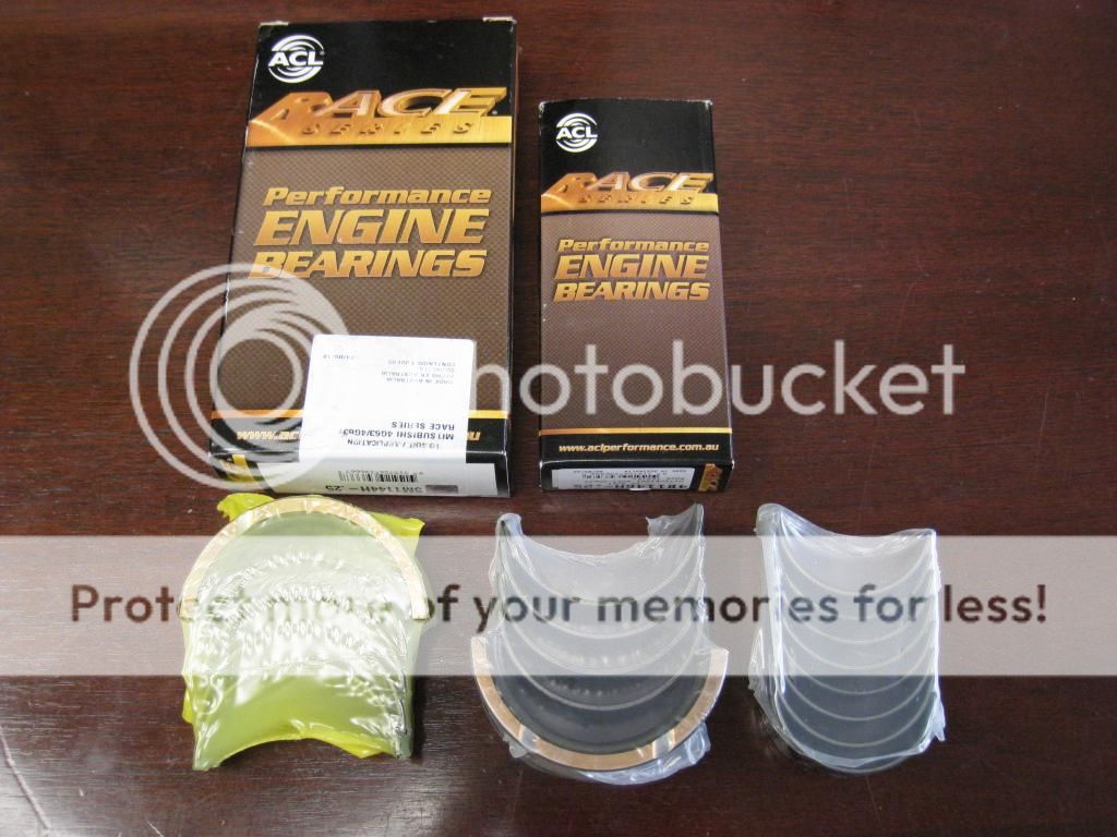

then ordered me new ACL main and Rod bearings.

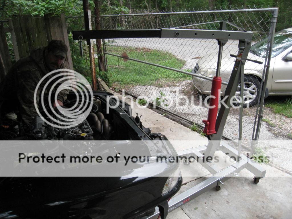

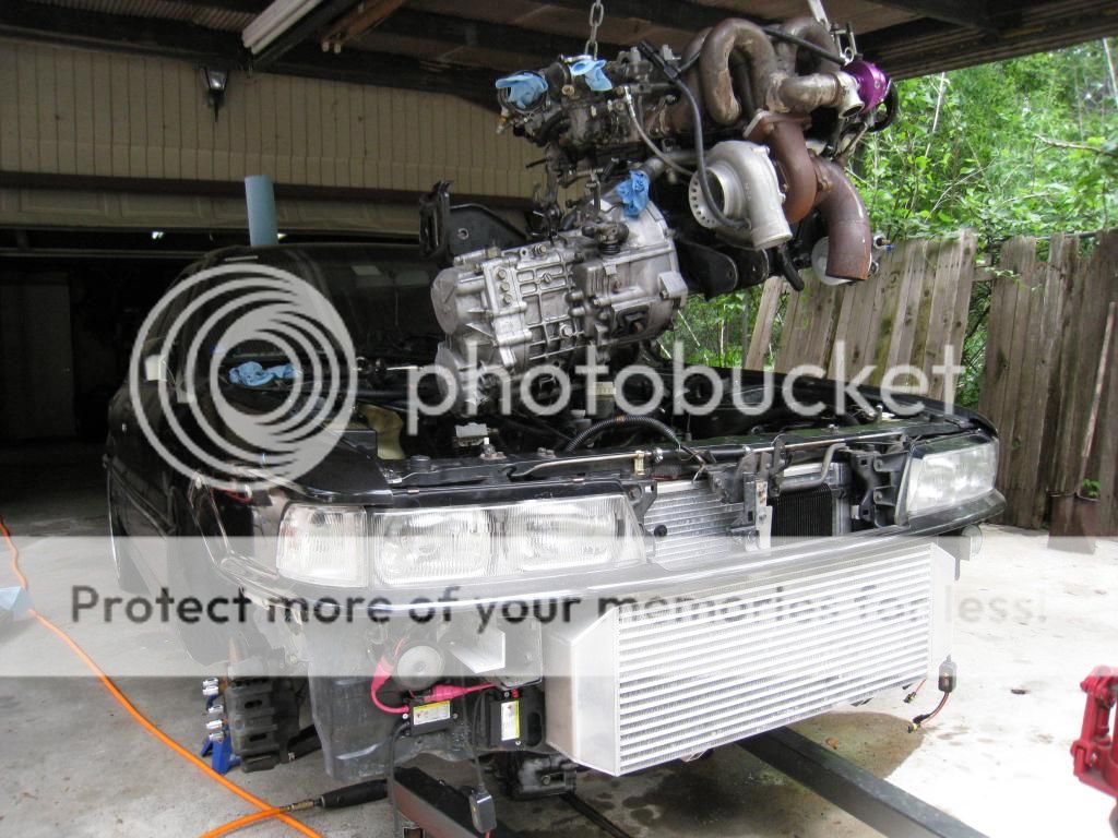

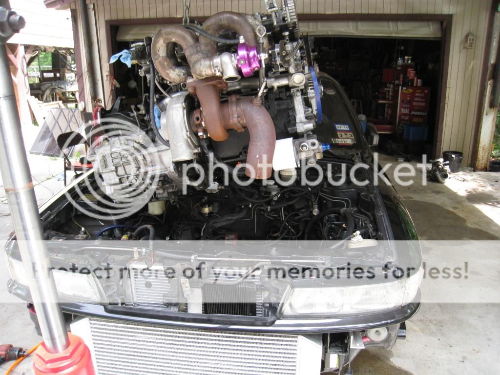

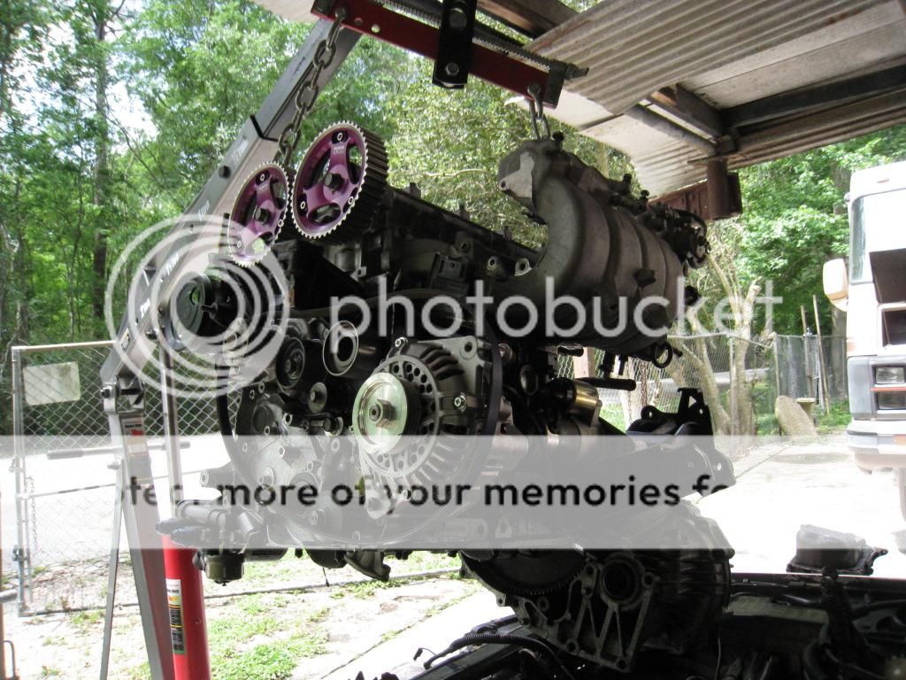

and here we are about to pull the motor.

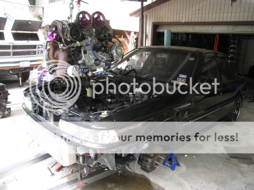

and out it comes /ubbthreads/images/graemlins/grin.gif

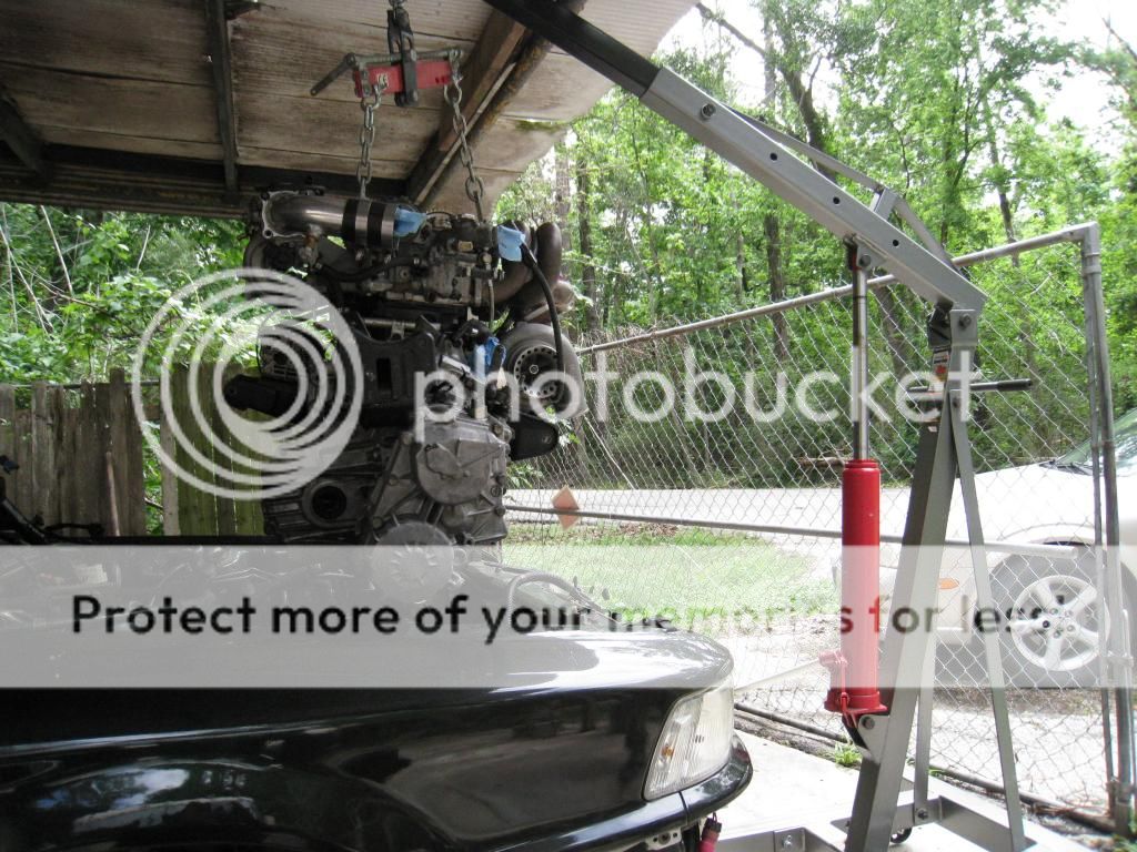

and here she is with no motor /ubbthreads/images/graemlins/frown.gif

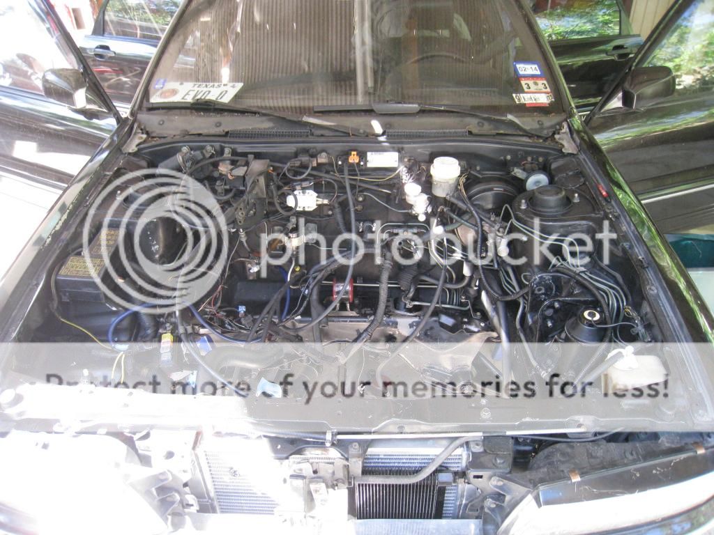

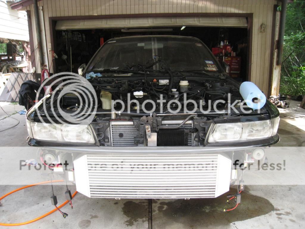

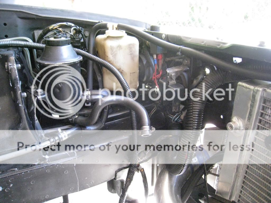

before shot of the engine bay before i went to town on it with degreaser and shop towels.

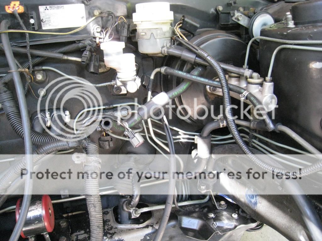

cleaned every single little line and surface. /ubbthreads/images/graemlins/grin.gif

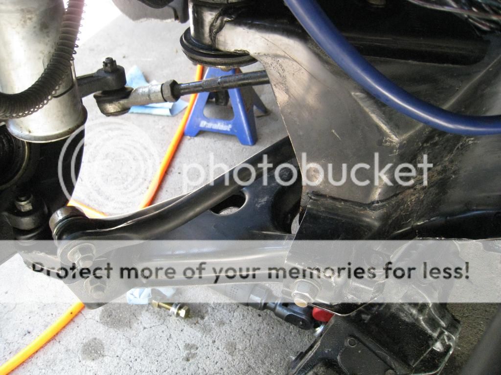

even got the lower subframe.
removed my washer fluid res, because thats where the future one off catch can tank will live.

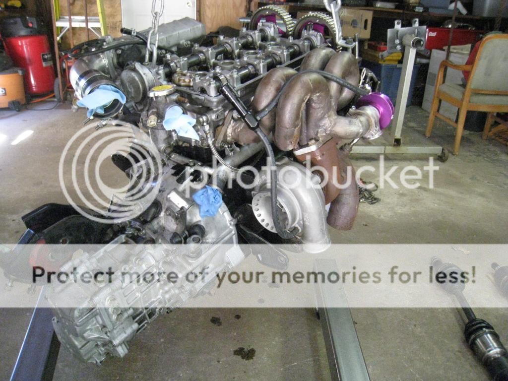

and here's the motor awaiting new parts.

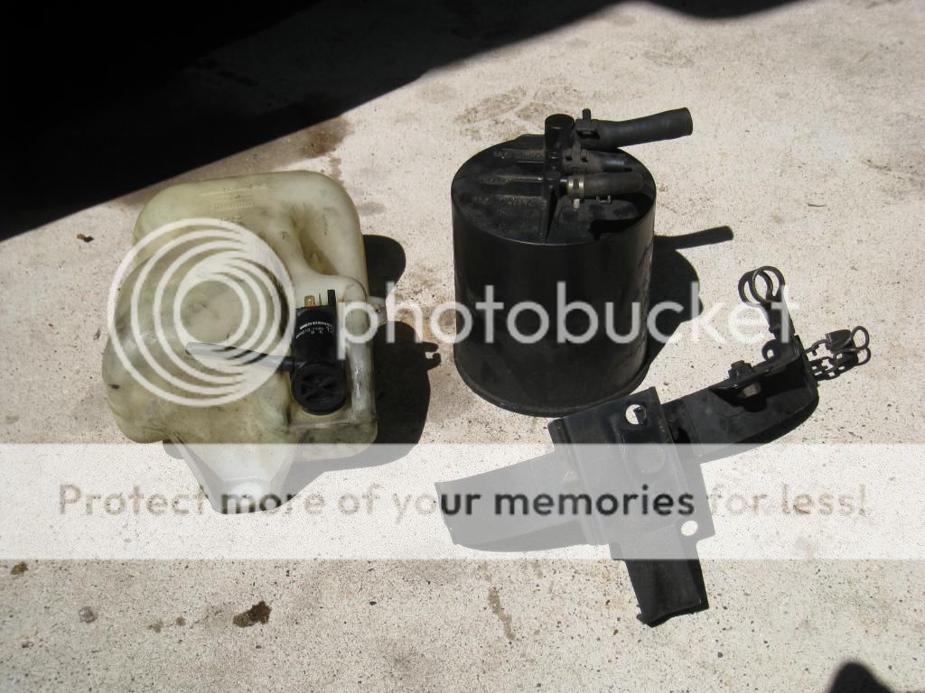

removed these parts if anybody wants them, you pay the shipping and their yours.

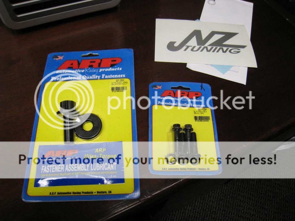

last but not least, i ordered some new ARP bolts for the Fluidampr crank pulley.
