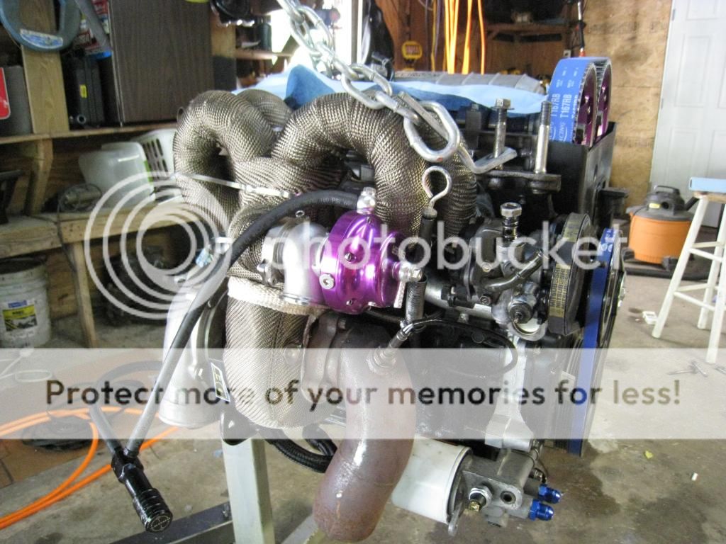

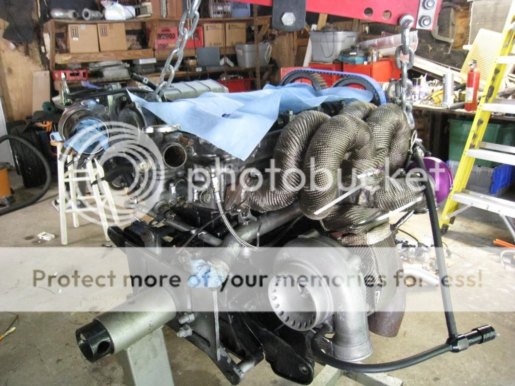

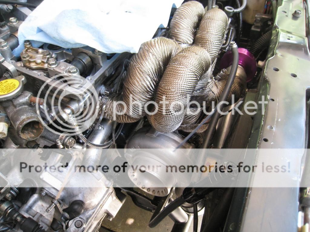

Got the motor all buttoned up and ready to slap on the new clutch and tranny then drop it back in the car. =)

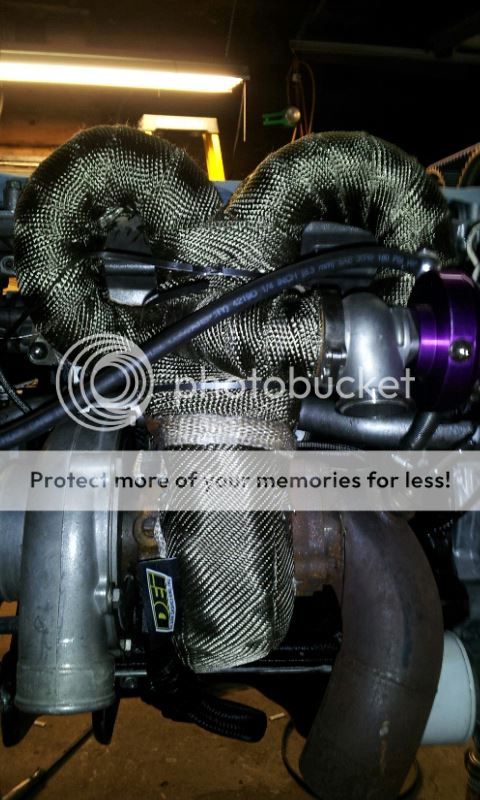

also got all my hot parts wrapped up in fancy DEI Titanium heat wrap and Turbo blanket. still need to change the position of the downpipe so thats why it isnt wrapped yet.

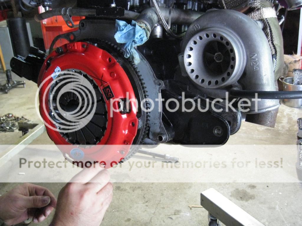

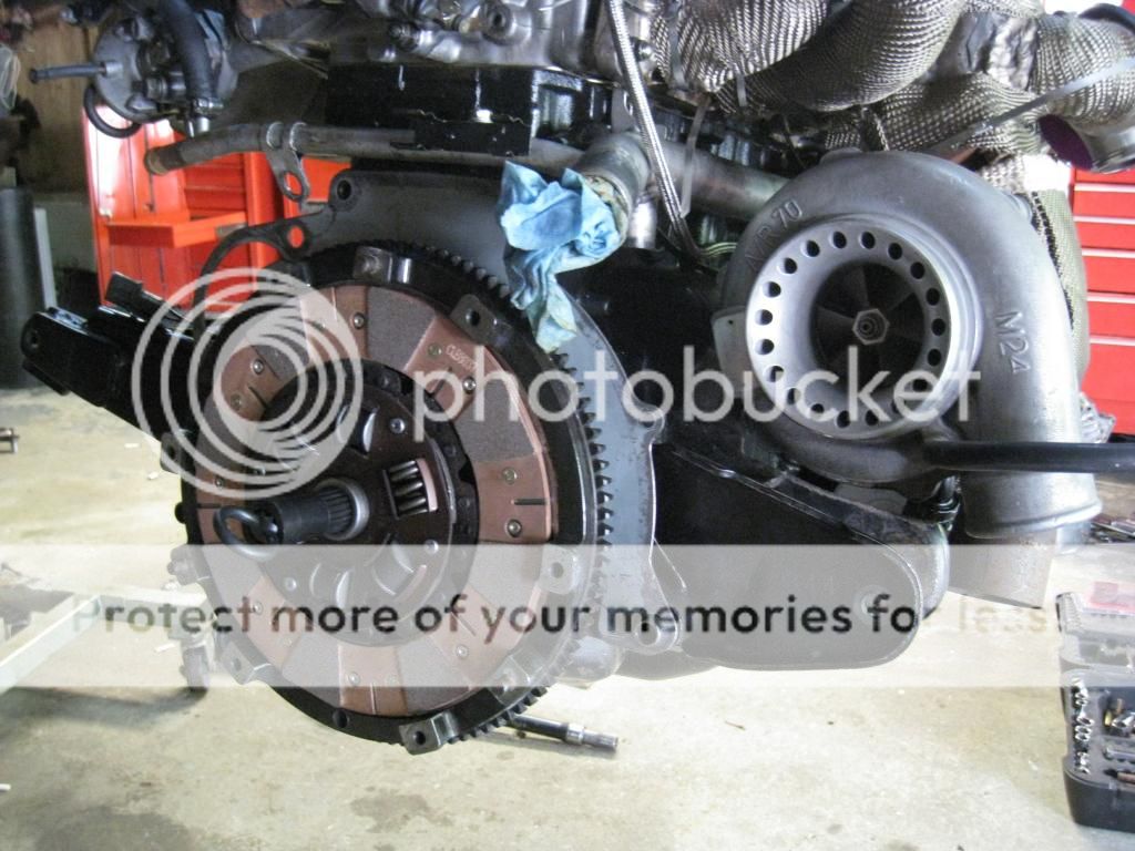

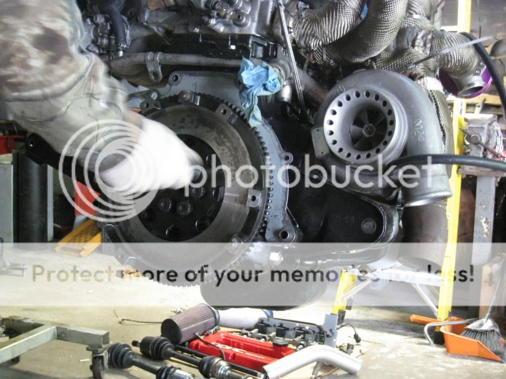

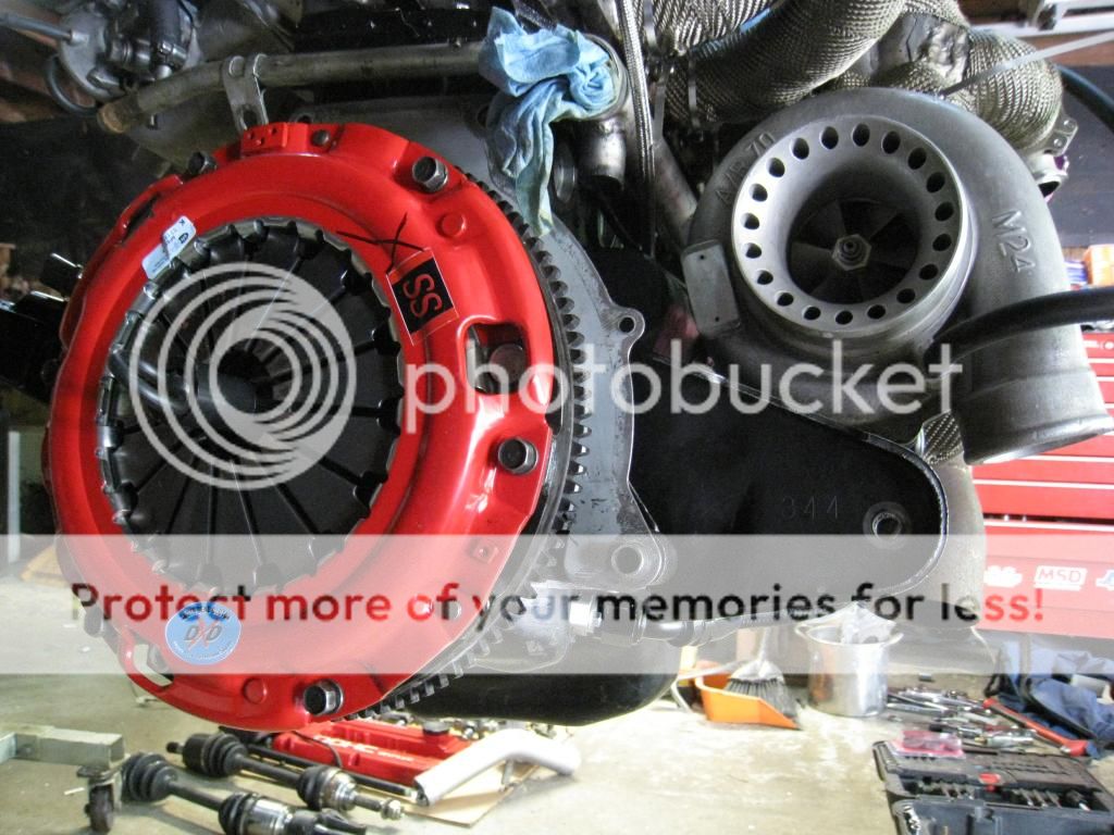

Got more stuff done this weekend,

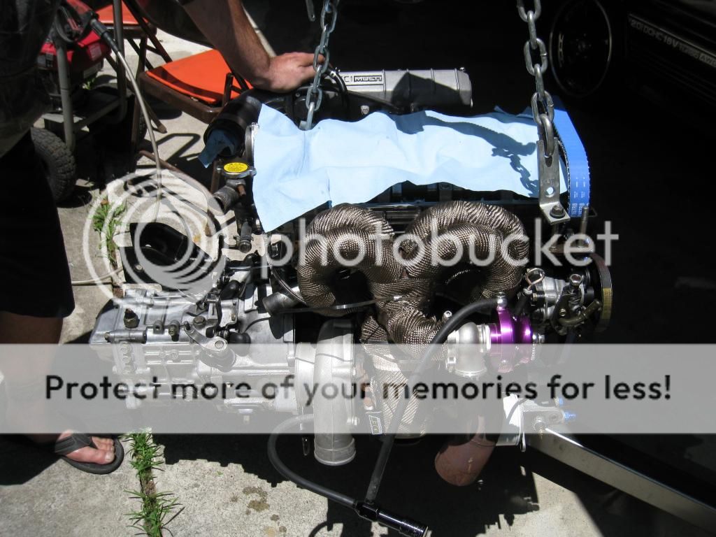

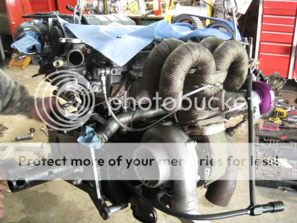

engine all buttoned up and ready for the transmission
Taking it off the stand
Putting on the ACT Streetlite Flywheel
and the South Bend Clutch Disk
then the Pressure Plate
Fully Assembled =)

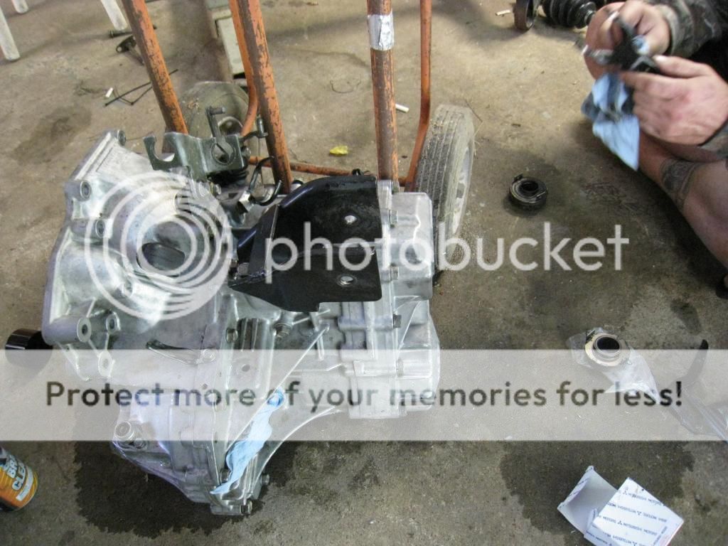

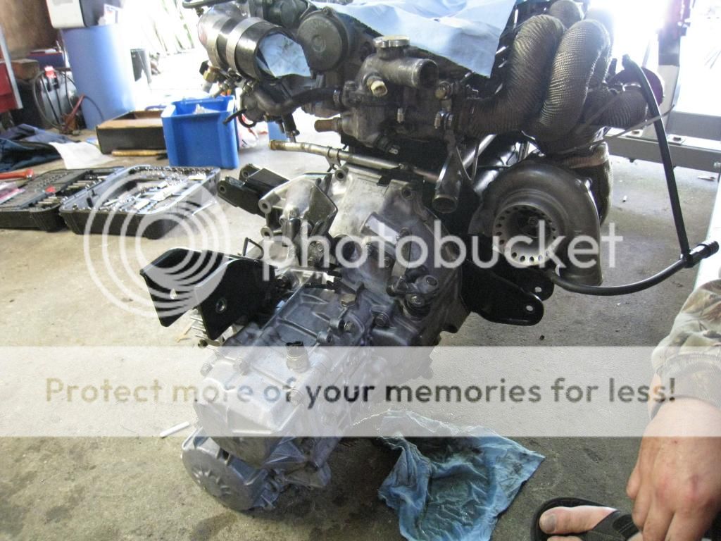

Cleaning up the Transmission a bit getting ready to slap it on the motor.
Installed =)

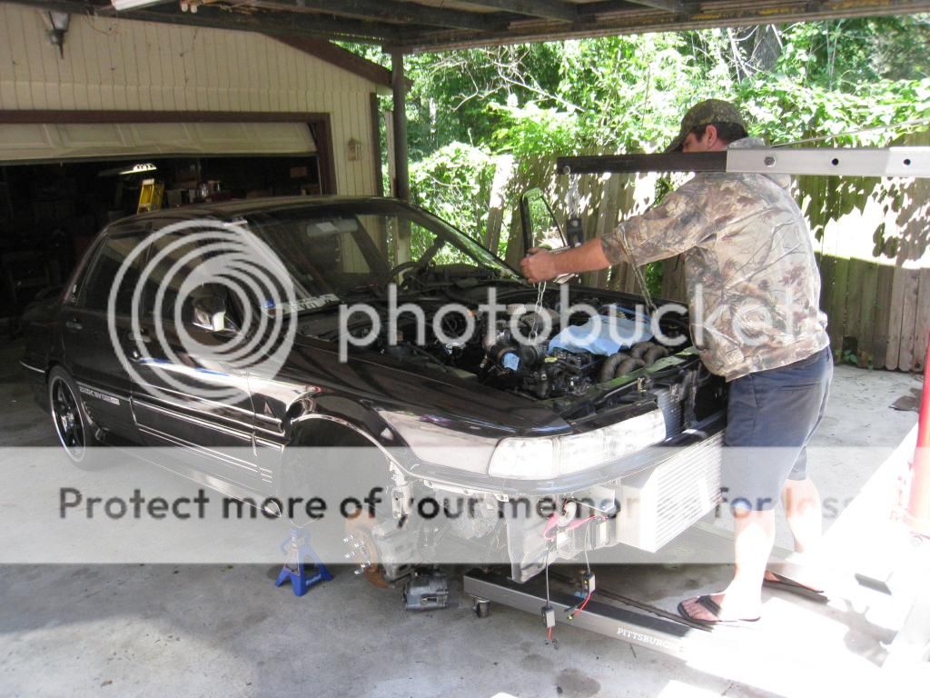

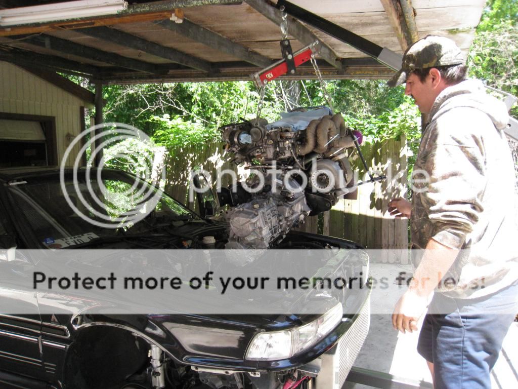

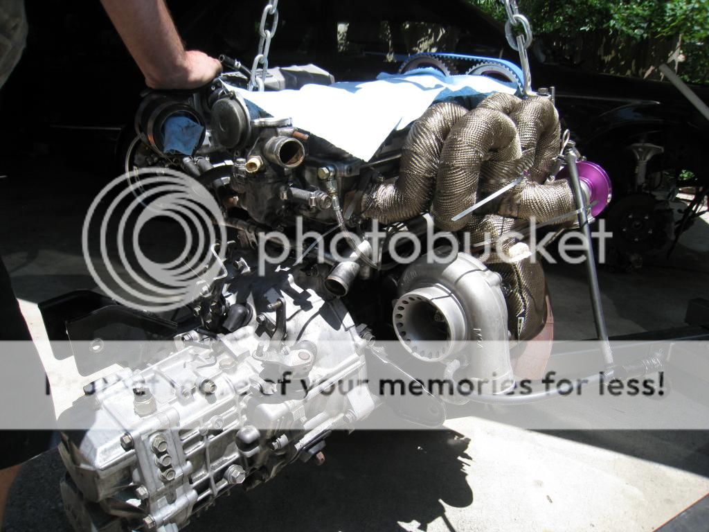

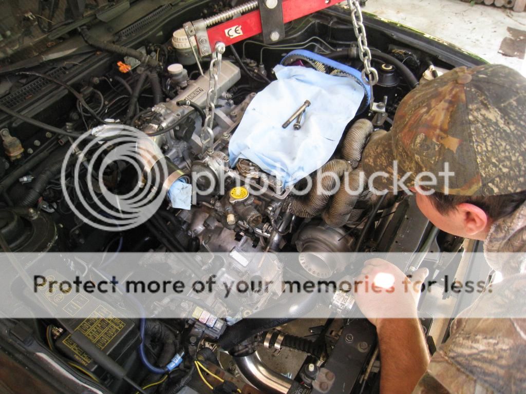

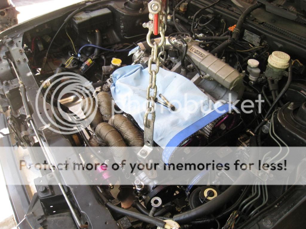

Moving it over on over to the car on the engine hoist.

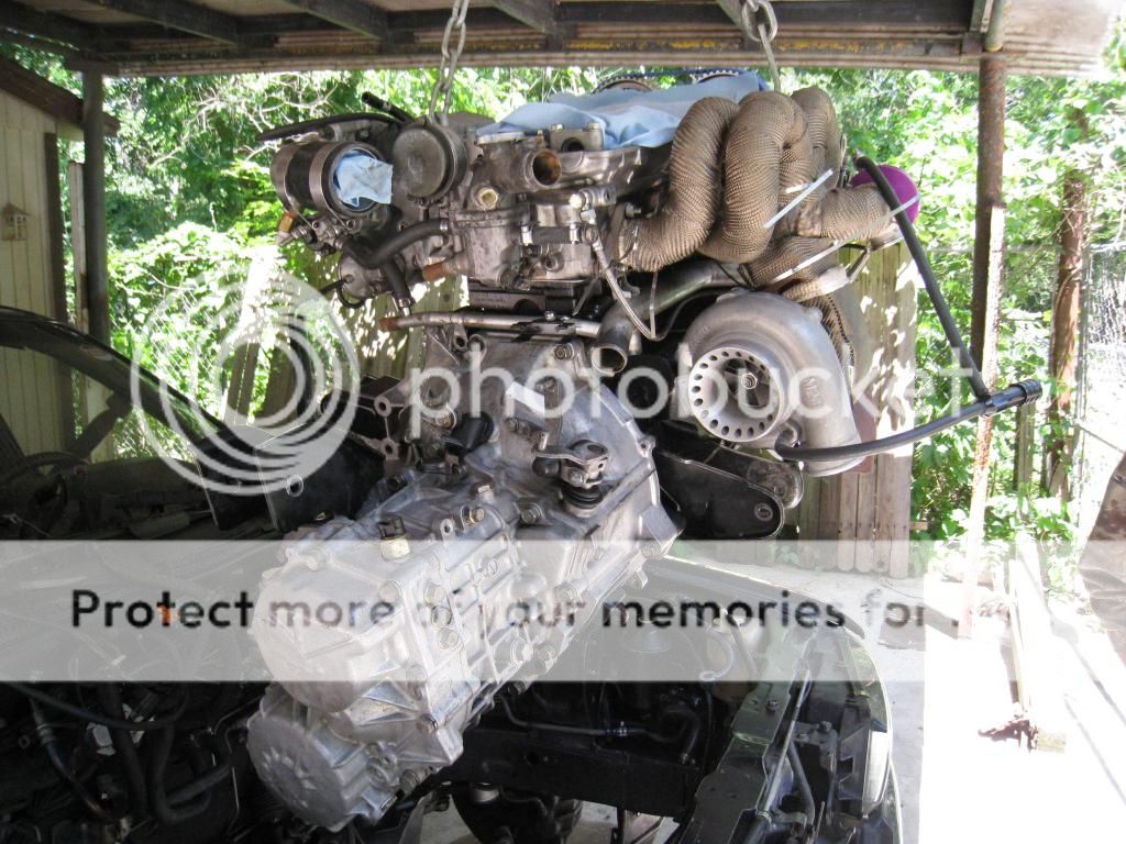

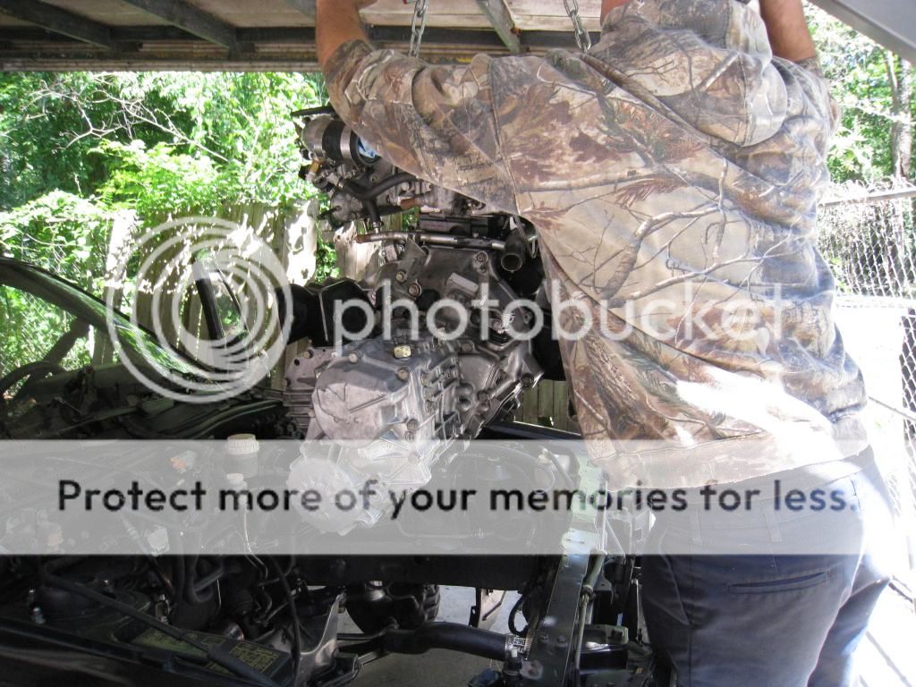

about to drop it back in.
and back in =D

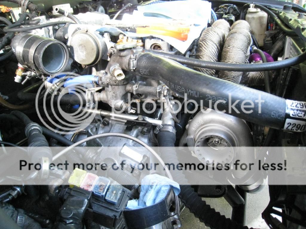

starting to get things connected.
aligning the mounts up.

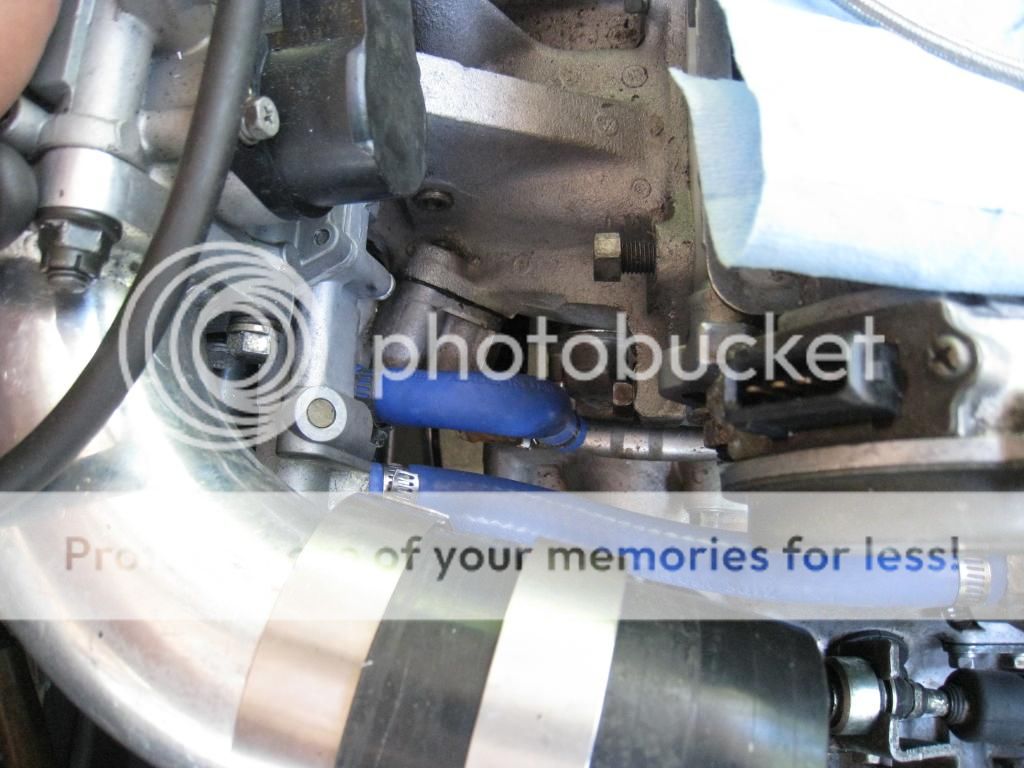

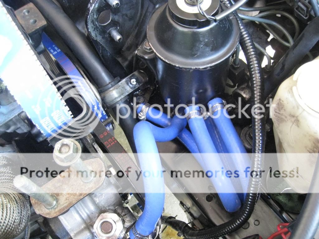

Re-did my old power steering lines with these nice Silicone ones.
also did my small heater hose's in the same stuff.

Hey i just noticed something, the bracket that holds the shift linkages on the trans look like they are from a 90 dsm? /ubbthreads/images/graemlins/dunno.gif is that a 90 trans your using?

Pretty sure it's a 91 trans. It's the one that came with the car when I bought it.

Well yeah I'm sure they are different but nope no issues. This is actually the best shifting one I've had. My two other DSM's felt real notchy and grind sometimes. This one is smooth.

Those power steering lines you used (you said silicone), do they have any reinforcement bands in them? If not, they aren't going to handle any pressure. That, and they may swell up from the oils.
GSX_TC
Apr 7, 2011
3,733
Houston, Texas
I believe they did have something in them, there was also another layer of something inside too, its red in the center.
