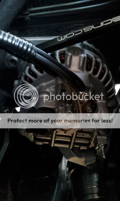

Well the Alternator is all wired up now too =D BIG thanks for Mike @ FIST for doing the welding and Rob Patterson for putting it all together and wiring it up.

Looking good Mike! What welding was involved with the alternator? Or are you referring to the BullFab bars

From Diego.
