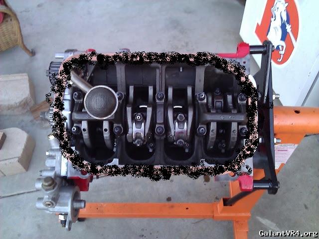

Due to popular demand, I have removed the Fel-Pro oil pan gasket and replaced it with RTV as you can see in the picture below.
3,478
Got the motor all assembled and ready to drop in.
I installed a DIY heat shield to keep the wideband O2 sensor a little cooler.
I put a micro switch on my Cyclone manifold so that when the butterflies fully open the switch is triggered. I'll use this to adjust when they open, and make sure they are working as they should.
I installed the oil cooler and hooked everything up. -8 AN lines running to and from.
