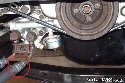

I need to know what size the fitting is between the hardline with the banjo fitting and the soft line (circled in red below):
It's a flared fitting of some sort. Basically looking for an adapter I can screw into the stock soft line where it meets the hard line of the banjo fitting. Thanks.
It is probably 14 x 1.5 mm if memory serves correctly. It might be 16. If you have one, you should be able to just measure the diameter, as I am almost certain it will be 1.5 thread pitch.
I know what he is referring to. I think they are the same as the power steering rack flare lines which are 14 x 1.5 mm. Definitely not AN or JIC anything on a stock part.
Thanks for all the responses. I believe Iceman is correct in that the fitting is a M14x1.5mm inverted flare. I'm gonna see what I can dig up that will work.
According to the thread on Tuners, you will NOT find these fittings/adapters at the following vendors: XRP, Aeroquip, Russell, Earls, Fragola, A1, and Goodridge.
