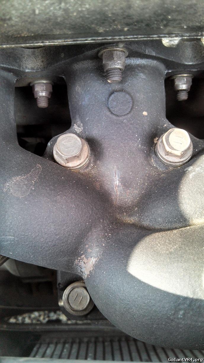

Haha...
Where did it crack and was it after running it for awhile?

That's what concerns me about coating the FP or wrapping it. I hear so many stories of cracks in the manifold and almost everyone was coated or wrapped.
I've got about 15k on mine with no cracks and no covers.

I had a ported evo 3 mani coated by hpc a loooong time ago and it never cracked on me. Used it with a 16g on my talon.
I think the cracking might have something to do with the nickel content. ? Maybe too high or too low?

I'm far more inclined to wrap the IC pipe then the manifold. That FP racing mani is sexy. All the better if you've heard stories of covered/coated mani's cracking.
Beside, heat wrap on that one section of IC piping is going to be way cheaper, and with my girlfriend tired of hearing "I swear I'm done putting money into it"...

Hmm, now you have me reconsidering the coating...maybe I should just throw a coat of high temp paint on it then and install it...my 02 is wrapped and made a heatshield to block off alternator so not concerned there. was going to get a turbo blanket too, but sort of wanting to just get this going.

I was wondering that too. I don't know what to believe. I couldn't gather up info on when the manifolds were made. I also was wondering if these guys also have a bigger turbo with a heavy downpipe and no extra support for the turbo. I have a lower bracket that helps hold the downpipe so it takes stress off of the manifold/head studs. It is a lot of weight to be just hanging there, and on a DD with the amount of heat cycling I'm sure it doesn't help not having extra bracing or hangers.
