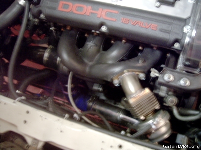

If you run a civic 1/2 width radiator, you have room for as much wastegate as you want. I had a problem with a deltagate on a Tnetics manifold years ago, it rubbed the radiator just a little, but i got it to work. I did have to "coerce" it a bit, though. The deltagate was sh*t, and i got rid of that setup. I ran a tial 38 mounted to a 2g manifold for a long time. It was mounted so it stood straight up, exiting forward with a 90° down turn on the dump pipe. That setup cracked around the welds and wasn't all that great. Now i'm running the HAFE cast mani with a tial 38 exiting straight down. I'm running a GT3076r and intend to replace my manifold with a FP unit, and get a FP turbine housing to replace the BEP one i have now. Since tial came out with that new shorty 38mm vband gate, i really think that's the way to go, for me.
I saw the radiator as a problem for a long time. Since going to a 2" thick two row half width radiator, all of my concerns about IC plumbing, turbo, manifold, and wastegate size/placement have disappeared.

Nate and Wopper - No one makes a manifold with a mount in that manner, tho - do they? I looked up the hafe and it seems decent and a great price for a stainless cast manifold, I think. Correct me if I am wrong
On the civic radiator
Can you post pics please?
Which era of civic radiator?
Do you use stock or aftermarket radiator?
Do you fab up special mount for the radiator height and bolt to the gvr4 location?
His radiator is stock and white/grey on the top, so maybe he can upgrade to a civic radiator, perhaps....

Can you post pics of this hafe manifold and wastegate setup you are running and how close it is to the PS pump?
Also your radiator setup, would be awesome....
