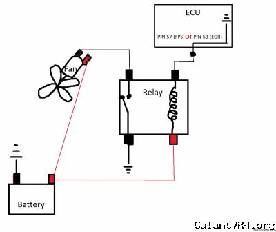

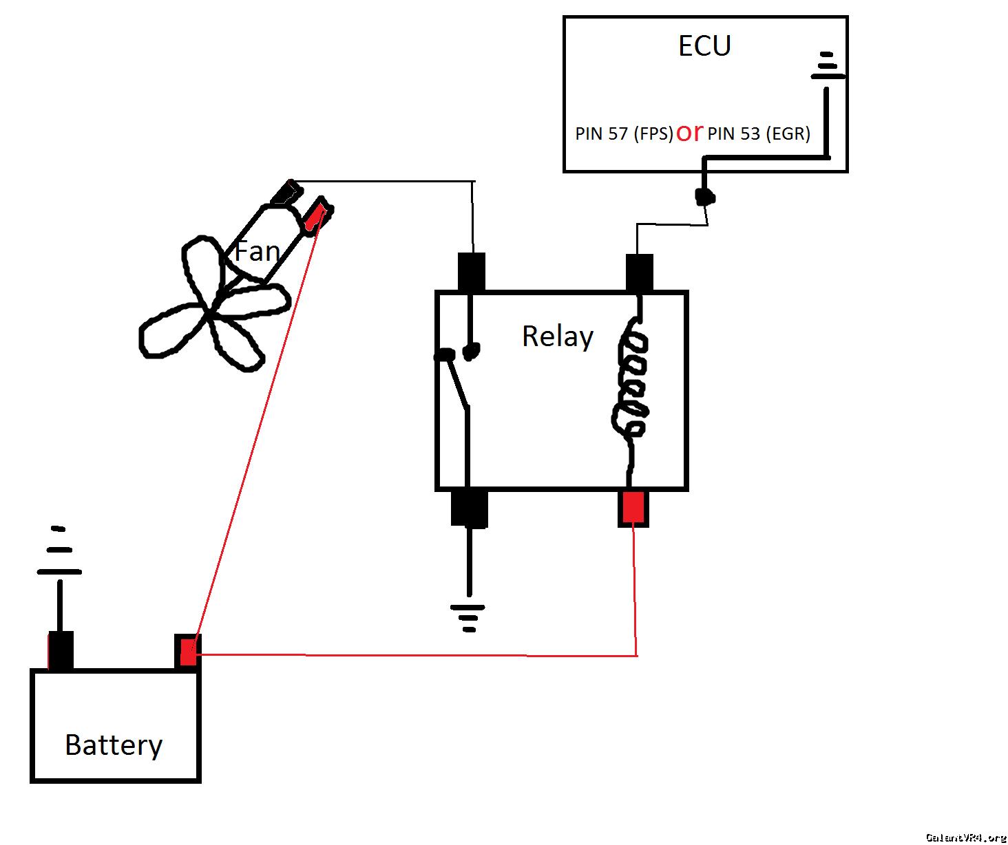

Oh, you do have ECMlink. That's good. You can trigger the fans to come on earlier by wiring in one of the controllable outputs to pull the fan relays to ground based on your parameters. I removed my resistor so that my fan just uses high speed when it comes on.
This is probably the best suggestion at this point. Reason being, the only sensor that would be used is the engine coolant temp sensor, which seems like it is working correctly and is still in the proper location judging from your posts thus far. So, it wouldn't matter that you have the fan switch stuck into the spark plug hole and sh*t.
Problem is, you need to know how to wire a relay into one of the aux inputs (EGR or similar) for ECMlink. Is that something you would need help with?

Thank you for the wonderful ms paint. When I get time I will have to wire that up. that was almost exactly the idea I had in my head. On a side note. Opinions on sirocco (sp?) radiator? That is what this thing has and I am really starting to hate it. I can't get my temps in line and I think it is because of the lack of surface area to cool properly. Any ideas, thoughts, or suggestions? I am really wishing this car just had a stock setup but I don't think the stocker would fit with the IC piping and turbo on it. Sorry. I'm just on a rant cause this car is a nightmare and need it to make a 1000 mile trip in less than 2 weeks and I work 48 hours a week.
11,992
He actually doesn't even have to get that crazy. I just ran a wire and intercepted the green/black wire at the six-pin connector for the main fan and soldered them together. That way you're just triggering the factory relays early. There are a few ways of doing it, but that's what I did.
Based on what output you choose, you don't even have to run a wire from the ECU. You can just use the output wire in the engine bay and solder it to the fan relay ground. They're actually really close together. Keeps everything looking nice and clean.
3,478
I just wanted to outline the basic operation with the diagram I posted. Mark's suggestion is definitely the best practical solution using the existing wiring. Doing it the way he outlined would save a lot of time and effort. Does what he said make sense to you, Jeff?
