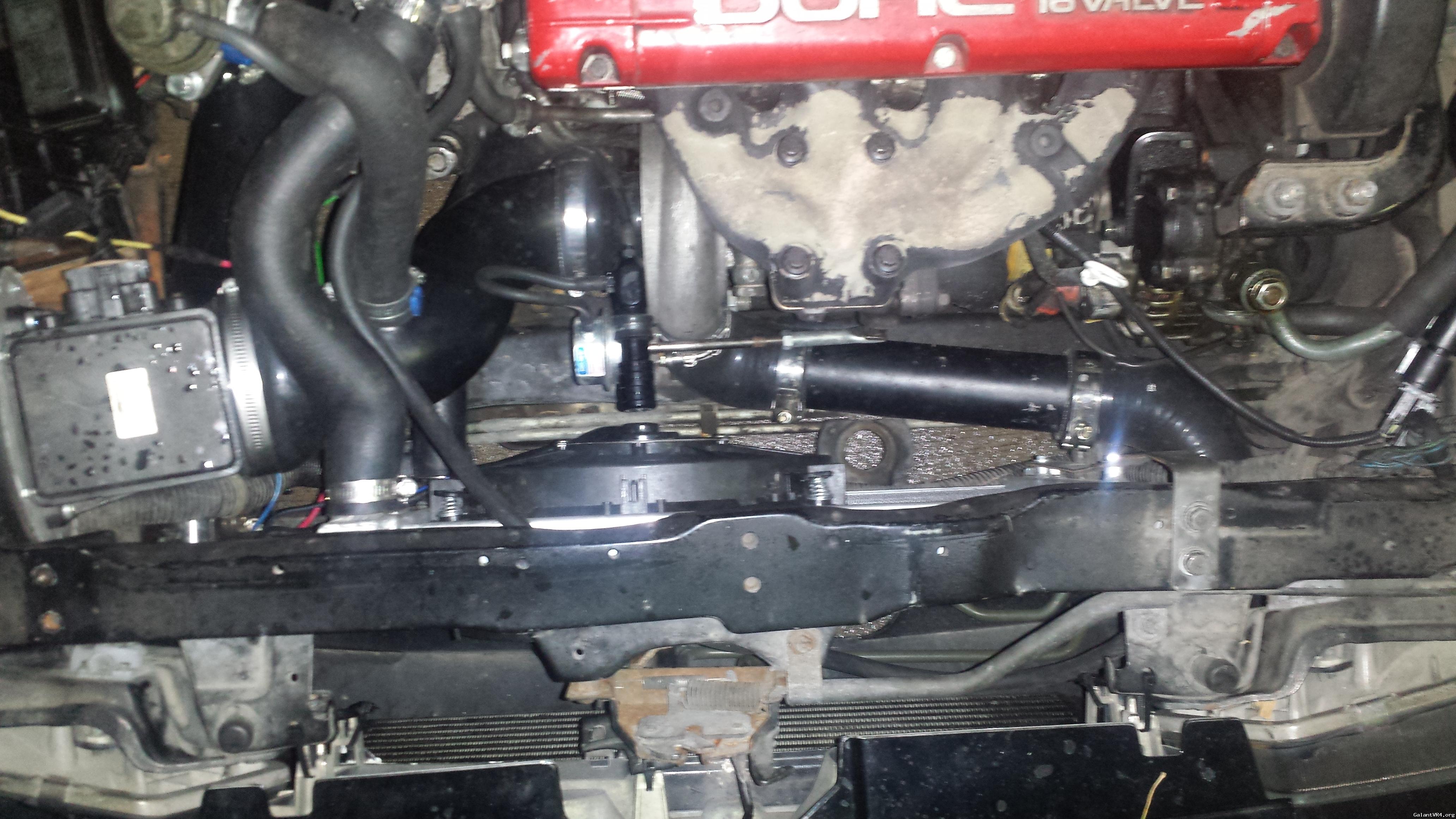

230* is high for cruising temp, especially if you aren't beating the sh*t out of the car. It's hard to tell what's causing the cooling issue at cruise, especially since I don't know anything about the car. Can you post up a mod list, and maybe some under hood pics? All the maintenance on the car up to date?

More odds and ends I'm sure. Been slowly getting the car back together and now in a hurry. Coolant system is the last thing stopping me. It's not the prettiest right now but I'm more focused on running right instead of looking pretty. As for cooling I have nothing to compare it to before to know if it was overheating then. Only thing I can think is the radiator sucks (ebay part?) If I get time tomorrow after packing I was going to swap in a 160 thermostat and see if that helps or points me in the right direction.

Where is the second fan in that picture you have posted?
I see one fan on the puller side of the radiator.
Also, no shrouds in place to help pull heat from across the entire surface area of the radiator.
Right now you have localized, at best, draw across certain portions of the radiator.

I think the picture is a little misleading. The Scirocco radiator is much more narrow than the stock radiator. He has the fan placed correctly, and it should definitely pull enough air to keep the car cool in the position it's in even without a shroud. Although, I personally would always use a shroud if the setup allows due to the reasons you mentioned.

The car does have two fans. I took them off to redo the placement and see about fabbing a shroud if possible. But right now a shroud is probably not feasible. It is currently going through the process of being tuned remotely by a reputable dsm tuner. He wants me to get the cooling issue under control first before trying wot and such. I do have wideband. As for colder weather it won't be seeing colder weather because of my move. And I wouldn't care if I had to swap a thermostat every season. But I don't think that is the issue. I'm believing it's a matter of the size of the radiator. But I know there are a few on here that run similar setups with no issues. I can't go with stock or 1g setup due to the ic pipes. Would a civic half with triple core cool better? I don't see how a 160 thermostat and moving the two fans will lower the temps 40-50 degrees.
