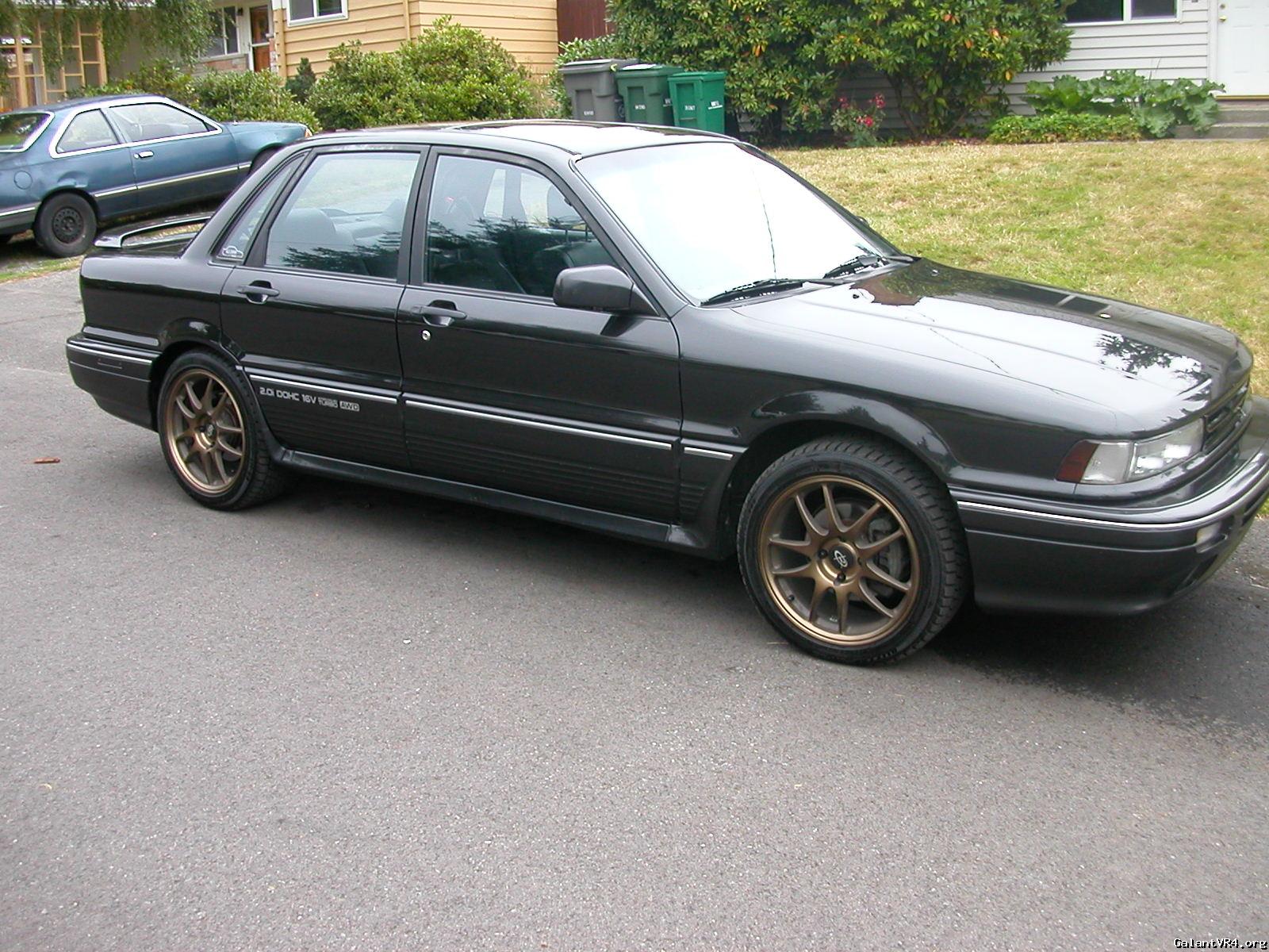

1g eibach prokit front springs
1g dsm rear springs
win (at least for me)
If i had a pic of 1411 sitting on level ground, i'd upload it, but i don't think i do.. and it's JSB at the moment.
