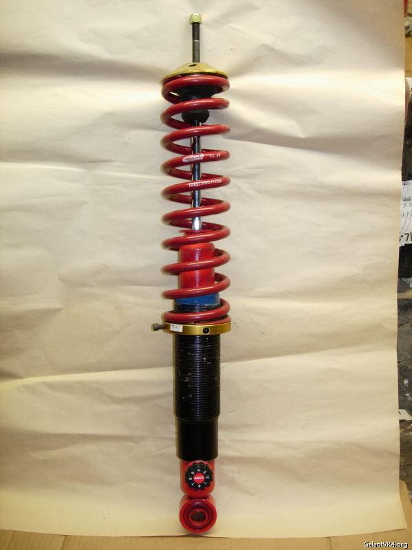

I agree with Mike: Coil overs. You're in the snow belt like me and probably would appreciate changing to a higher ride height in the winters. Summit sells AFCO c/o springs for $120 pair. I run Eibach 250 lb/inch 10" free length in rear on AGX springs and love them. Here's my home-made rear c/o:

Anyway, where the #$@! do you find coilover sleeves for 45mm [~1 3/4"] OD GAB rear struts? I can find 40-42 and 50-52mm ID sleeves but nothing in between. I've looked for an hour and come up with zilch. I really don't want to spend more money at GC if I can DIY for $140. /ubbthreads/images/graemlins/banghead.gif Maybe I'll just have to make an adapter.

Use a short length of exhaust pipe with a slot cut down the side as a spacer inside 40-42 and 50-52mm ID coilover sleeves to fit on the 45mm [~1 3/4"] OD GAB/AGX rear struts. Silicone it to hold in place. It doesn't have to be a perfect fit as long as sleeve is not crooked.
I also used a threaded electrical conduit coupler as a lower spacer at the bottom of sleeve to position threads in right place. It's painted black in above photo.
DIY guys can do each rear for about $100 plus cost of a shock. $60 for AFCO spring (Summit) and c/o kit sold here:
http://www.stockcarproducts.com/coilovr1.htm
http://www.stockcarproducts.com/coilovr2.htm

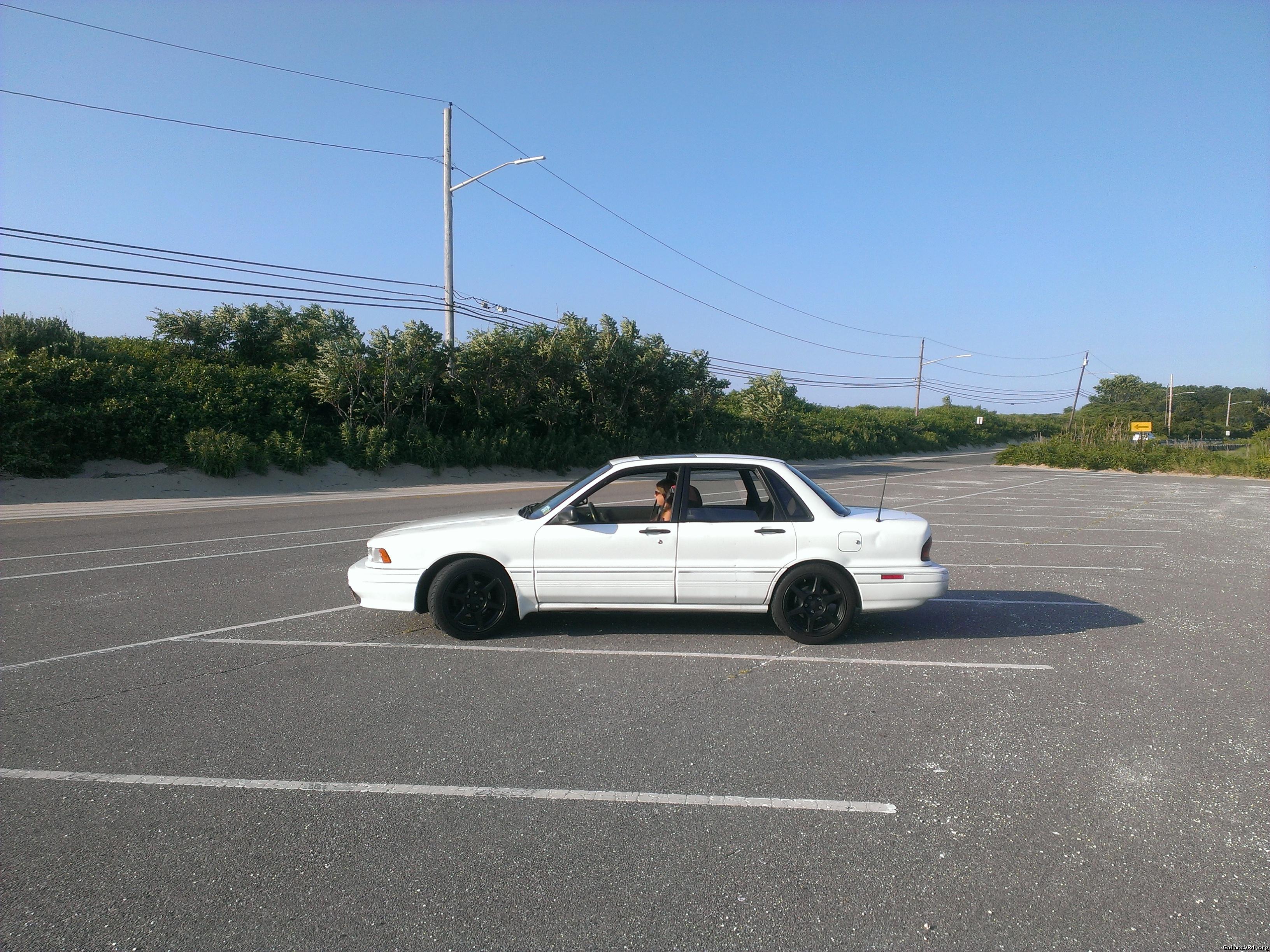

Set this strait an evo 8 Mr spring on a DSM gr2 rear strut with evo 8 upper strut perch looks like this.
And rides well. Getting the fron to ride well at this height is difficult though.. I'm still working on it.
