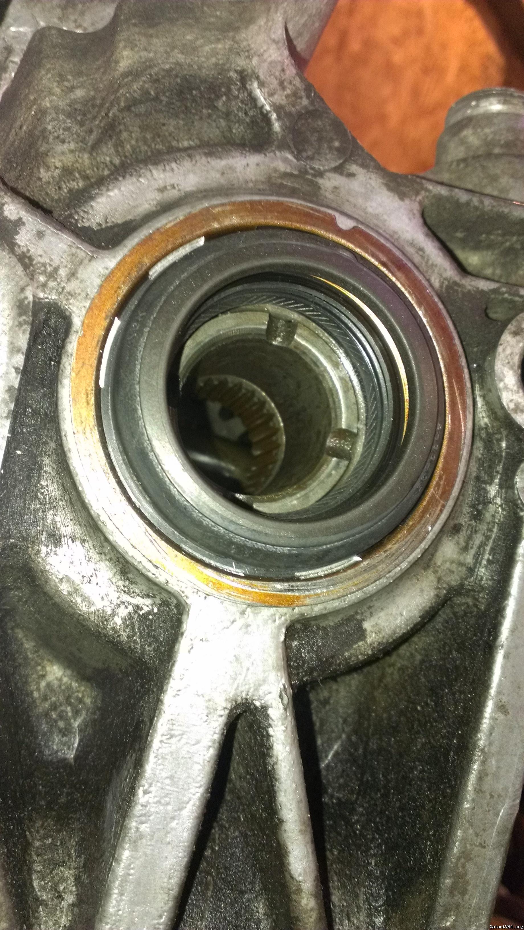

It went in slightly crooked. Is there any way to test the seal without installing the transmission? What can I show a picture of?

ok so your concern was the seal not seating right? as far as this pic it looks ok. maybe have a shot from the side? how it sits on the trans?

Just do it right, replace the seal then you wont have to worry about it. /ubbthreads/images/graemlins/dunno.gif

If you look at the construction on seals, you'll see that you do have some wiggle room as far as getting it straight on. These kind of seals are meant to move a bit to compensate for this. As long as it's not a huge difference then your probably ok. It sounds like your nervous though. Listen to your gut, if it's telling you it's wrong, then it's wrong and replace it for cheap insurance.

I don't see anything wrong with it in that picture. As long as it's not torn and the spring is still in place it should be fine.

Necro this old three to say it does leak but I'm not sure that the seal is the problem. I remember someone saying that the axle half shaft had some special hardware used to install it. I'm thinking I'm missing somthing and the angle is bad. I had two grade 10 bolts and 2 lock washers holding the half shaft bracket directly to the block. Is that correct?
I pulled the axle out and there's a ton of fluid still in the trans being held by this seal. So I'm going to change it after I drain it but I don't think its to blame for my smallish leak. Found the discussion about ac bracket spacer but I'm still using ac. This is an automatic axle.

Only thing I can see wrong with that, is the seal looks upside-down. There is a hole in the rubber dust boot that is supposed to be at 6:00 for any water to drain before it gets a chance to get past the inner seal. I've seen them installed like that with no ill-effects though, so just letting you know for next time.
As far as the T-case seal, you gotta watch, because some seals are just supposed to be flush, and don't have a step or lip to stop them. So it is possible to press them too far inside. If it's close, and currently not leaking, then you should be fine though.

Yes the hole should be at the bottom, and it is but the first picture was taken at a weird angle.
The reason it leeked was the carrier bearing bracket IS different between the auto and manual. I am trying to find the right cv boot to use the manual intermediate shaft, the one that came with the transmission swap.
