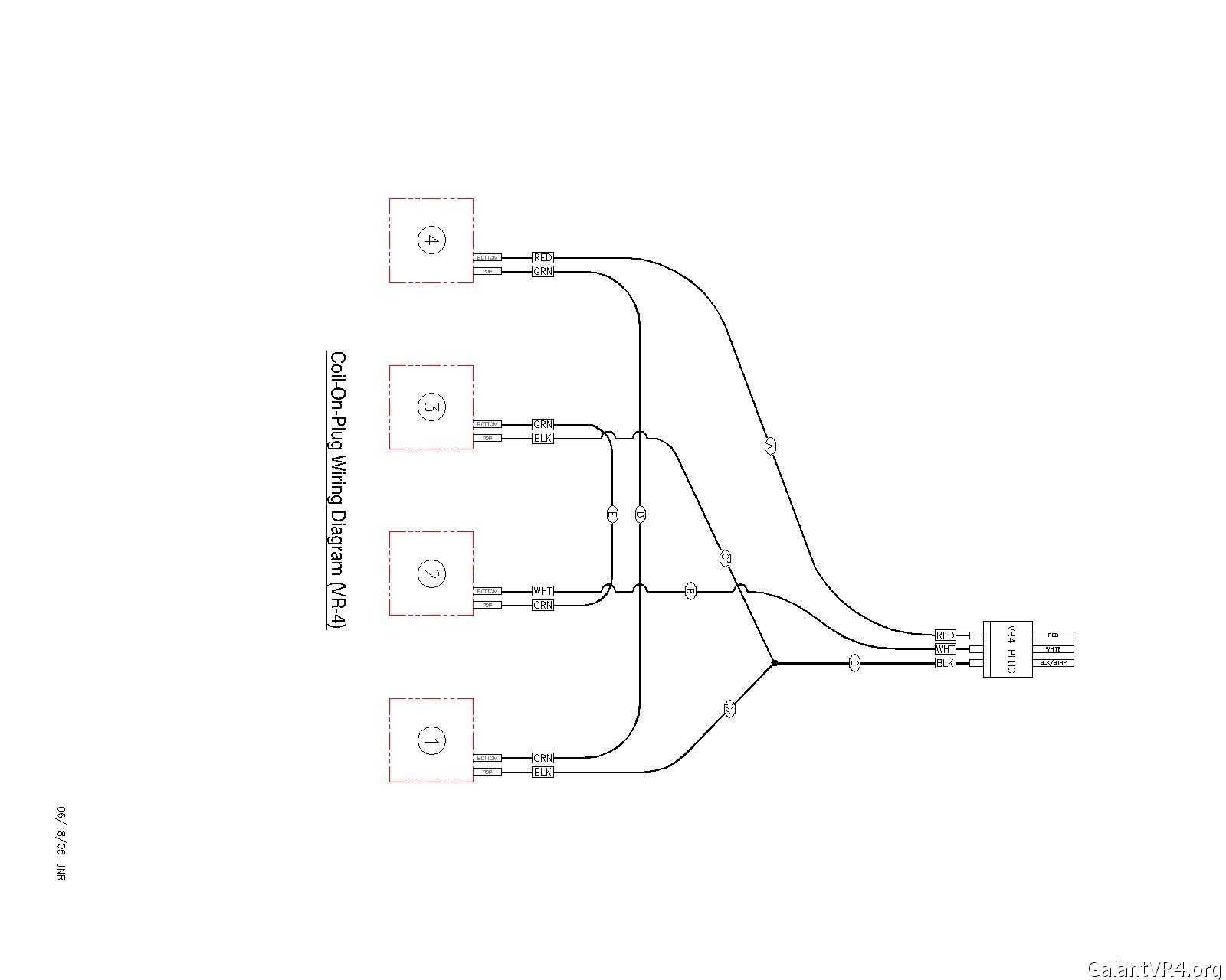

The coils being right on the plug, give you less chance of electrical loss and I would *think* 4 individual coils would work in a stronger (in general), consistent spark than one, splitting into (4), even with our waste spark setup (fires on alternate cylinder, even when not needed; 1-4, 2-3, IIRC).
You only need the coils, a way to mount them and wire them up, per Curtis' diagram (I posted one of his here somewhere) and that's it. The signal travels the same, except it gets 'split' into the pertaining pair of coils, similar to the way the oem did, but with no spark plug wires (now uses a spring instad between coil and plug).
I can say they work great, As a power adder by itself, maybe not so much, but it just gives a better driveability factor that enhances modifications moreso, imo.
Also, you can use the mating connector from a spare coil and add this to your harness for a 'plug and play' solution (I think Iceman sells these?)...I just need to pick up the (Dodge) OEM coil harnesses one of these days (I made my own for now, but want to do it right soon).
