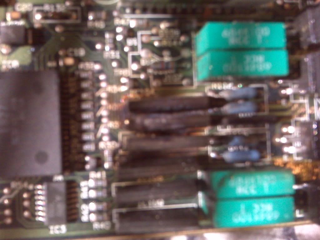

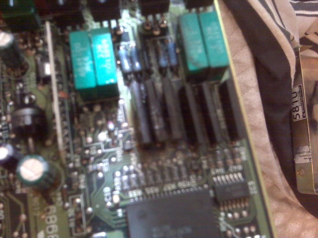

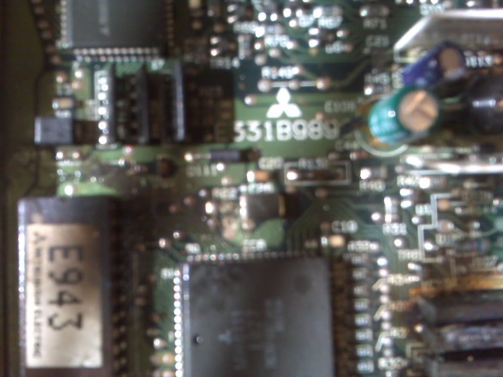

ouch... my ECU is toast i think /ubbthreads/images/graemlins/uhh.gif sorry for the super crappy cell phone pics, but it's the only camera i have:
i'm guessing that one in the middle has like... exploded or something /ubbthreads/images/graemlins/banghead.gif

You either have a bad isc, or enough acic leaked onto the isc coil b trace and fried ic 105. Before you install another ecu check the isc, you could do the same thing to a good ecu. This is donnie up in surprise, i'll buy that blown ecu off you, text me.
As Donnie said, what you are seeing is the results of either a bad ISC, or damage from the 47uF cap that was leaking. Its not what is causing the chattering though. It looks like someone put new caps in your ECU, but you need to make sure that they soldered the leads of the caps to both the top and bottom of the ECU. Your pictures are too fuzzy to tell if the acid damage traveled to the area of IC110, that vertical ceramic board on one side of the caps.
Welcome.....to ECU hell......Get it fixed/replaced ASAP. Mine burned out while the new one was in the mail. The lifespan of that ECU is measured in minutes/hours until you get it fixed.
