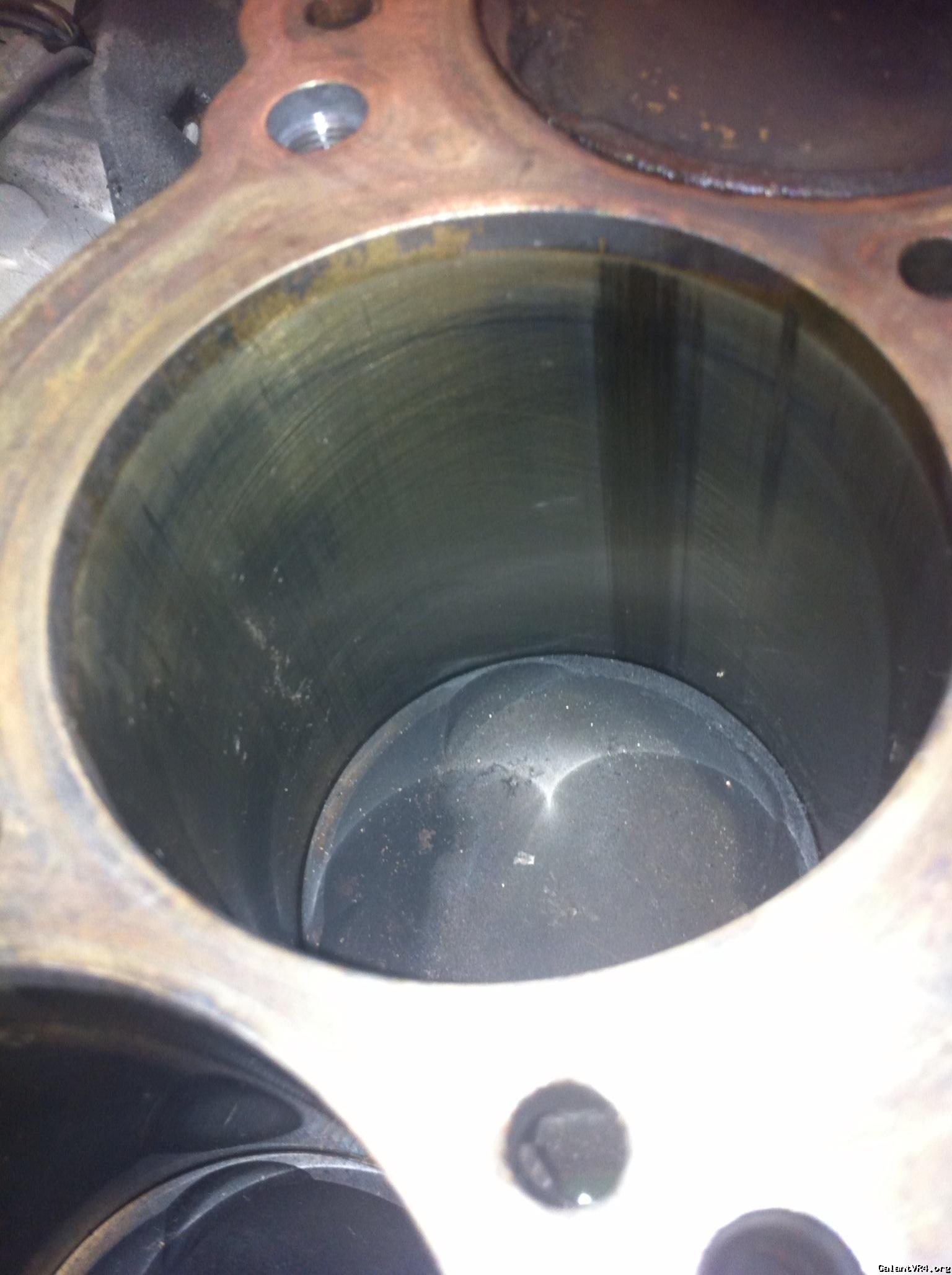

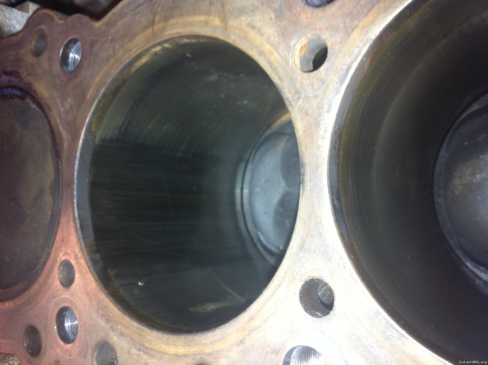

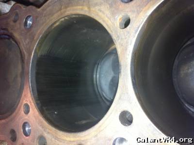

Beat me too it. If your getting wear like this on the sides of the cylinder then you have excessive thrust bearing wear. Think crankwalk. If the lines were on the load sides of the cylinders its a bit more normal if your running bigger power. The sides though, bad bearings. Better check the rods and see if they have excessive side wear and also on the crank.
Pending on the condition of the cylinder, ie taper, out of round and surface quality sometimes a good hone can clean it out. If you can't catch it with a nail you MIGHT be ok. If your making stock power, you don't have to have a perfect engine to be ok. It could get by. Otherwise any mods and you'll want it done right.
