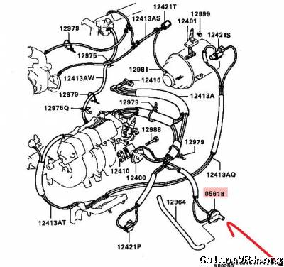

Hey everyone, first post but long time lurker. I have a JDM vr4 and I accidentally broke the vacuum stem off a vlave while changing the fuel filter the other day. i can't seem to be able to find a replacement anywhere. The dealership couldn't even tell me what it was, I have only found a few dead links to old slavic site ads. I have searched everywhere I know to search and cant find anything. If someone here could get me in the right direction that'd be great!
Its been a bit difficult getting some "special" parts here in the states. I also need a gas cap, because apparently that's different.

That's the Evap Purge Control Solenoid. It runs off a vacuum line from the top of the intake manifold and vents the fuel tank to the intake tract when boost is present.
Part Number# MD001918.

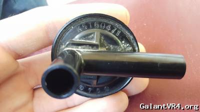

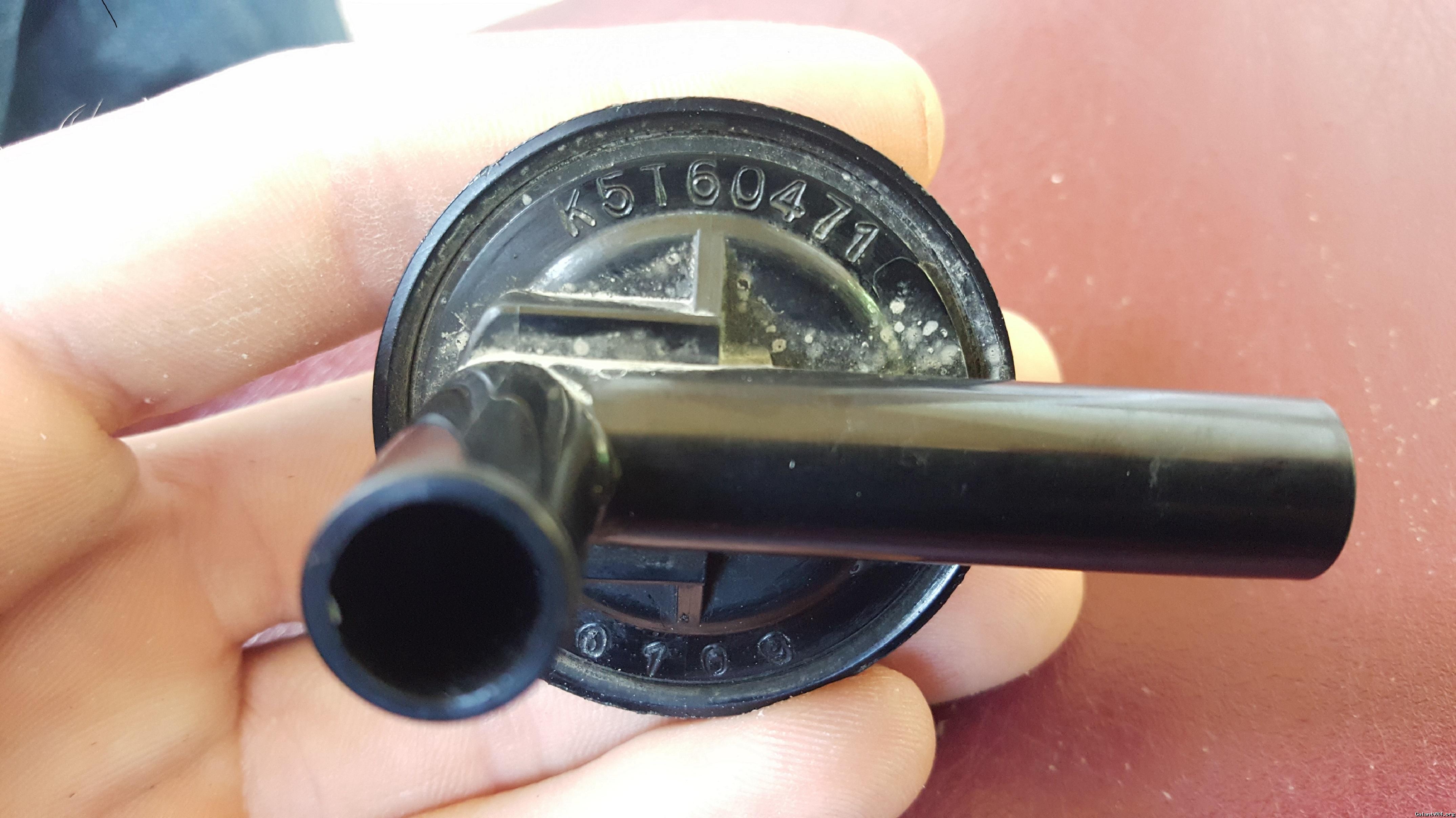

Evap canister purge valve. Mine has K5T60871 stamped on it. P/N: MD011227
Post a request in the Parts Wanted section. Somebody has this and the charcoal canister sitting in a bucket in their garage. You could also use JB Weld (epoxy) to glue the stem back on. The valve opens when you start the car, to draw gas fumes accumulated in the charcoal canister into the intake for burn.

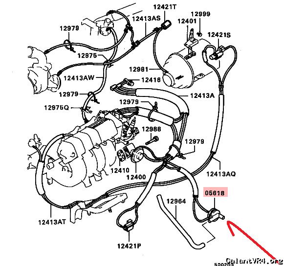

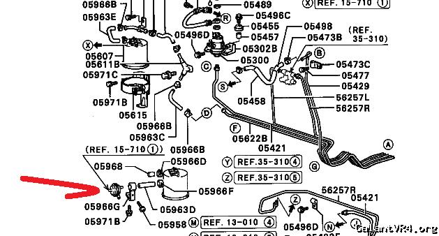

I see the hose attached to the outgoing portion of the valve, as shown in the pic where the valve is between the intake and the firewall, but I don't see where it is supposed to route into (part, nipple, nothing!).
My C53a has this valve right at the charcoal canister but it used to have a foam sock on it or something, but it has never been routed into anywhere. Was it possible it routed back into one of the nipples on the intake snorkel right after the MAS?
I do have a smell of gas in my engine bay, and haven't got around to finding out how this was routed. I don't have a leak, it is only there on purge function.
I haven't used a stock 4g61t snorkel in years, and now have a 2G snorkel in its place.
