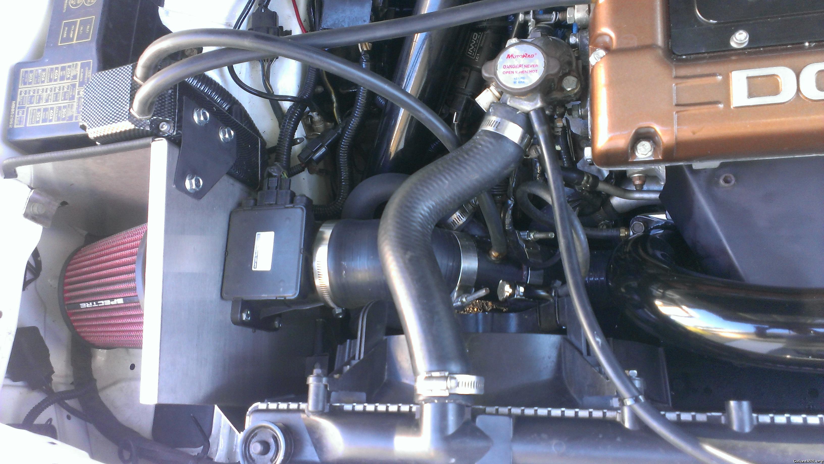

Found a spot for my oil catch can and made a bracket. Tightened up my intercooler piping and installed a new gasket at the turbo. I added a turbo smart mbc to the wastegate line. Its set to around 17psi. Was thinking I needed a bigger turbo after driving around today, but after the mbc I think ill hold off. At least until after suspension is complete. She's really fast as is.

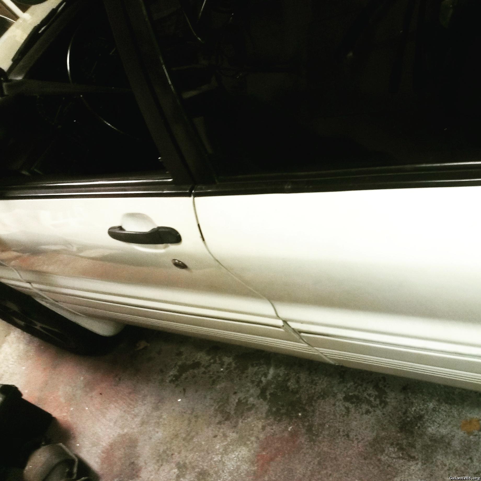

Been super busy lately but I got s few hours off today and swaped the rear driver door on the old gal. I had a big dent in the top and the window trim wouldn't fit on right.it realy irked me. Problem solved... Too bad swapping everything over to the current door took almost 6 hours.

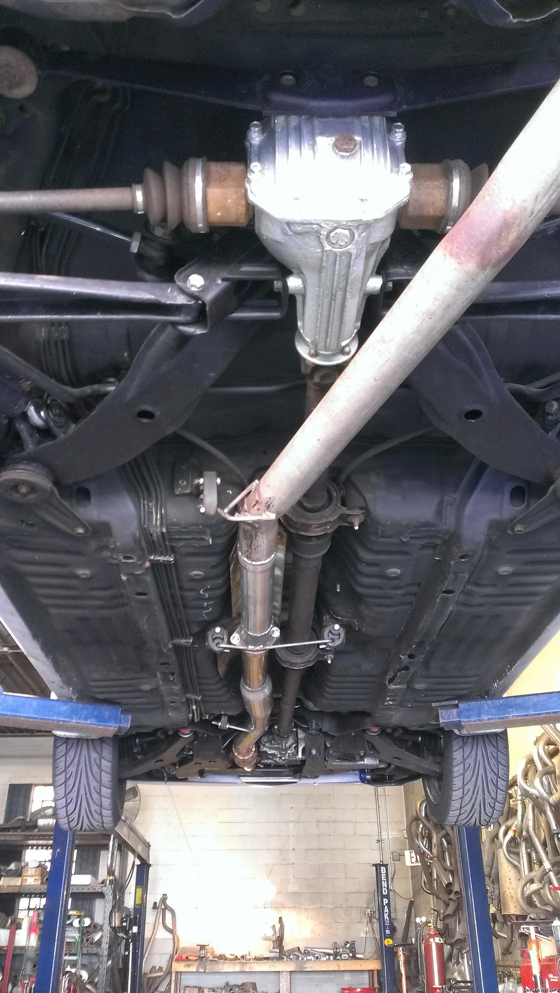

So this car has been on Jack stands since January 20th.I finally got my 4 spider center differential last week. Thursday I shimmed and assembled the transmission. Today I bolted it in. There were some issues with the dowel pins and the rear bolt hole was stripped out on the replacement transmission case. Always Chase your holes with taps before you do this. I had to pull the trans back out to put a coil in the back of the case. One of the mount holes was completely stripped out too. Had to go with a 5/8x20 bolt because the hole Was so bad. Fixed some minor issues with the shifter cable bushings. I ended up using a thin. .042" washer as a shim under the pivot ball and swapping back to the standard bore slave cylinder. It's still the 3kgt style thought. Axels are in and the exhaust and transfer case are bolted on. I'm going to finish it up this week hopefully. I'm pretty sure my last transmission broke because the engine mounts were wrong. Added stress on the output shaft cracking that beading race like it did. Hopefully all that is behind me now. I have new reccaro knockoffs to install as well as ultra racing front fender braces. Would also like to set up the wires to activate a dual stage bov actuator. It never ends.

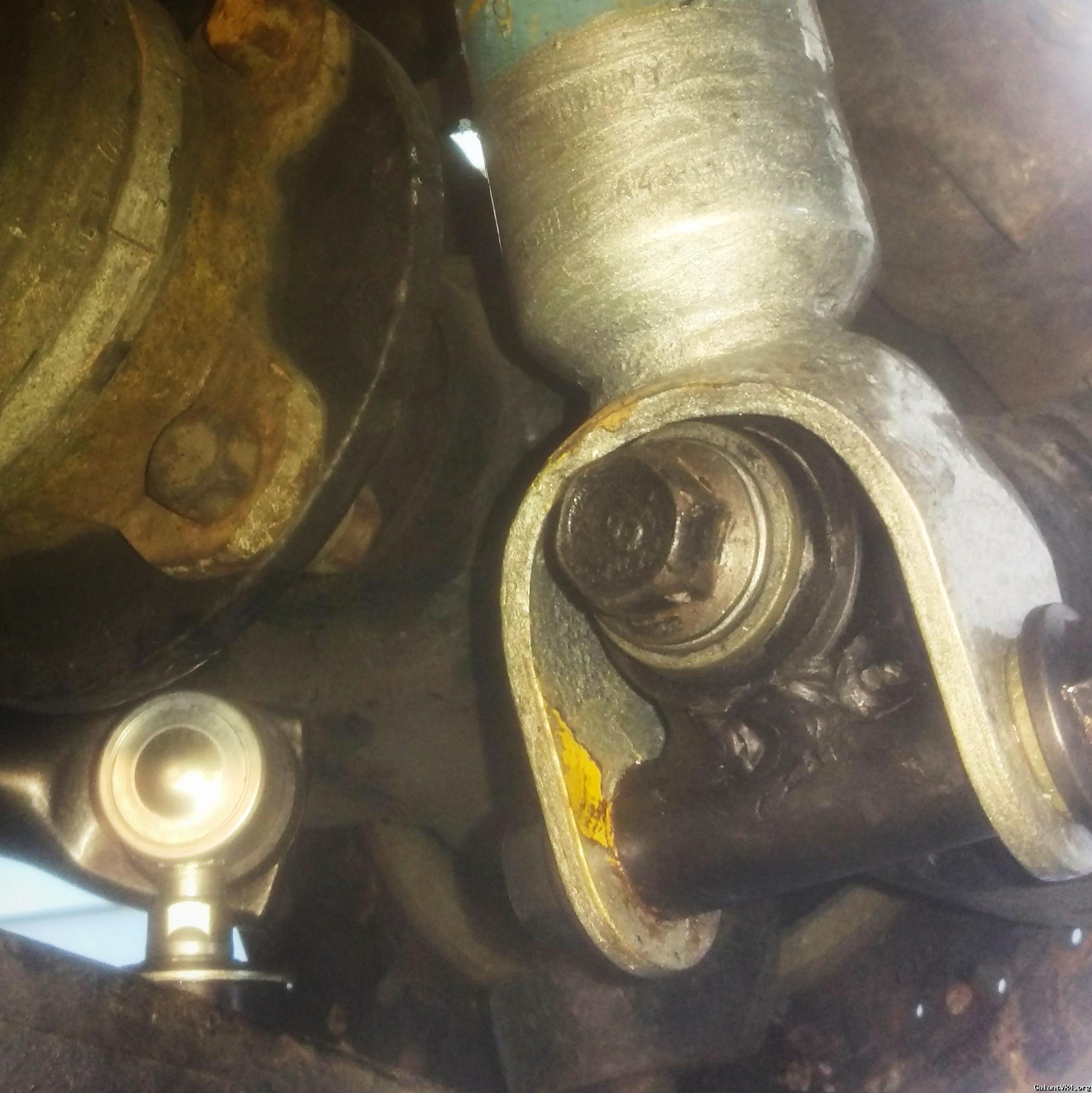

Been a while since I updated this. Mostly working on my turbo mighty max swap. I'm Finally getting around to install some parts I've had around for too long. Here's a new solution for evo rear suspension swaps and a 1" ST sway bar installed.
Soon to come rear lightened bumper support and a nice fresh hood and rear bumper cover.

Still running strong. Bilsteins ride nice. Turbo smart bov I installed is So much better then the modified stock one. Wish I knew how Many issues that thing was Causing. It’s bigGet though and I really need to swap out my stock rad fan now for proper clearance.
Powder coated the evo 8 rims added New tires 235/45/17. Scored some 3kgt brakes today and will be Adding Them and cobra 13” rotors next week. Installed some vent shades I had sitting around for almost 3 years. And used the aluminum seat brackets from the group to reinstall my aftermarket seats for a better fit. The seatbelt bracket is just kind of floating between the console and seat though. I guess that usually bolts to the track on an evo seat?
