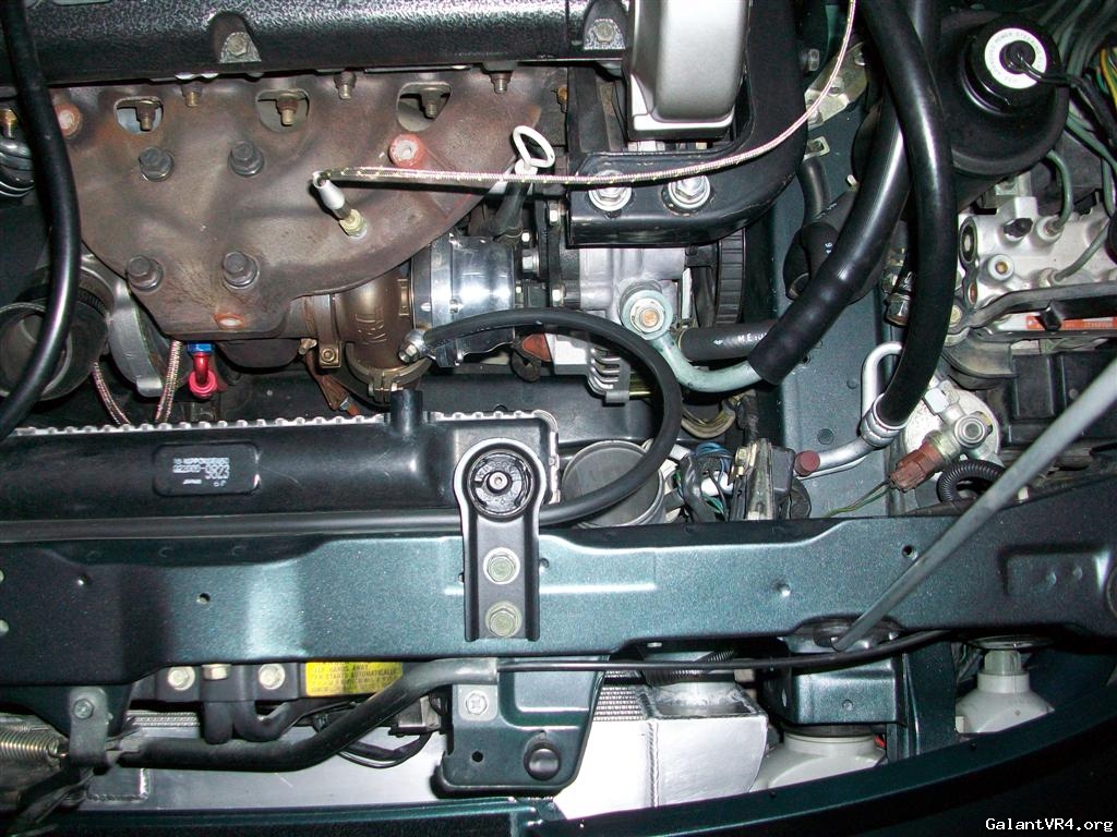

Here's a top-down pic of what I'm dealing with:
You can see that the PS pump, wastegate are in the way and to get the coupler off the intercooler inlet I had to pull the headlight, ect.
Anyway, this just isn't something I want to go through on a weekly basis by using a chain store alternator with a lifetime warranty that we all hear such good things about. /ubbthreads/images/graemlins/hs.gif

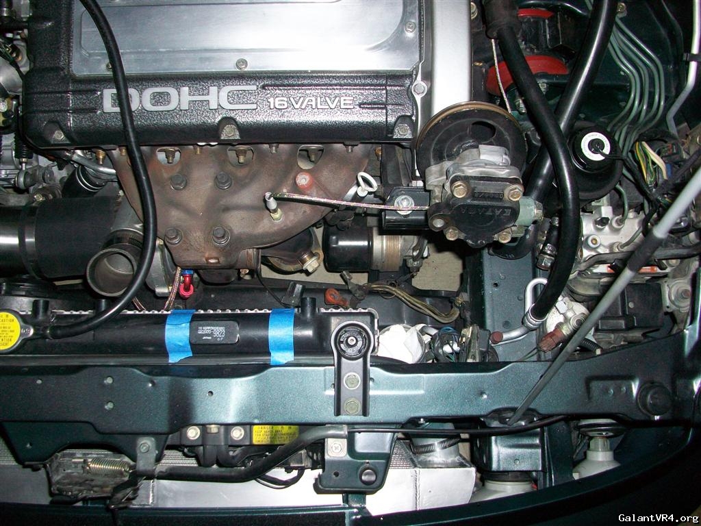

So I ended up needing to remove the bracket that holds the PS pump on as well. I couldn't squeeze that bitch out between that bracket and my intercooler inlet pipe for the life of me.
Goddamn thing is out now:
