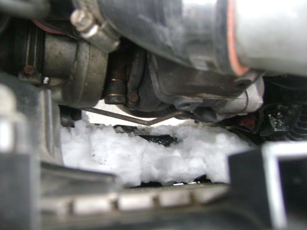

one lasted only 6 months because of this:
ugh..hate winter. anyways, previous one lasted about 2 years. I didnt remove the heat shield until i put that^ one in. I want the relocation kit but it seems much easier this way. The one I currently is holding up so far, also a remanufacture.

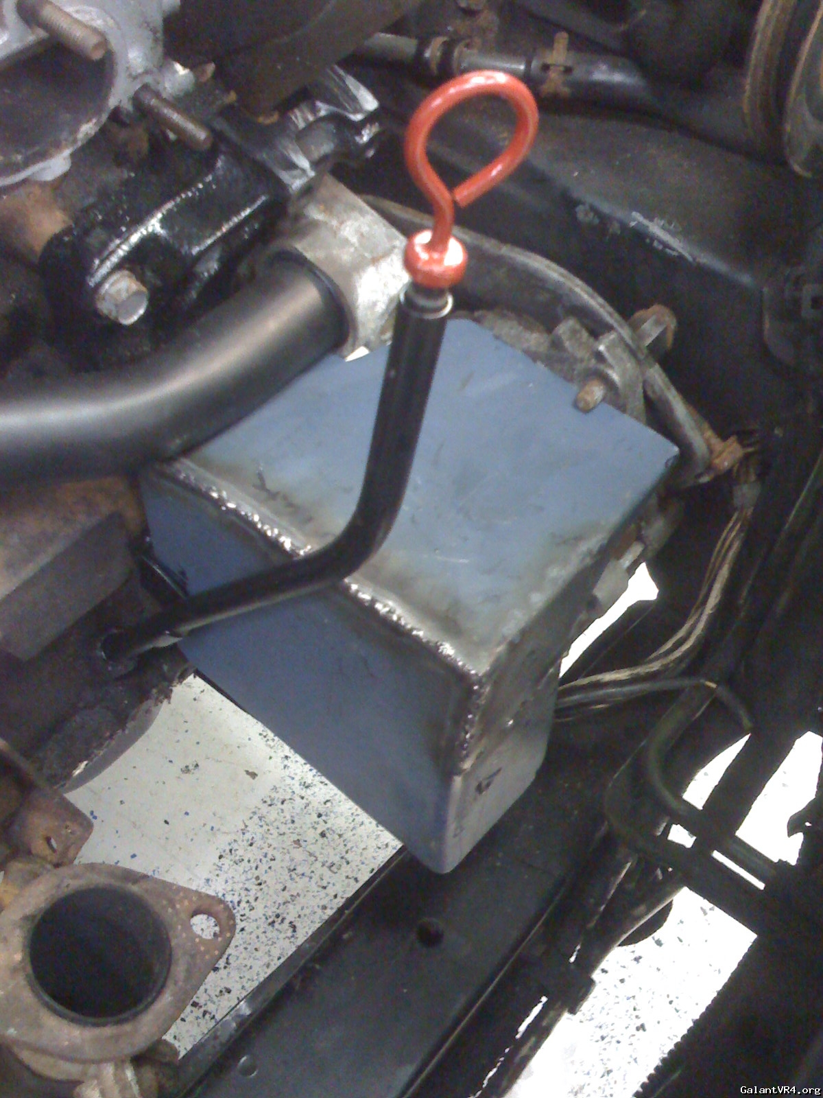

I made this to prevent the heat from the downpipe killing the alternator. Heat and electronics don't get along. Hopefully it extends the life of the alternator.
