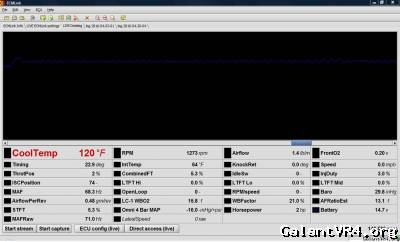

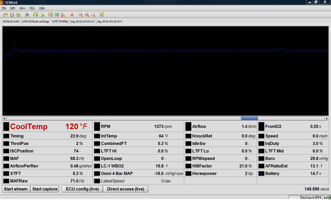

Okay, car is up and running. Dealing with tuning issues (I am not seasoned at this sort of stuff), but the volt gauge tells me that things are where they are supposed to be. With lots of loads the output drops in voltage .. but I need to first ascertain at what RPM the engine is at and with proper AFR (not relevant like RPM for proper minimum operation).
Got a laptop situation sorted and I can now look at long term prognosis of the alternator and other components. So far, things come down to proper temp with fans in operation, next up is actually putting stress on the system to soak it and see what happens. Driveway queen for the win, at the moment. E-test is next. At least they have now waived the fee because it was a tax on a tax.

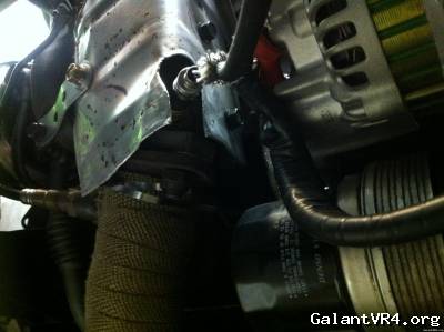

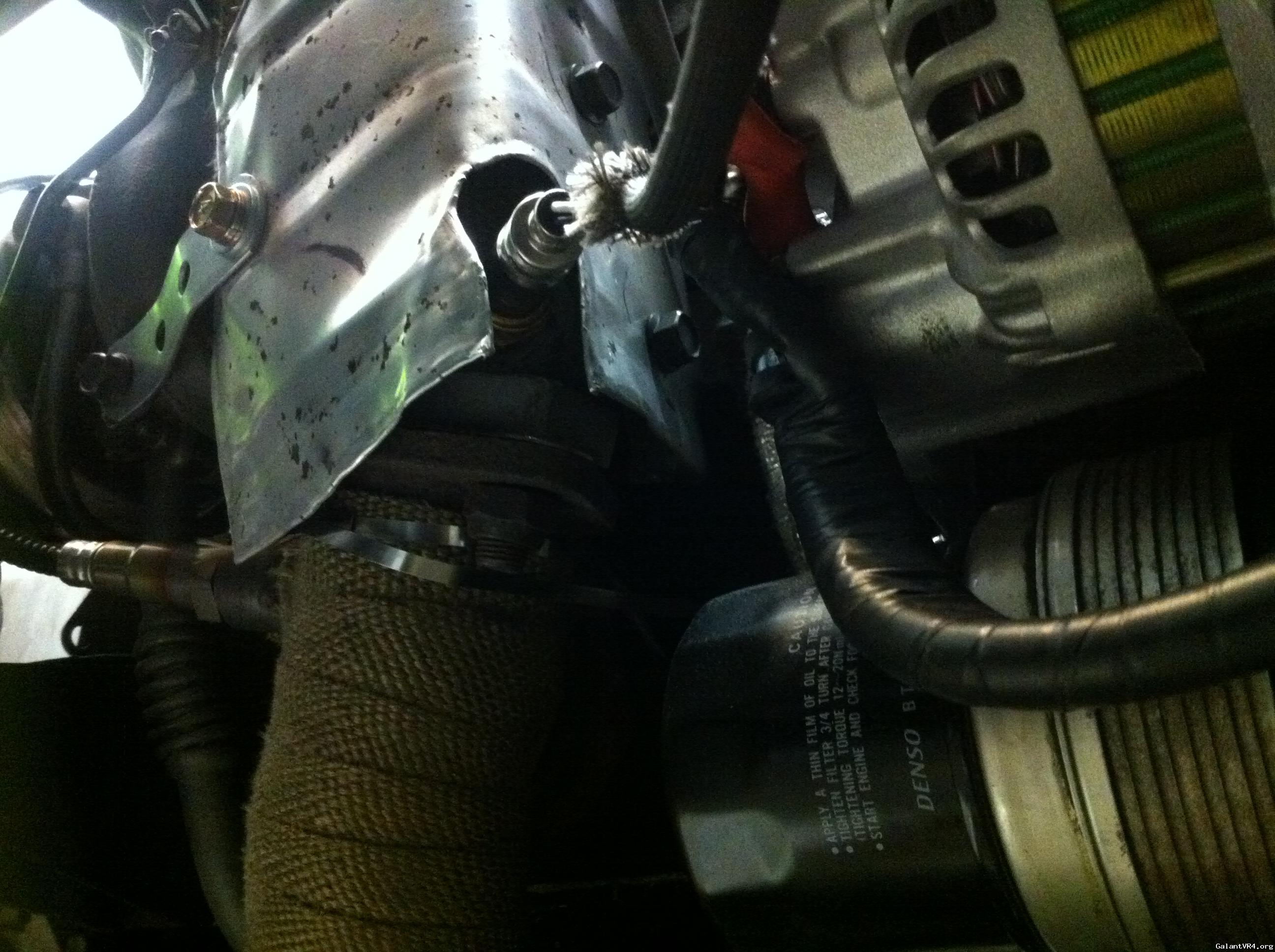

Oh, I should add that I have wrap on my 02 housing (2G style cast), and the downpipe right past the oil pan, with custom muffler/resonator body heat shielding fashioned into exhaust manifold and 02 housing shields. New gasket from Vibrant Performance products was installed this AM and that solved the leak I had at the 02 to downpipe mating area with my solid stainless gasket. Indestructible yes, maleable no. 'Nuff said.
Now there are no stray exhaust gases nor excessive heat that can migrate its way towards the alternator. Time will tell.
Looking at that picture, makes me want to add another shield from the lowest heat shield bolt near the alternator, down to the bolt that keeps the coolant tube held to the block. That tab doesn't preform much function anymore, so maybe I can make another duct of sorts, so air blowing by the bottom will draw something out of the funnel as it were.
