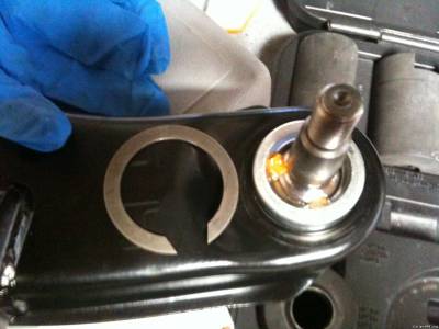

Before I go trying to smash this thing on out of frustration, can anyone tell me the proper way to get this clip on? Is there some tool I can get to spread it? If so, what the heck is it called? /ubbthreads/images/graemlins/banghead.gif

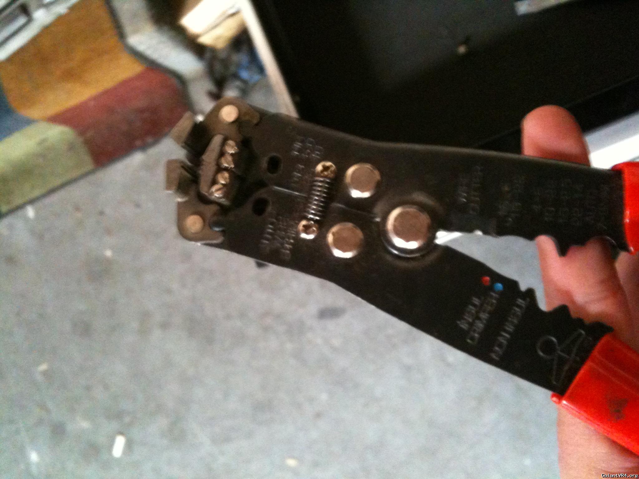

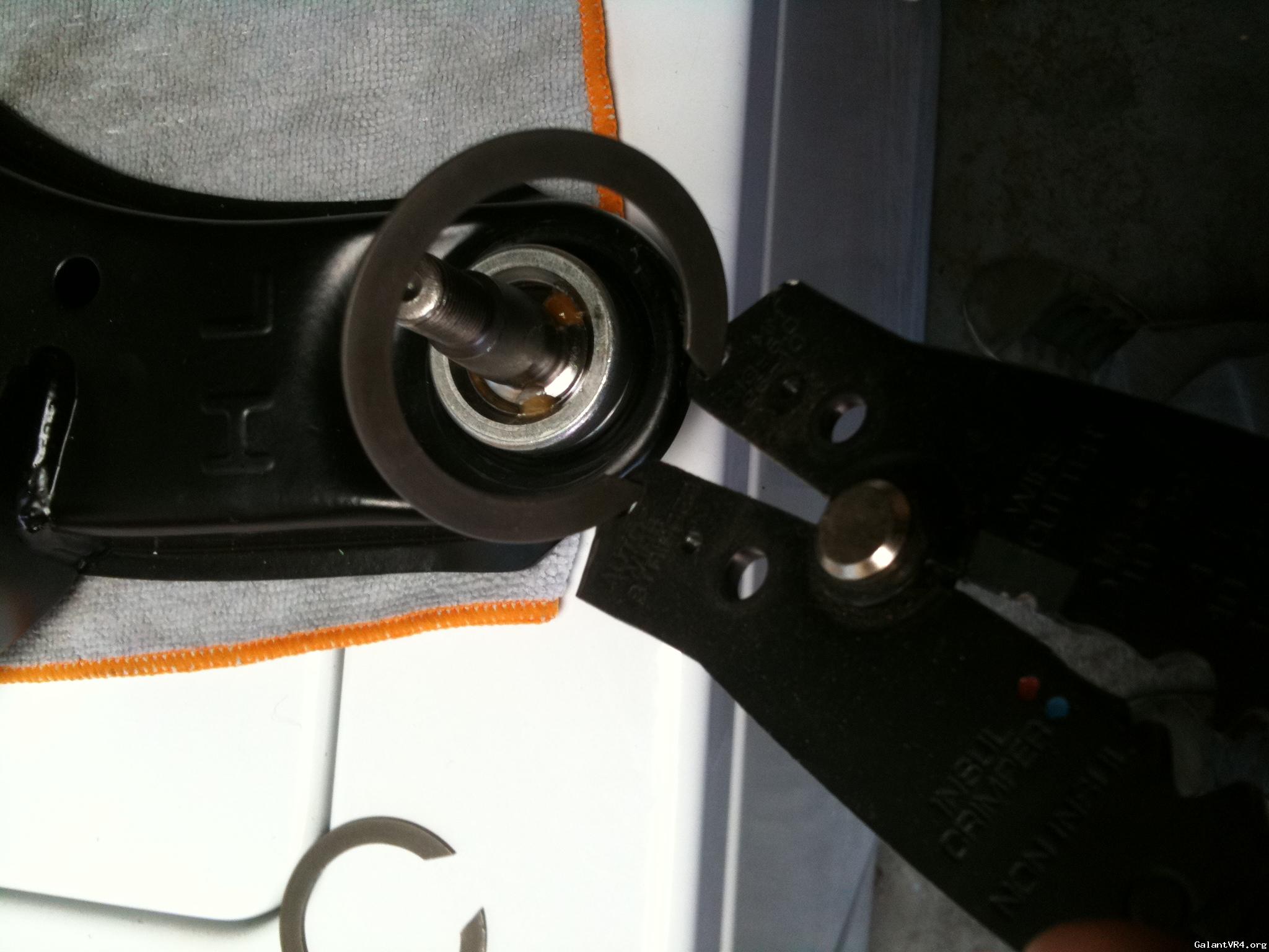

Snap ring pliers weren't helping any, so I came up with a plan B. Build a tool...
Wire strippers...
Take off a few parts, grind down the ends, grind the inside a bit so you can squeeze further and spread the ring wide enough...
Installed both clips in under a minute. DONE! /ubbthreads/images/graemlins/smile.gif

So did it go over okay without getting stretched? That is the problem with these things, you can't over expand them. Is it tight around the ball joint?
moduleunknown
Oct 30, 2008
193
Elk Grove, CA
Yup, it's on tight. Spread it just enough to slide down the side and it snapped right into place when it got to the groove.
