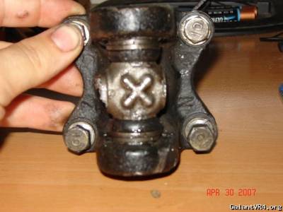

I'm trying to replace the u-joint in 934 and can't seem to locate the specific u-joint. All of the part stores that I called today claimed that they didn't list one. Does anyone know of a part number I can cross reference to find one or know of a place I can find one. I know JNZ offers it in a rebuild kit, but I don't want to wait for them to ship it and would like to get it tomorrow so I can reinstall the t-case.

Does this work? /ubbthreads/images/graemlins/grin.gif
The cheapest way to do it is buy a yolk replacement kit. It comes with a yolk and u-joint for less than the price of a u-joint by itself. I'll dig up a box with part # for you tomorrow. You can call the shop if I haven't posted it by the time you need it.
