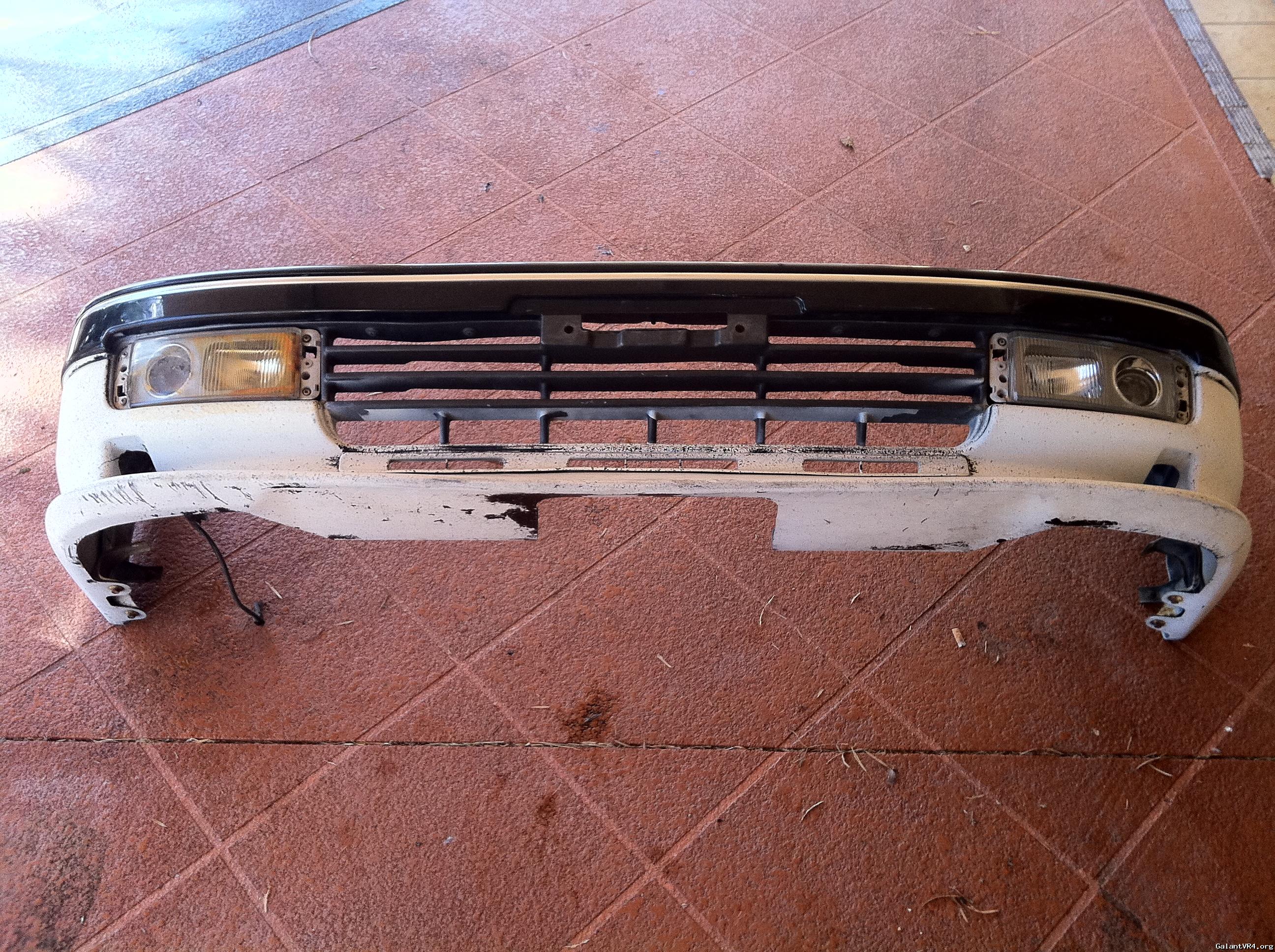

There are a few things that need to be drilled etc etc but it is all pretty straight forward.
Just pull the old bumper off including the reinforcement. Drill out the holes and bolt on the L brackets then install the new bumper!

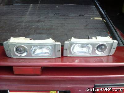

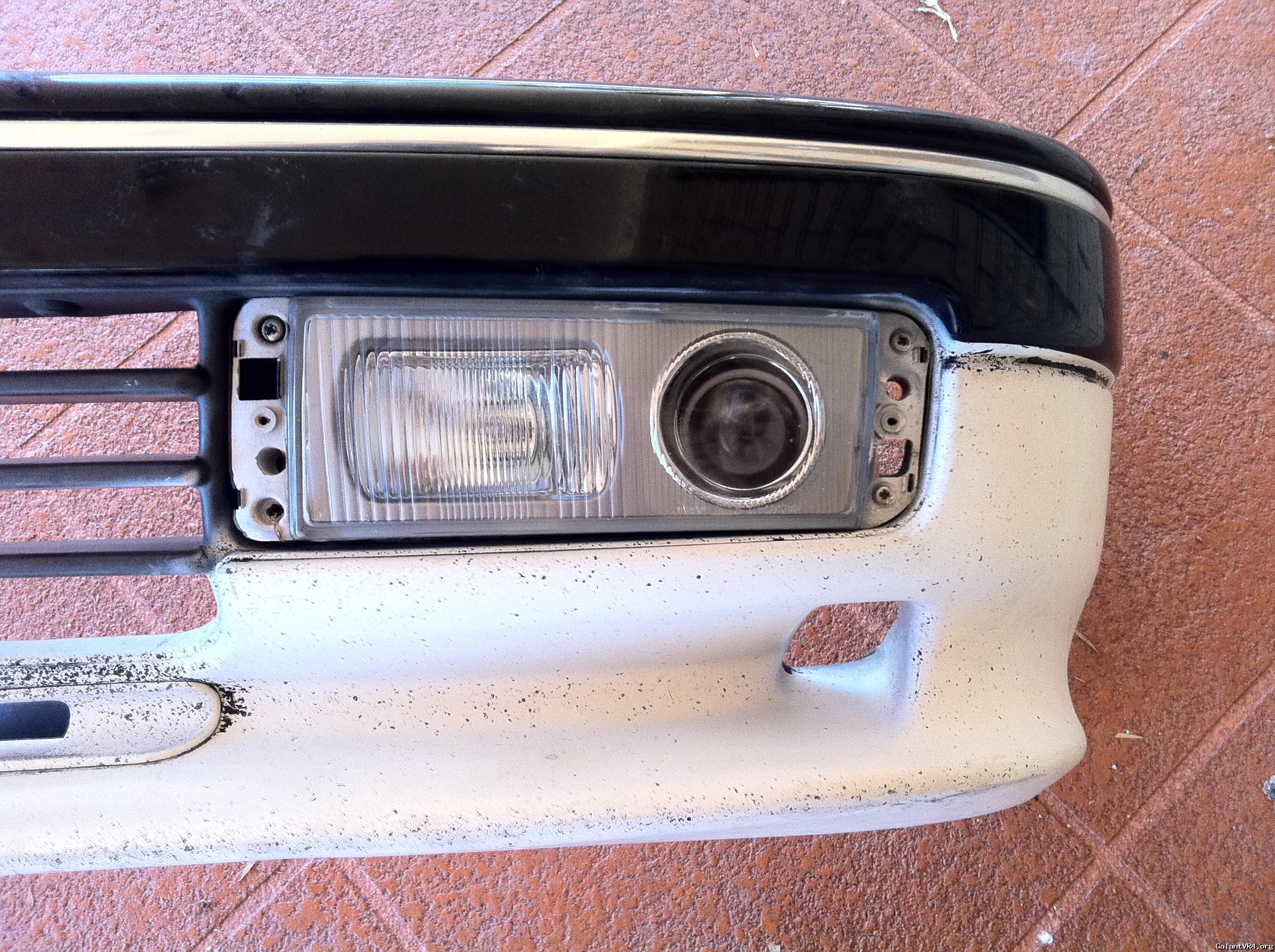

Thanks, but i need help with all the lighting electrics. I have got a like new set of facelift fog lights coming and im confused on how to wire these up as to the Aus spec only has one fog light switch. Is their an extra switch on the Jap spec galants? i also was checking out my headlights on my vr4 and to my surprise they have the city lights in them already but have never worked? have they been changed over. With my corner lights, to set up as the indicators do i grab the indicator wire from my original bumper and cut into it for my corner lights to have the blinking circuit and then put a 5w orange bulb inside? I can make those L brackets for the bumper no worries. Just need help on all this wiring.

I wired the outside ones to come on with the stock switch and wired the inners to come on with high beam Brock.
I also used Gsr Galant orange indicators. I just grabbed the indicator wire and extended it it a bit to fit.
I think that the clear Aussie corners take a small bulb? Much less hassle from cops with the orange ones in there!

Yea thanks, thats how i was planning to do it but just checking if there is a switch for the spots on the inner because i thought it was compulsory or else its illegal. I'll chase up some amber corners for it, i think they look better.
