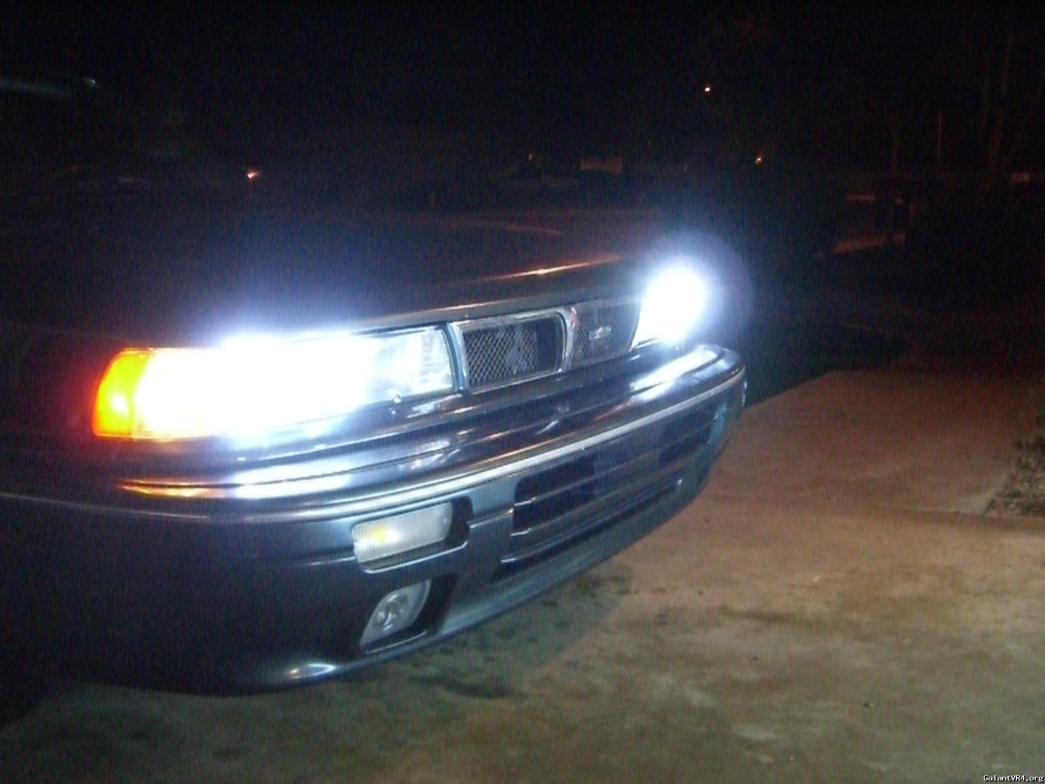

I am currently doing the other side and taking detailed pictures for a how to. I also received my HID's last night so if I can get all this painting done I will install them with HID's tonight.

I order 5K but got 6K. I was worried at first, but I installed one to make sure they worked and it is a nice white color after all.
I just got a retrofit kit from Ebay nothing fancy. I'm not to worreid about the cut off since I am using the 93 headlights. They work pretty well with HID from what I have seen and I don't really feel the need to hack them up for a projector just yet.

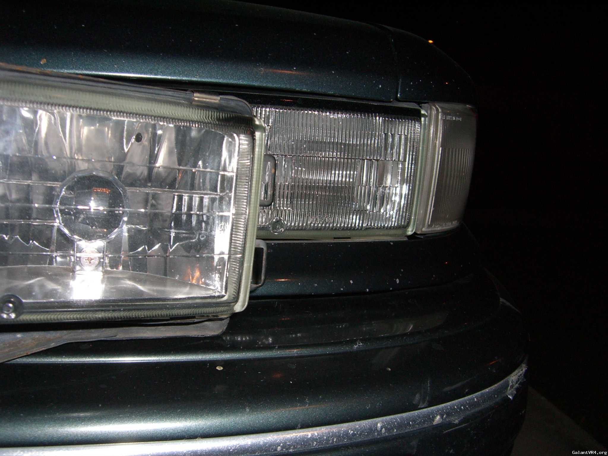

After spending ALL day finishing the other light and fixing the first one I am done. I took a ton of pictures and will make a how to sometime this week.

They don't have the perfect cutoff that a true projector would have, but with the 93 headlights they don't scatter the light everywhere either.
