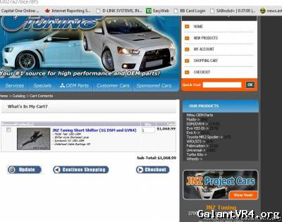

No kidding, i went to the site and it gave me $1068.99 with the shortened stalk.
I know its a typo but its $120 w/o the options?

I think that's an arbitrary number so no one will order it. I'm sure Josh will chime in to correct me if needed, but the pieces they were using new from Mitsu are no longer available, hence requiring finding used ones and sending them in for modification. When I worked there, the shifters were all brand new parts, sadly more and more of Mitsu's stock is getting depleted.

No its only $120ish but you have to supply him the 3000GT shifter to modify. The reason he increased the price (which I assume is to stop people ordering them directly off the website) is that his supply of brand new shifters from Mitsubishi has dried up.
I went on the local 3000GT and picked up a shifter for $30. I just need to send it in to get it modified.

He's indeed correct. We changed the pricing as even though we mark in bold; "Availability changes. Please call before ordering" (which was formerly in red, bold font 4 times the size of the regular text) we would continue to have people order them through the website and send payments.
We figured that the only way to get people to stop ordering them erroneously just through the website was to just raise the price to some astronomical level.
The only other option was to just remove the listing entirely, but that would prevent us being able to explain to people that we *CAN* still make them, we just don't have a good supply of two of the base parts we modify to use.
