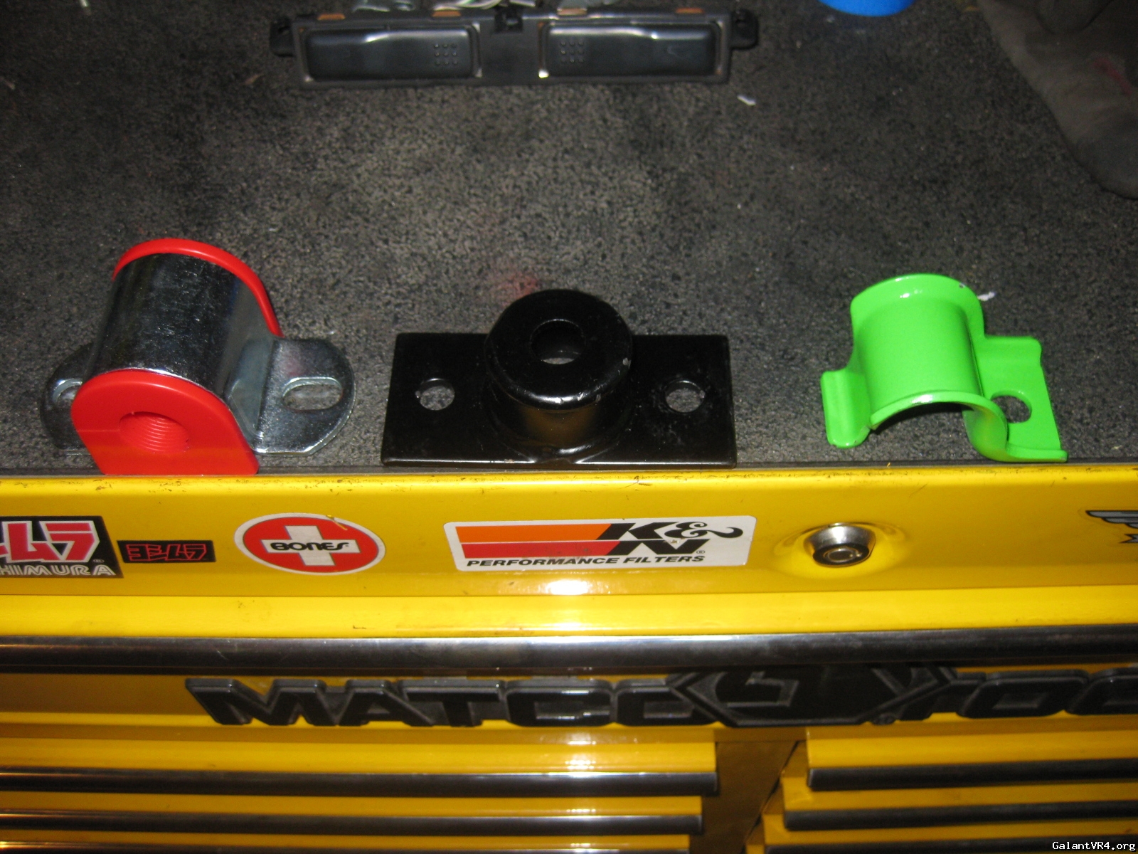

so im gettting ready to install my susprnsion tech sway bars and as of so far the front dosent look like its going to fit. i was wondering if anybody has put these in their car and if they have installed pics.

here is my issue the green is the factory bracket the silver beinf the new bracket and the black came with the new front sway bar.
so its obvious that the stock bracket has a "hook" to hold it in and a bolt
and the new one has two bolt holes in it so thats an issue and i dont know what the black bracket
im loosing my head please help me

The ST front sway bar works in addition to the stock bar, not replacing it. The stock bar you leave where it is and the ST bar bolts underneath the crossmember. The black bracket uses the bolt that goes into the rear of the crossmember (rear A-arm mounting point).
