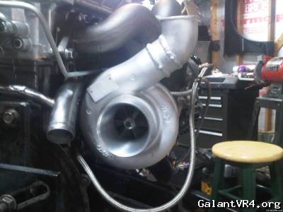

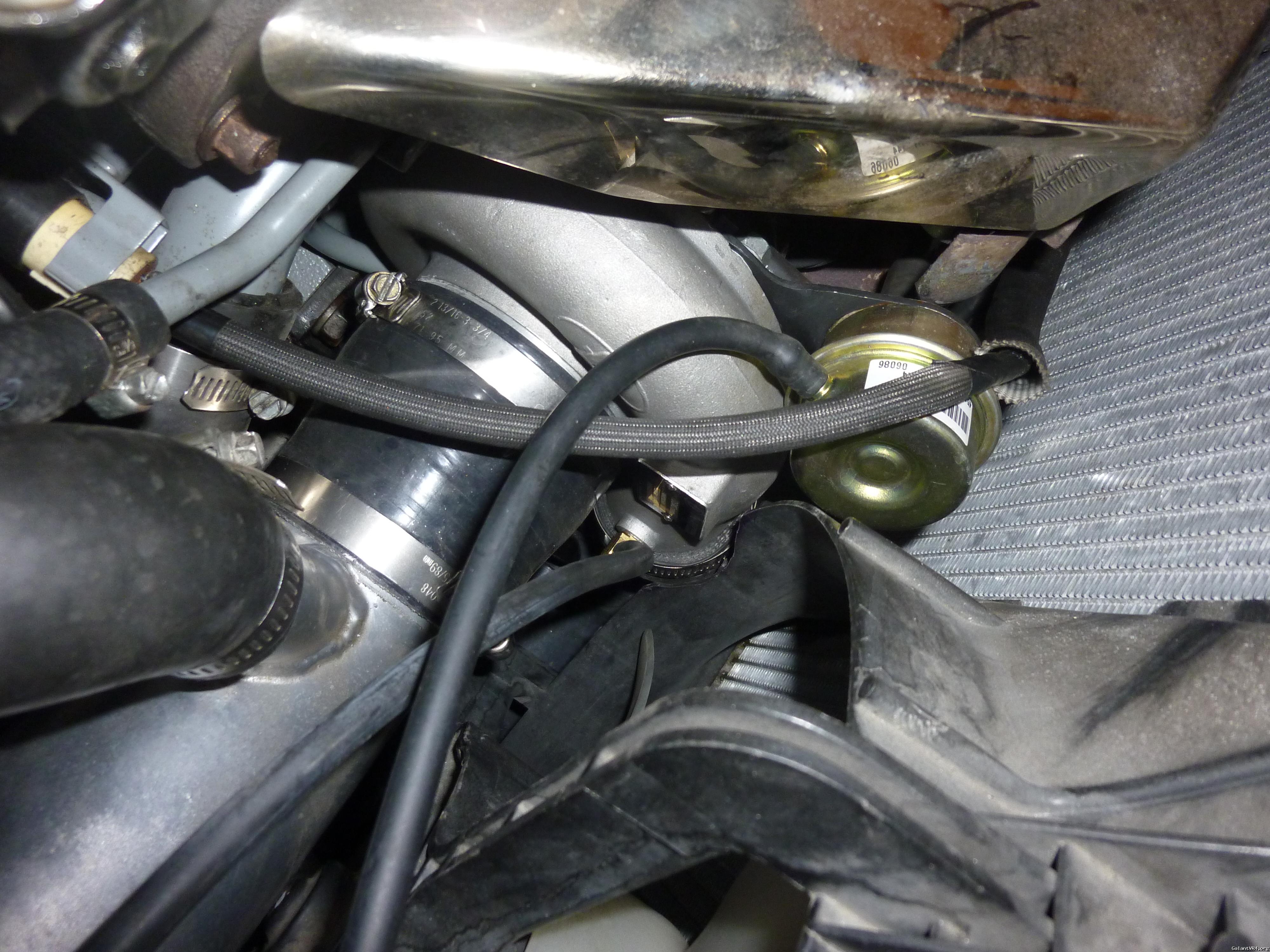

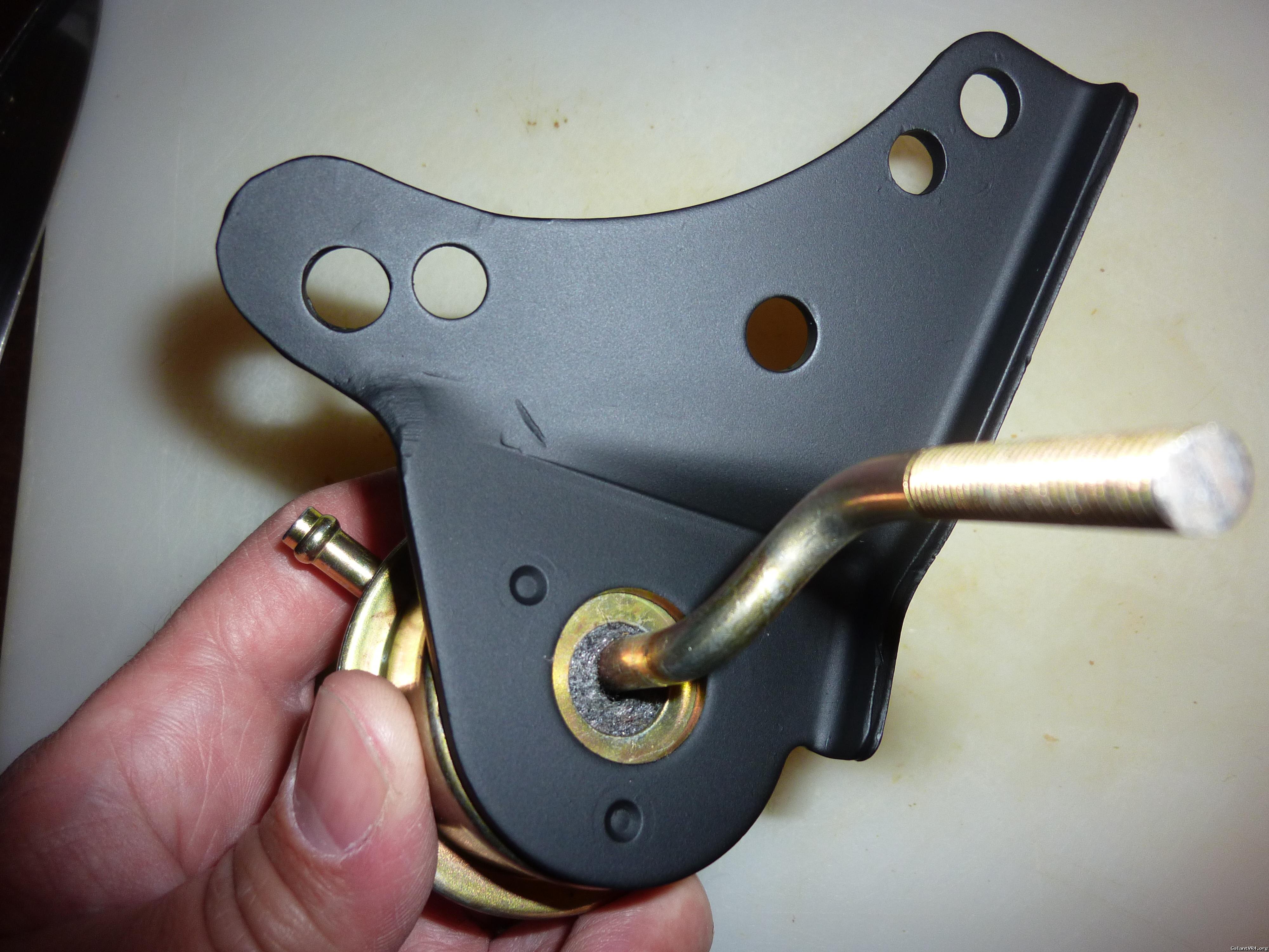

Did you have an issue with the comp cover pointing directly on the front motor mount? I couldn't even get a 90 degree coupler on there. I ended up clocking the cover about 12-15 degrees and modifying the wastegate actuator bracket. I'm sure FP will say I voided the warranty, but it wouldn't fit otherwise. Are the 1g motor mounts different? For a plug & play turbo, this install is more time consuming than I expected.
Mine is externally gated, so I can't help you there. I clocked the comp housing considerably to better suit my piping. I also had the comp housing modified with a weld on elbow.
The front mount bracket on a 1G is different though, would probably give you about a half inch extra to work with, but that info is useless because you have to use the galant bracket.
11,982
Back when I had mine, the only issue was that I had to clearance the water pipe to fit the compressor housing. I also had mine clocked upward like Justin and used an external wastegate. No need for a smaller radiator. Hell, I even used the stock radiator fan with a 3" intake pipe.

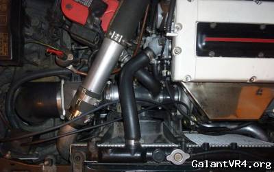

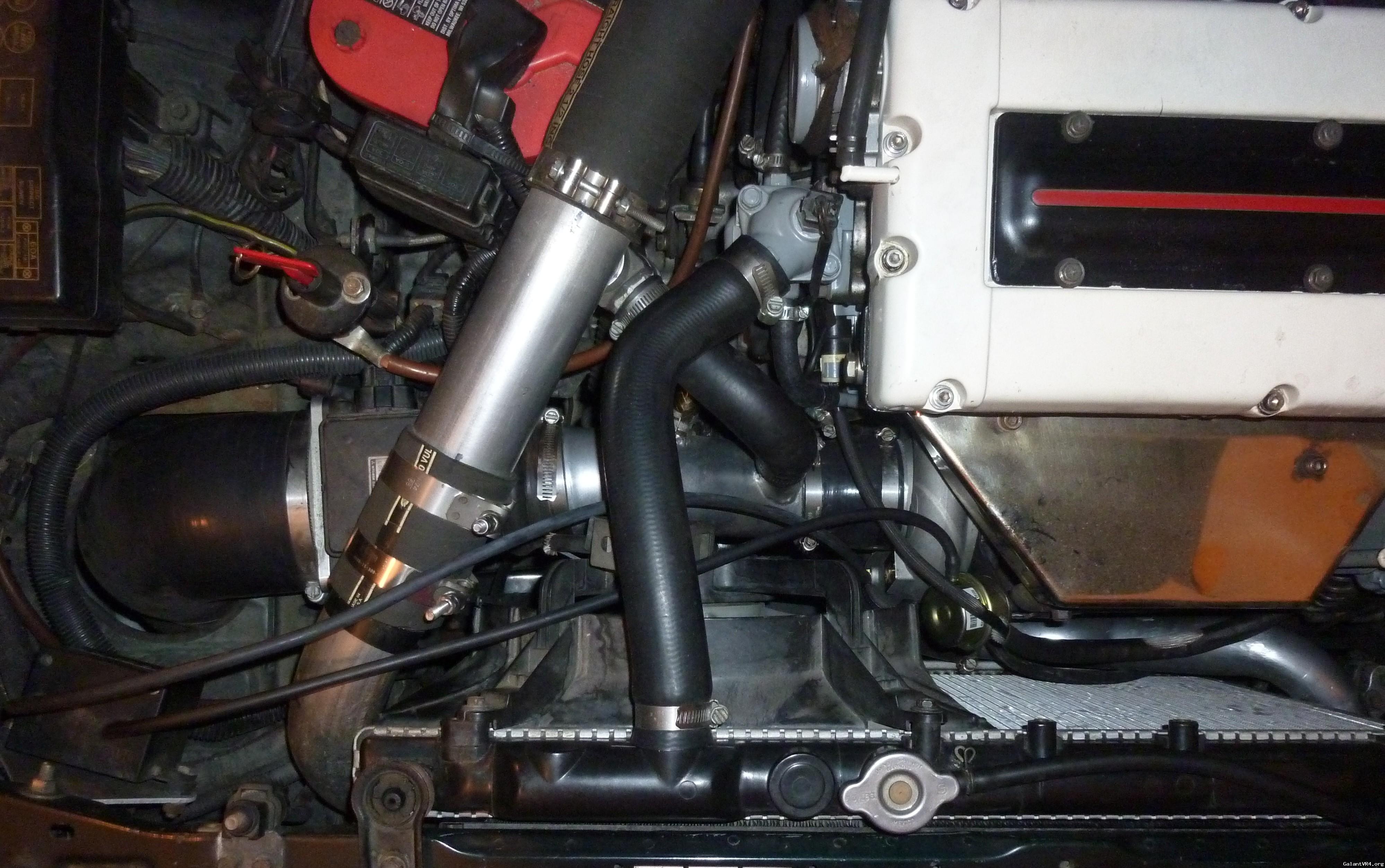

No confusion. It's in, clocked comp cover, internal gate with modded actuator bracket, mounted like a 20g, stock fan and 3" intake. I may go for a drive tonight. Thanks for the replies.

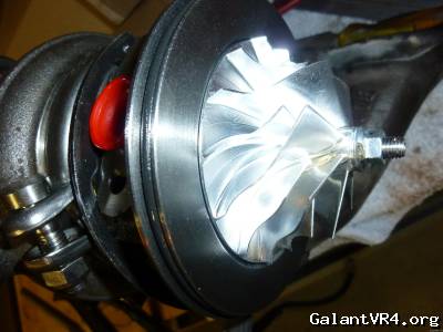

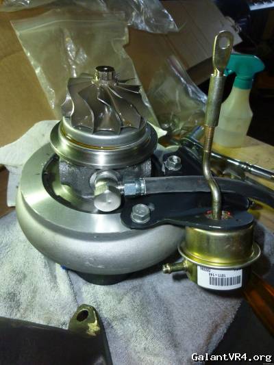

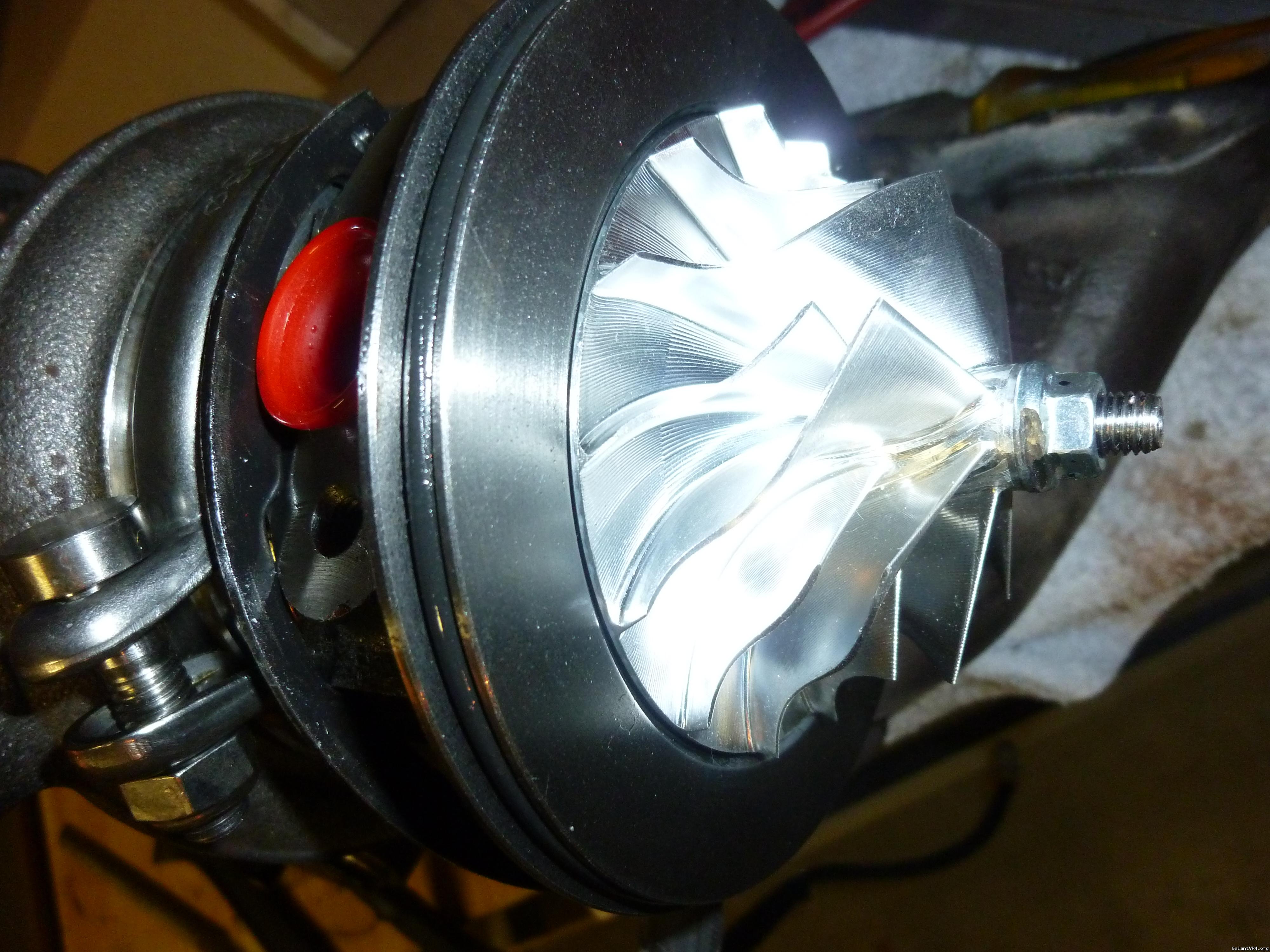

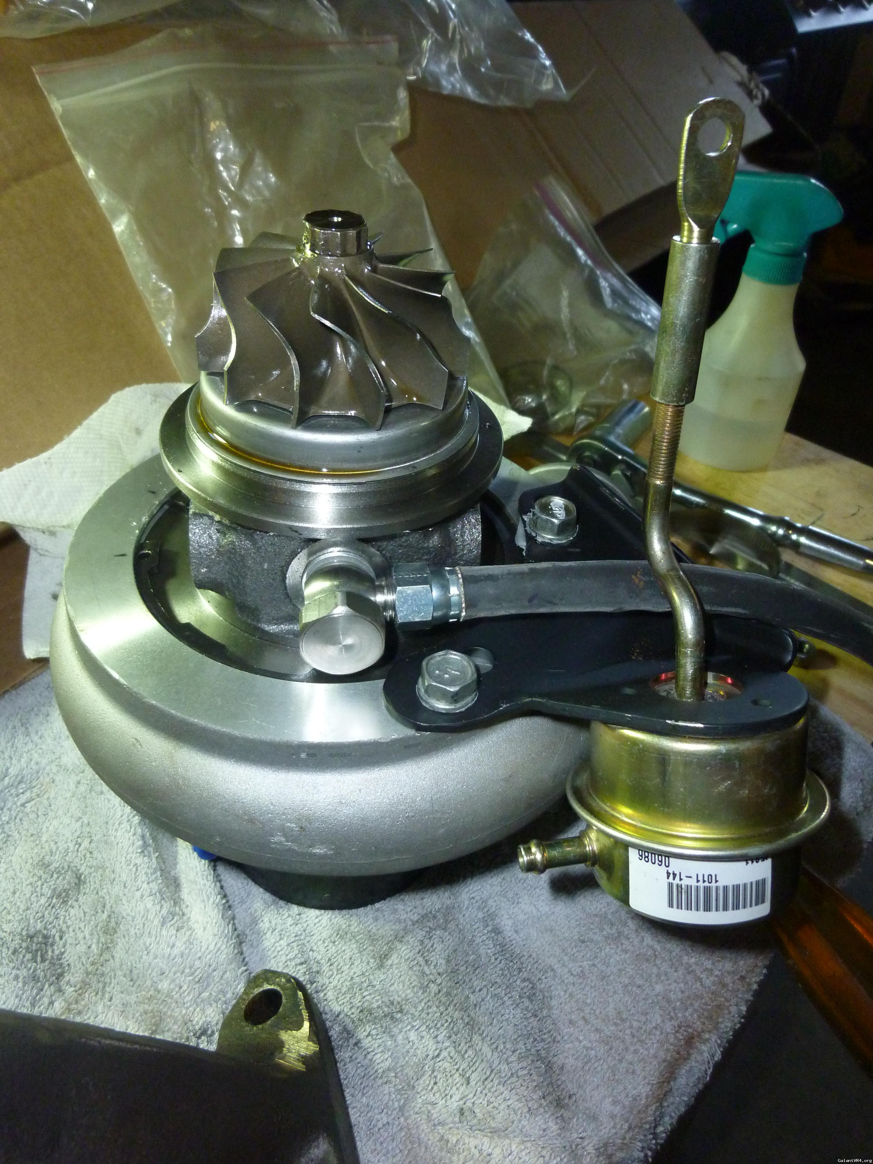

I don't have any pics of the competed install yet, but here are a few of the process:
I'm jealous of the 14 blade comp wheel. My Green is a few years old, granted barely used, but it only has a 12 blade version

The actuator came with the turbo. But FP could have sourced it from anywhere, including the same supplier that Holset uses.
I'll try to snap some pics of the finished product and post them today.

I cut a hole in the sheet metal where the stock battery used to be and used a 4" 90* silicon elbow connected to a K&N filter in order to put the filter in front of the plastic fender liner for a cold air intake.
