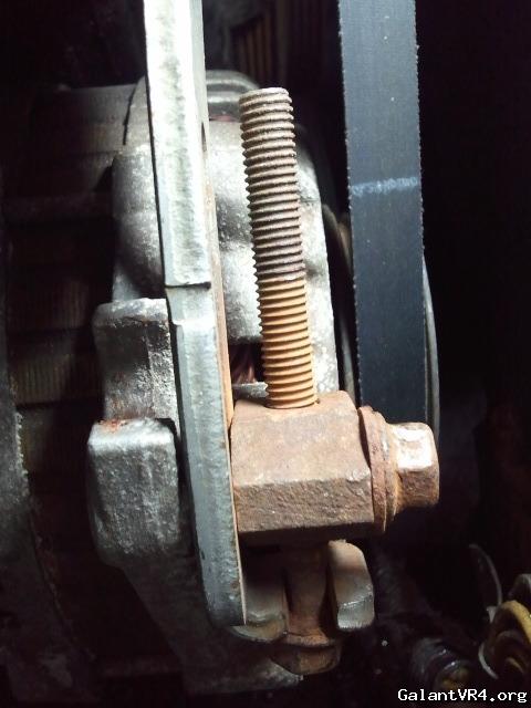

Alright this is what doofy me is doing. /ubbthreads/images/graemlins/grin.gif
It seems that per your instructions I have the small block on the wrong side (I am famous for this on any vehicle).
The long bolt I just don't get how that works though.
Also, which is the set bolt and the adjust bolt? I am looking at the manual and it doesn't show which is which.
Is I am guessing that the adjuster bolt is the long one?

The un-threaded portion near the head of the long bolt sits in the notch in the end of the alternator bracket - you'll need to lift the alternator (pivot it about it's lower mount) to fit the belt, and get that bolt into it's notch.
The bolt that goes through the block into the alternator needs to be screwed in until it is juuuust loose, so it holds the block in the correct alignment, but doesn't stop the block moving along the bracket as you tighten the long bolt to tension the belt.
Hope that helps.
yes, you do. It is probably sitting weird because there is no belt on there. As soon as you get a belt on the alternator it will move up and that longer bolt will get pulled up against the alternator bracket, and then it will actually do some adjusting.
also, i was wrong about the set bolt going through the alternator first. It goes through the block first, then the bracket, then into the alternator. Sorry for the confusion I caused.

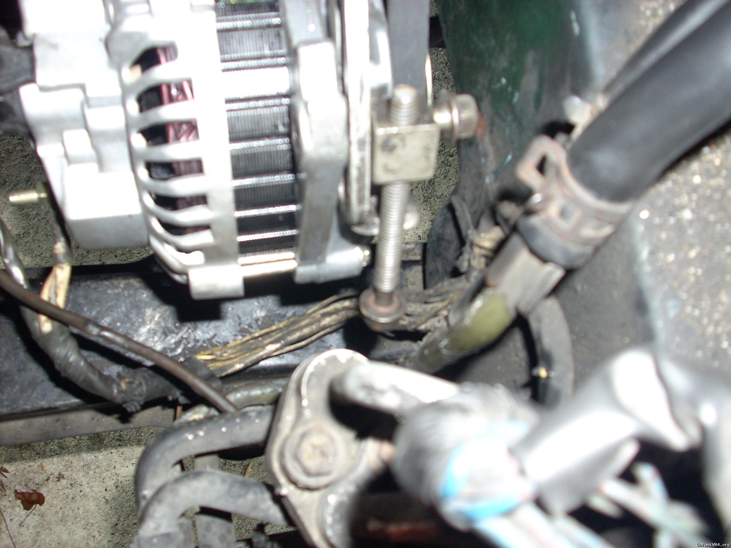

still being a slight headache to me...gave it a try to tighten it up a bit more but still scared i might be overtightening it and putting stress elsewhere. I warmed up the motor first, before re-tightening the bolt. This is where it ended up:

i personally go to the store with my current belt and size it up. i use a dif belt on my alt. go to the store and have them look up the stock belt length, the take like 1/4" off the length and use what ever belt is there. if you still dont like it keep going back and returning the belt till you find the one you want. last time i did it i tried 3 or 4 dif belts, right there in the parking lot till i was happy.
edit: for checking tension find the longest section of belt, grab it in the middle with your thumb and index and try to flip the belt over. it should go anywhere from 1/8 to 1/4 of a turn, if it turns more then that keep tightening.
after reading that i can imagine it might be a little hard to understand, if so let me know and i will go take a picture of my belt to show you.
